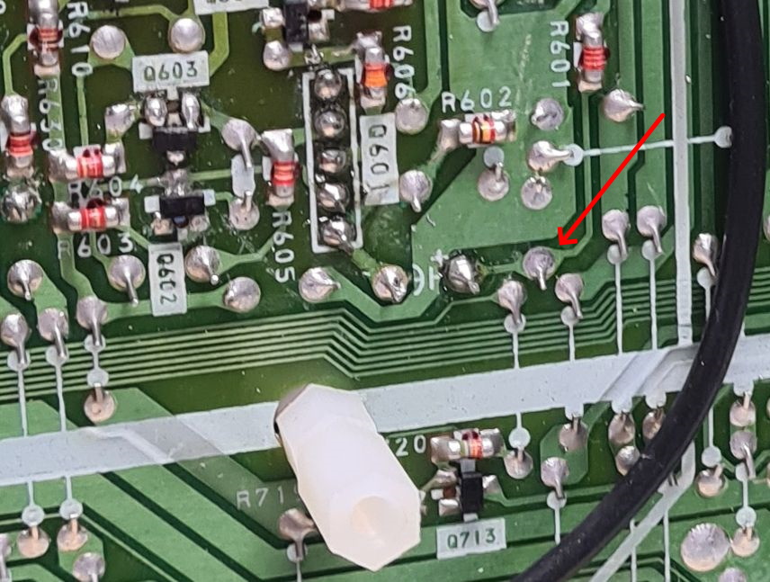

The black lead and soldering does look original and also seems to follow the white line on the PCB. I'd say that is OK.

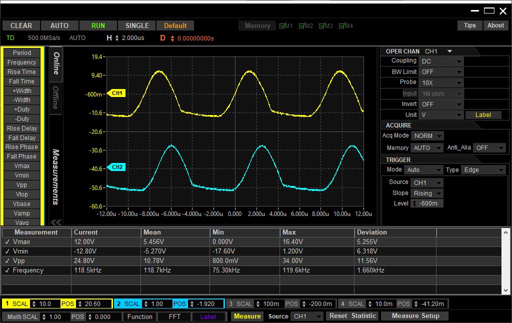

The scope shot I'll say does look like noise but with some regular spike of something which is possibly just a measurement effect of the way it is all connected, the grounds and so on of the test set up.
IC801 is a 5v reg on the diagram, so should have a clean 5 volts coming out of it.
As to the main problem, I really don't know what to suggest tbh... well actually one more idea... instead of linking the 0.22 ohm to the emitter of the driver transistor directly lets try it via a low value resistor such as 100 ohm. Just hazy thinking that the stage might oscillate with capacitive loading on it and the resistor would isolate it from that. Beyond that... I really don't know.
your eyes are better than mine 😀
Is it the one pointed to by red arrow?
T

yellow is Q510. Interesting, now +-12V
R519 +4.6V, R619 +4.76V Q510->Q511, and Q610 to Q611

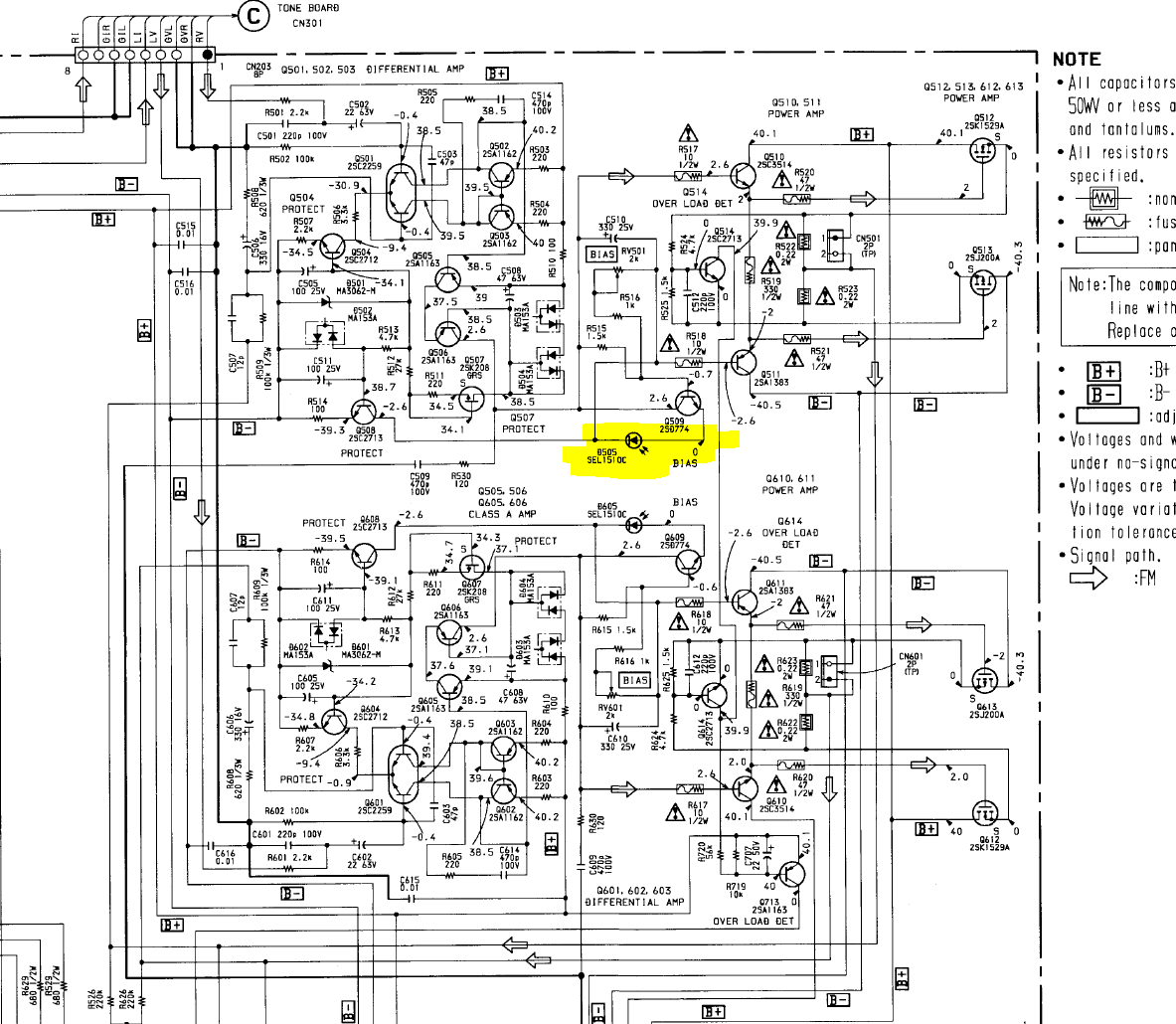

Q504 looks to be used as another current source. Base is fixed by the Zener and the current is effectively the Zener voltage less 0.6V divided by R507.
It is a critical part... and I wonder why they call everything 'protect'.
Well, I can't read that actually was a D504
, so red herring. So, putting glasses back on I went hunting once more.
Hurrah, or not really. D505 is around the wrong way!
It’s a SEL1501C. Lesson to be learned here, what's been changed if anything. I ASSUMED that the red and green LEDS D505 and D605 were different colours to help distinguish between the channels, silly me. Both are SEL1501C.I think they are non-tinted green with a Vf of 2v.
Red tinted one (D605) was 1.96v and around the right way, clear one was suspect at 7.6V!. Anyway I' replaced both with a Square green LED at 1.96V Vf. and lo and behold both channel voltages behave the same without MOSFETS.

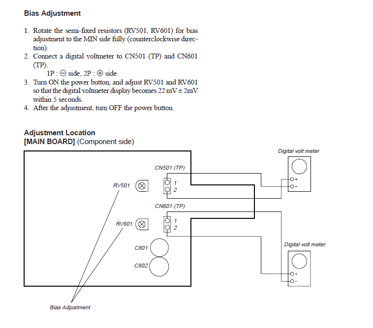

The forward voltage will determine the current in that chain and so to the bias voltage developed... so first check is to see if the bias current preset adjusts correctly by monitoring the voltage across the appropriate 0.22 ohm. The manual should say what the correct figure is.
Of course the truth is I'm almost at the start with this amplifier. Turned both Bias trimmers to minimum. I was under the impression that once the Bias was set it was steady.
Channel "6" nothing for a while, and once you turn it around so above 15mV it comes to a point that it just keeps going.
Channel "5" never goes above 4mV.
So question is should it be a steady 20mV, or aim for 20mV within 5 seconds and doesn't matter that it keeps going.
Also the 0.22ohm resistors seem to be more like 0.33 ohms...
Firstly you might find that an inability for the bias trimmer to reach the value needed could be down to different replacement semiconductor tolerances. Things like that current sink (the LED) will have a big impact if the current in that chain is even a little different.
Also different devices and transistor types can have slightly different turn on voltages.
As to the current not being stable... well that comes down to the design and how the bias generator senses temperature. It might keep going up for a while and then as the heat stabilises the current levels off and starts to fall again I'm afraid its an unknown (to me) what would be normal for it.
If any channels are original in all respects then use those as a guide to see what happens.
What you must ensure is that thermal runaway does not occur and that the current is reasonable even the amp is really hot.
"So question is should it be a steady 20mV, or aim for 20mV within 5 seconds and doesn't matter that it keeps going"
So is the bias voltage rising a sign of thermal runaway?
We are measuring voltage across a 0.22ohm resistor, so 20mV would give 0.1A. That doesn't seem large to me... was going up quite quickly tho
Thermal runaway generally means it keeps increasing continually to damaging levels.
Poor thermal design means it increases until thermal equilibrium is reached. It may rise initially as the output devices heat and then start to fall back as the bias generator also warms and reduces the bias voltage. In most amps TR5/614 would be in contact with the heatsink to sense the temperature.
You will have to just see what happens. If it gets to 40mv then that is nearly 200 milliamps flowing... which is not that high in the scheme of things but high enough to heat things up. It is about 8 watts per output transistor.
If it gets that high and then falls back then that is fine. If it keeps going then that isn't good.
