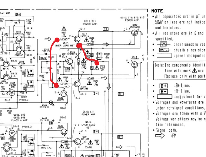

Ok Fets in, but with Bases of Q510/Q5511 joined, I get -0.8V across R519.With the FET's out of circuit and the driver transistor base's linked you should have no voltage developed across what looks like R519 (330ohm). If you have voltage across that resistor then you have a driver fault.
The feedback loop looks like it will be open circuit with the FET's out so that will cause the voltage on R519 to swing toward a rail but the voltage across the resistor should always be zero.
If you have no voltage across the resistor in that state then there could be an issue with the FET's.

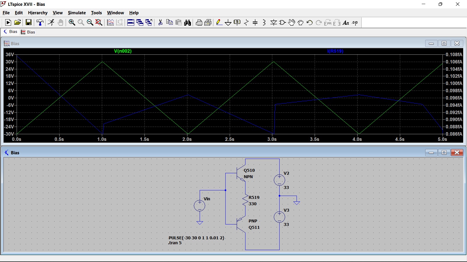

Look at this below. The base of the drivers are linked and supplied with a voltage that goes from -30 to +30 volt. The current in R519 is shown (right hand scale) and is essentially zero (femto amps) meaning zero volts across the resistor. Providing nothing is pulling current from the emitters to somewhere else then the current (and so voltage across the resistor) has to be zero.
So at this point the -0.8 volt across the resistor that you are seeing is not what I would expect.
Just out of interest is the voltage on the linked base's higher or lower than the supply to their collectors. It should not be because the circuit simply show B+ and B- as being the only rails involved but the diagram is so hard to trace that it is worth checking.

Those readings seem to still show a problem around the driver stage.
Electrically it should now look like this (attached). It doesn't matter which end of the resistors going to the driver base's you linked.
So both base's are electrically linked and so are at the same voltage. That means no current can flow in R519/619 and yet you have 2.7 and 3.6 volts.
The only 'load' being driven in this state is the feedback network and the resistive feed to the DC offset protection and both these are high value resistors drawing minimal current.
So the question is why have you got these voltages across R519/619.
If the transistors are good then we have to now suspect that the circuit is actually oscillating at some very high frequency (which would cause cross conduction in the drivers) but the only way to prove that is with a good oscilloscope of wide bandwidth to see what is there.
The theory as far as I can see is sound up to this point... no current (and hence no voltage) should be flowing in or across those resistors with the driver base's linked.

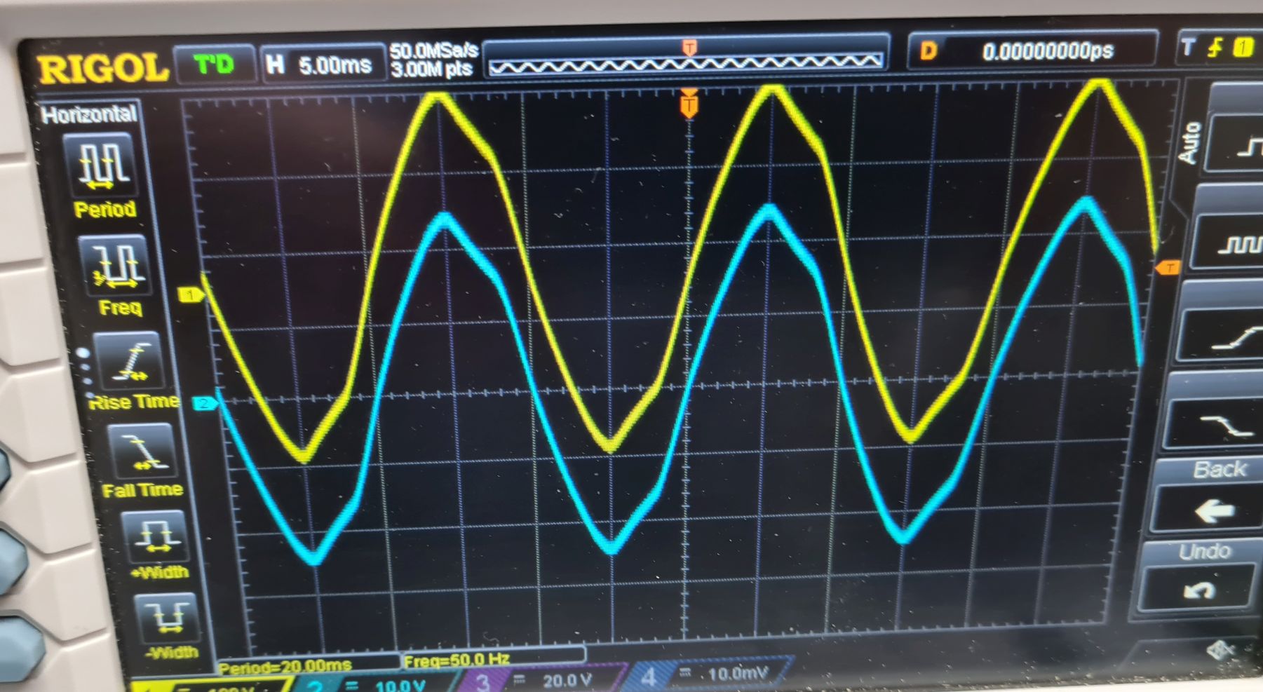

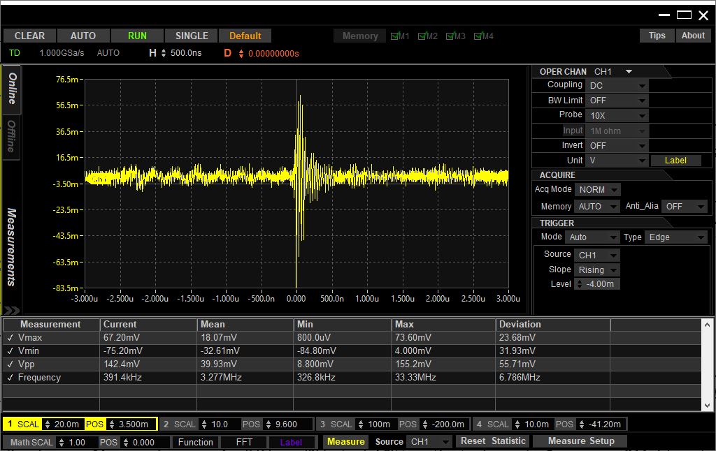

The scope seems to show just 50Hz from somewhere. What is the peak to peak amplitude on those?
5ms/div so 20ms per cycle is 50Hz. There is no sign of oscillation on that trace and 50Hz of any amplitude would not cause cross conduction, its way to slow.
I'm assuming those traces are measured from ground to each base. You can not connect a grounded scope probe (again I assume the scope is mains grounded like the amp) across a resistor because a short will be created via the scope lead and the mains lead grounds.

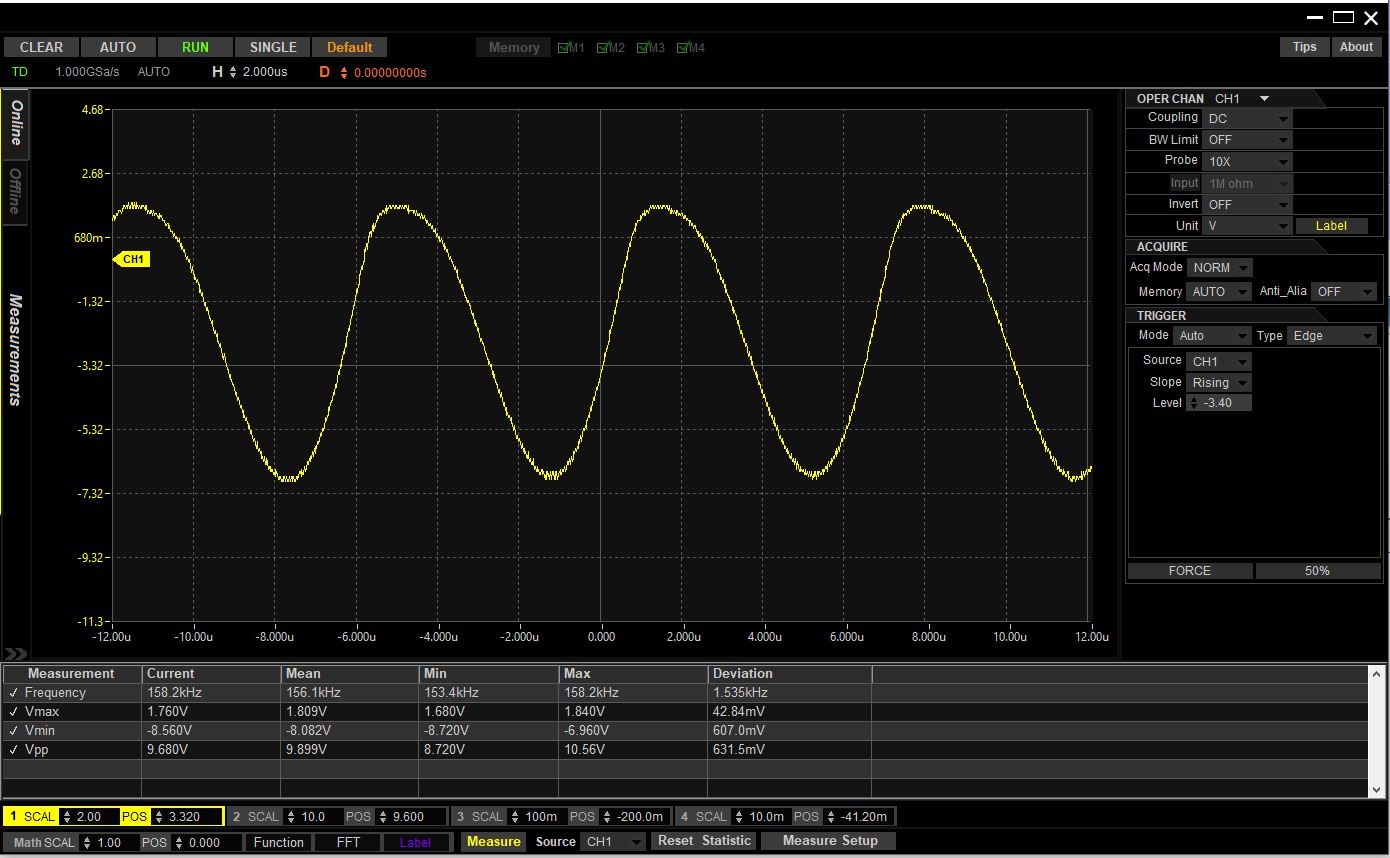

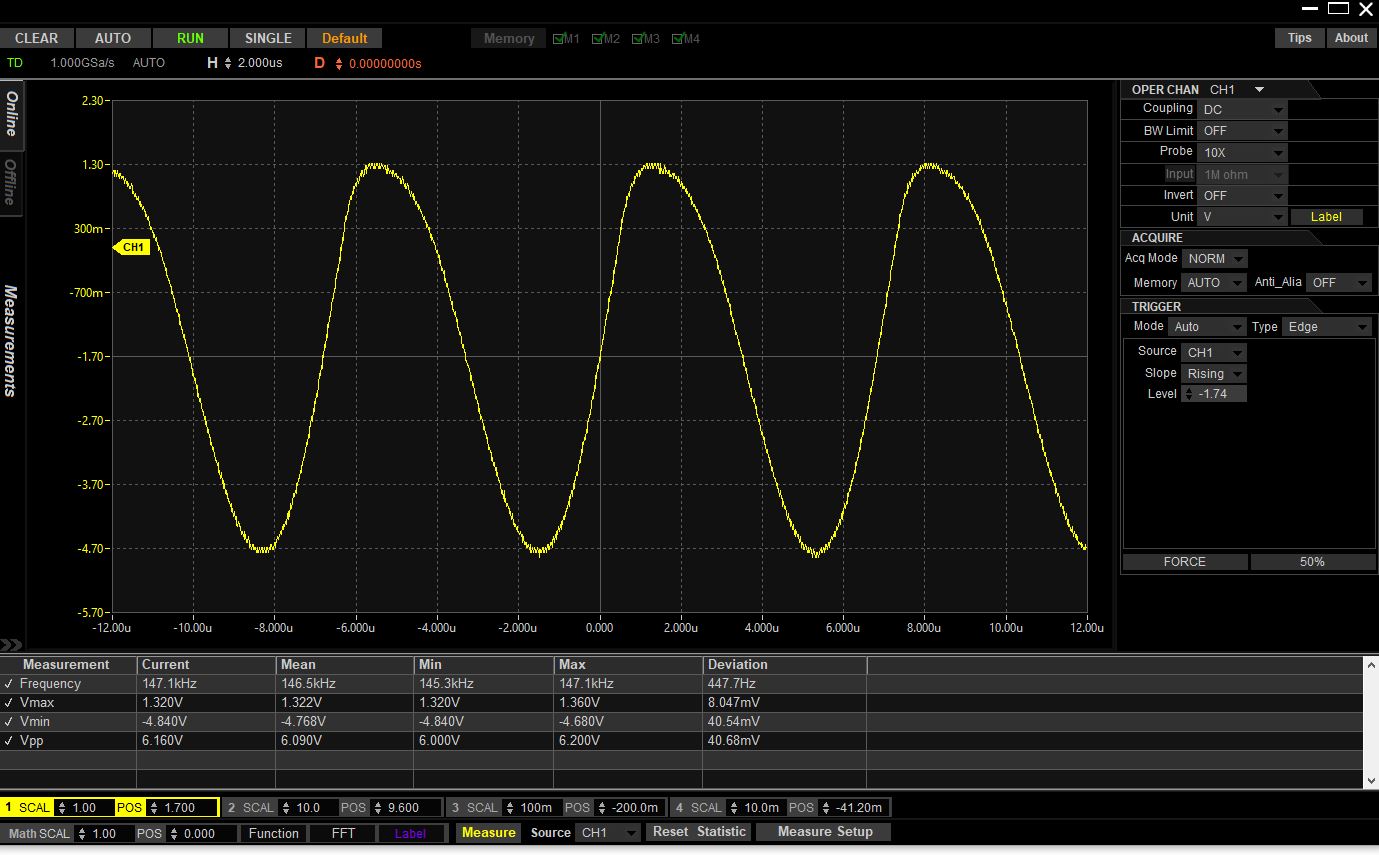

, thought sony was earthed... Occiloscope on same mains, but doesn't help if sony not earthered ! duh! so was showing mains, which in itself is interesting.... hate scopes
anyway how about now that probe earthered...
146kHz, peak to peak some 6V, between +1.3 to -4.7v

Right then... so 146kHz at the kind of amplitude you see here does show it is oscillating and that would cause the kind of effects you are seeing such as voltage over the 330 ohm.
Hmm... that is strange.

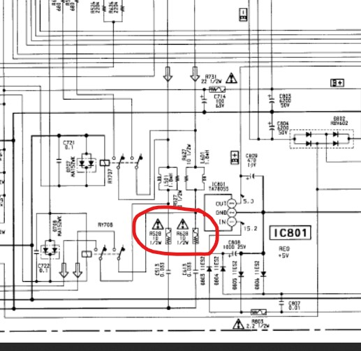

Are these two safety resistors OK? They form the Zobel network and are essential for stability. Check those first. If they are OK then we are struggling. Lets check those first though.

I think you should also look with the scope at the input to the power amp just to make sure nothing is entering via that route. The connector at the top of the diagram where it is marked RV and LV. There should be no signal (that HF you measured) at those points.

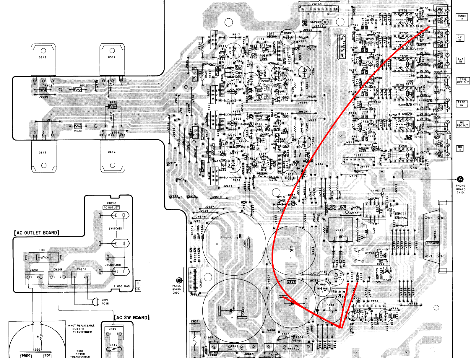

now i look at it IC801 looks like its been changed, and the black cabling on the underside looks iffy. Sounds like this may be a lost cause. BUT interesting (for me) I'll track where I think they are goin and send you a photo
in the meantime RV and LV plots....Is that just noise?

I assumed this was done at the factory, silly me...mainly because tape seemed to be same as that holding capacitators togeather.
I'll confirm tomorrow where it ends up at the top, hard to see.
