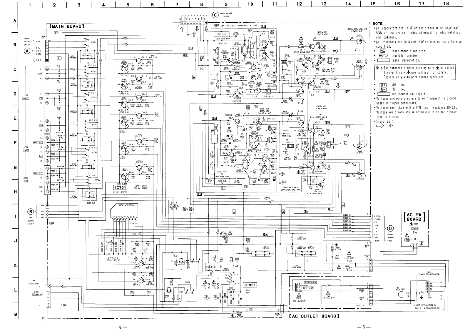

IC801 is a 5v reg on the diagram, so should have a clean 5 volts coming out of it.

yellow is Q510. Interesting, now +-12V
R519 +4.6V, R619 +4.76V Q510->Q511, and Q610 to Q611

Well, I can't read that actually was a D504
, so red herring. So, putting glasses back on I went hunting once more.
Hurrah, or not really. D505 is around the wrong way!
It’s a SEL1501C. Lesson to be learned here, what's been changed if anything. I ASSUMED that the red and green LEDS D505 and D605 were different colours to help distinguish between the channels, silly me. Both are SEL1501C.I think they are non-tinted green with a Vf of 2v.
Red tinted one (D605) was 1.96v and around the right way, clear one was suspect at 7.6V!. Anyway I' replaced both with a Square green LED at 1.96V Vf. and lo and behold both channel voltages behave the same without MOSFETS.
Short Emitter of Q510 & Q610 to Bias connector between both 0.22ohm resistors. Both channels behave roughly the same. Put MOSFETS back into "6" channel and voltages back to where they should be!.

Well done finding that reverse diode
The forward voltage will determine the current in that chain and so to the bias voltage developed... so first check is to see if the bias current preset adjusts correctly by monitoring the voltage across the appropriate 0.22 ohm. The manual should say what the correct figure is.
