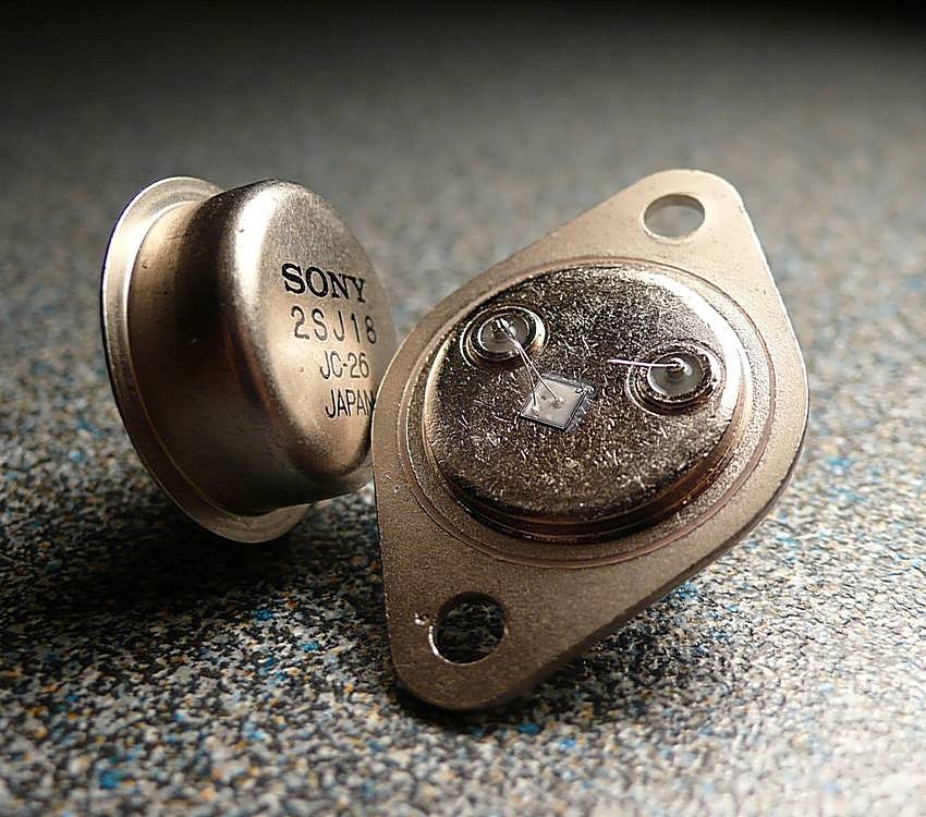

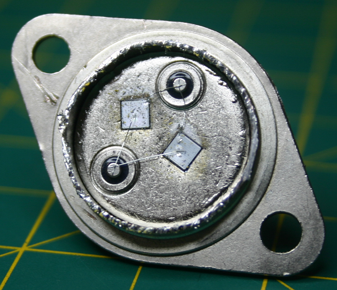

If they are real, then I think you can use them, keeping in mind that they
have a lower power and current rating, and about half the transconductance.
It might be that the 2SJ29 and 2SK82 are the same chip but two to a case,
it's hard to tell.
it's hard to tell.
I remember Mr Rothacher made this photo of 2SK82 opened Thanks a lot
and other 2SJ18 is find on web enjoy !
