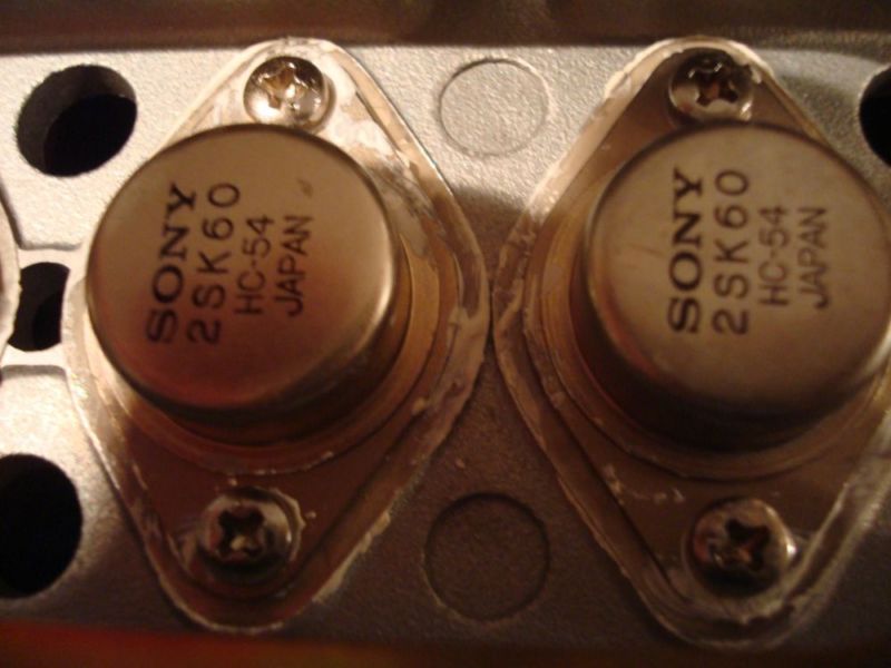

Chinese parts: BUYER BEWARE!!! The newest fad is to sell you exactly what you want, by stripping the original markings and stamping (or most likely inkjet-printing) the ones you wanted. Becasue VFETs are easy to check for, you will likely get VFETs but not the rank and oftennot even the type you think you got. Usually it's J18/K60, rank 1 or 2, relabelled. China sourced K82 are currently all re-labelled K60, rank 1 or 2.

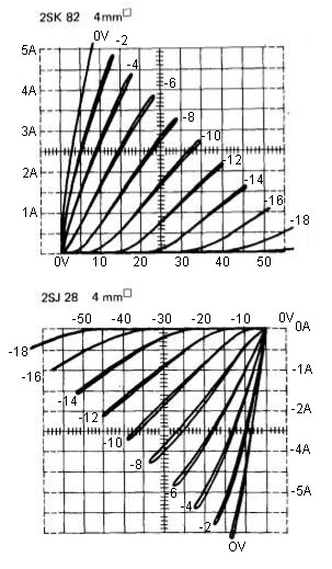

Thanks for the detailed information. The 2SK82 and 2SJ28 that I obtained
from circuitdiy.com are labeled as KE33. They also have some inventory of
KF33 for the 2SJ28.
I did not perform tests at 100mA and 50V as this spot is not close to my
intended use. I tested for Vgs at 20V Vds at 0.5A and 1.0A Ids.
The result is that all the parts conform roughly to the attached curve trace,
the average being around 8V Vgs at 1 amp for the 2SK82 and 10V for the
2SJ28. There is a decent population of parts near the average so that it is
not difficult to get matches, but you will see parts spread out by a volt or
so. Under these conditions, a difference of 1 volt Vgs would mean about
0.5A (about 50mA for each 0.1 difference).
If you are matching for parallel operation at these sorts of Class A currents
I recommend matching the parts, to 0.1V if feasible and 0.2V would be an
acceptable figure. If you are using these parts in parallel, get some extras.
If not, no worry (but test them anyway).

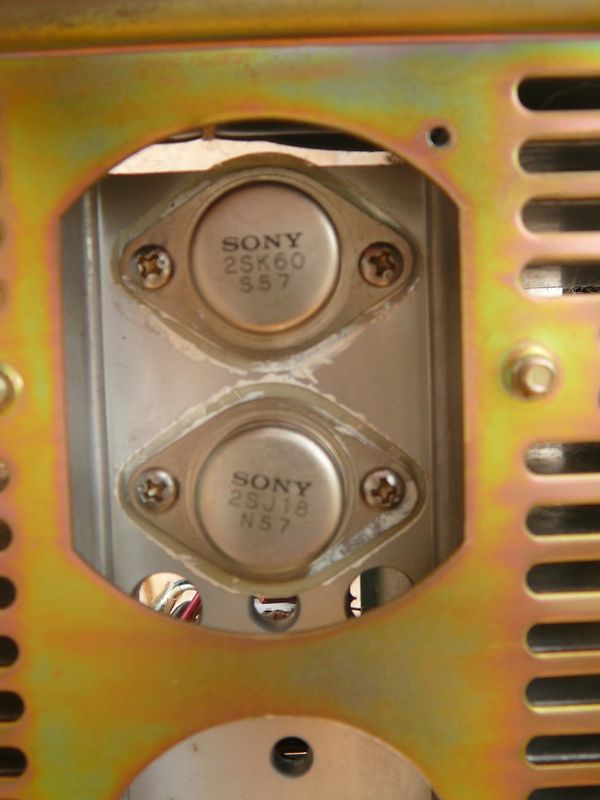

Regarding the fads: are they really relabelling old VFETs to look like other old VFETs? J18/K60 relabelled to J28/K82. Fantastic, I believed it was more or less just any old TO3 that was relabelled. Is this caused by Nelson Pass' adventures with J28/K82 then?!
Yes, they are really genuine Sony VFETs (initially, of course, there was all sorts of fakery but since VFETs measure rather uniquely even by a simple DMM, this is rare these days, plus Sony used a slightly distinctive TO-3 style case).
In one case, I actually got recycled ones that had the nickel stripped off, the whole case was then re-tinned and new markings stamped on, so it's a uniform but dull silver color. And - amazingly - these are good genuine J18/K60. I've also had a mixed batch of J28/K82 that turned out to be single chip J28, double chip J28 and genuine K60 re-labelled as K82.
The most common 'fake' are re-labelled rank 1 and 2 devices. These have rather different characteristics and were never used in production, but there are indications that they were offered in their day to DIY-ers in Japan.
Other types were available as well, most notably Yamaha. However, these seem all to come from the same source, and about 25% of the P-ch parts don't work while only about 25% of the N-ch parts work. The rest are fried, probably by some 'genius' attempting to 'test' them on a curve tracer set up for BJTs. VFETs have a rather unique failure mode (they are actually incredibly robust) to do with positive G-S and gate current. When this is over spec, the VFET will deteriorate - the G-channel 'diode' breakdown voltage will reduce to a point where G-D breakdown will occur long before D-S breakdown, and also mu will lower and Idss will lower. It will still look like a triode on a tracer. If the gate current becomes very high very quickly, the pin to chip bond wire will go open like a fuse, while the actual chip will survive! This is the most common mode of failure in Sony gen. 1 VFET amps that still have functioning bias supplies. In any case all of the failed Yamaha parts that still had an intact bond to the chip had this tell-tale failure, which was probably the result of trying to drive the gate as if it were the base of a BJT.
