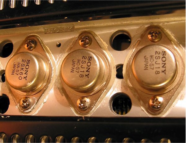

I have sources of 2sk60 jF-34 2sJ18 JG-24 they are originals and the sellers says he has still around 50 pairs comes from a japanese supplier before....
My question is are they really match pair?

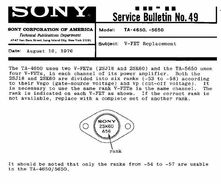

As per DiyAudio member, the rank number is only the last digit and the other including sub letters are batch number etc... In this case the rank is 4.
Looking at the attached datasheet...they are rank from 2 to 8 if i'm not mistaken.
Junm;3817560As per DiyAudio member said:Acronman has been referring to the letter of the rank designation in their
offerings, for example I have been purchasing "E" designations.
This does give rise to some confusion which I think will be resolved shortly.
On the other hand, I am simply testing each part, and so should you. I heat
sink them and run them at 20 Vds and determine which Vgs value gives me
0.5 and 1.0 amp Ids.
So far for parallel operation I have been using values within 0.1 Vgs, and
they behave gracefully. Probably you could expand that tolerance to 0.2 V
or even higher without problems.
The only parallel case so far has been the big Sony VFET commemoratives,
the other examples being just single pairs of P and N which do not require
Vgs matching.
