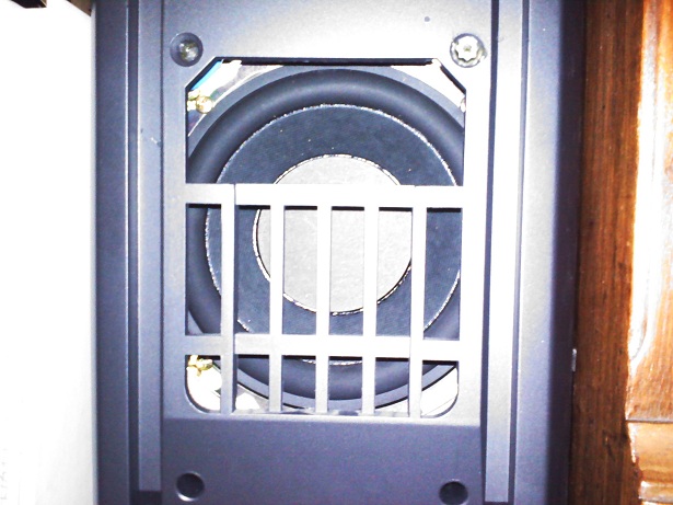

Alright, I got the front grille off pretty easily (I pried just a little at each side of the grille, and it came off neatly), and I took out the two screws, but I don't see how to get off that plastic cover without completely destroying it. Even though I took out the two screws, it's still in there very tightly. How did you get that plastic piece off?

That looks like a dual reflex bandpass box. The plastic cover forms the front chamber. The square holes in front of the woofer is the front port. Sony can't call it a BP2 box because of Bose. That's why they call it a Super Acoustic Woofer.
"Dual reflex bandpass box"
6th order bandpass springs to mind. The Subwoofer DIY Page - 6th Order Bandpass Systems
The small plastic grid in front of the driver does not count as a port. It's more for driver protection from physical damage. It's a standard vented box.

1/3 of the cover is restricting radiation. Look how far out the grill is from the woofer. If the enclosure was a standard vented box, then the grilll would be simple like on my Sony HTCT100.
Think of the SAW having a shallow front port and very long rear port. BP2's can have a 1 to 5 front & rear chamber ratio.

I'd accept it as a slot-loaded driver, although the slot area to Sd ratio isn't enough to cause any major change to the airflow. Therefore, I still stand by it being a standard vented box. A small plastic grid does not constitute a port.
1/3 of the driver appears to be restricted. A head-on photo would show that much less than that has restricted airflow.

Here's a head on picture.
The Grille is Simply to Protect the Woofer...and make the Box Look a
little Nicer.....it doesnt Contribute anything Signifigant to be a Part of the Enclosure...once Again...this is Simply a Bass Reflex (Vented) Box.

Yeah, I doubt I'd ever replace the amp on the unit. How did you get that grille off though?
i Simply Pried it off with a Phillips Flathead Screwdriver....since the Pegs on the Grille that Fit into the Holes on the Plastic Front Panel are Glued in some Pegs will Loosen up...others Broke.
i Pried the Plastic Front Panel off too....it also had Pegs Molded into the Plastic...these Pegs Fit into Recessed Holes Drilled in the Particle Board...also held in by some sort of Glue....Prying once Again loosened some Pegs and Broke Others....Try not to Pry too Hard as the Panel could Crack..or break all the Pegs off....if you Break only a Few its Alright.
