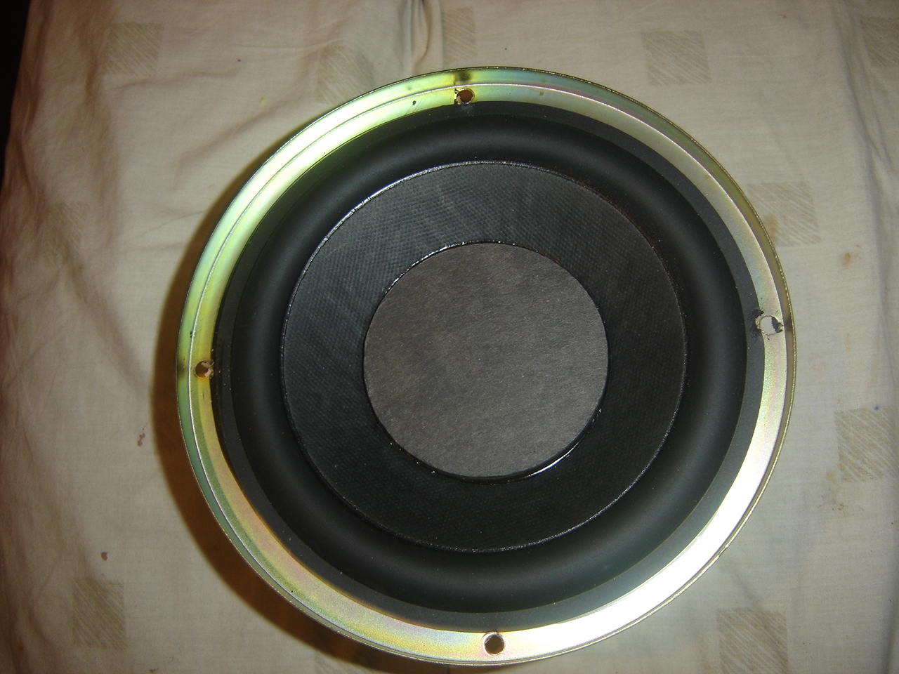

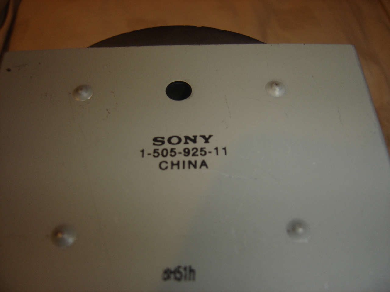

and ladies and gentlemen!...finally being able to get the Front off...the 6.5" woofer hiding behind the Grille is Revealed....the Construction isnt too bad,Nice Paper Cone and Dustcap with an Equally Nice Rubber Surround..the Frame seems very Sturdy...but what is up with that Shielding?!..hasnt sony heard of Sheilding Cups?!
Apart from the shielding, that one looks similar to the one I messed with.

Well...with a Decent Enough Power from the Amp...i might make a New Box and use a Higher Excursion Driver,and use the Original Driver for something Else.
YouTube - Sony 6 5 Bass I Love you 006
you can see a Video of it at Full Excursion in the Above link.
