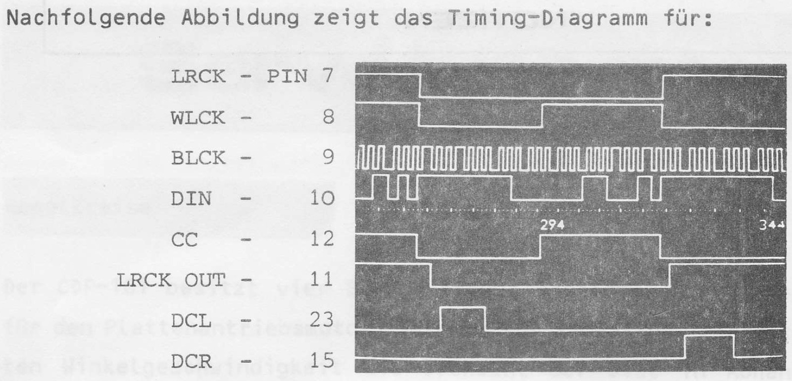

I think the I2S of the Sony CDP-101 is not the same as today's I2S, but I might be wrong. Looking at the Audiophonic board's description, MCK of the I2S needs 11.2896Mhz. This very likely would need to run in sync with the CDP-101, what this thread is about.
Maybe this 1983 document sheds some light? Translated from the German CDP-101 tutorial for Sony engineers, see link in post #29, page 87:
"The data offered to the CX-20017 (NOS DA-Converter from Sony) is a serial digital signaI in two's complement form. The data is synchronised with the rising edge of the bit clock (BLCK), starting at the MSB. The data change occurs at the falling edge of the BCLK! At the 24th falling edge of the BCLK, the word clock (WLCK) goes from high to low and the 16-bit data is transferred from the shift register to the signal memory (latch) (internal process)."
BCLK is very strange looking. Seems to invert phase every few cycles.

Could it be that it follows the Wordclock of 88.2khz?BCLK is very strange looking. Seems to invert phase every few cycles.

Looks like they didn't call it I2S back then.

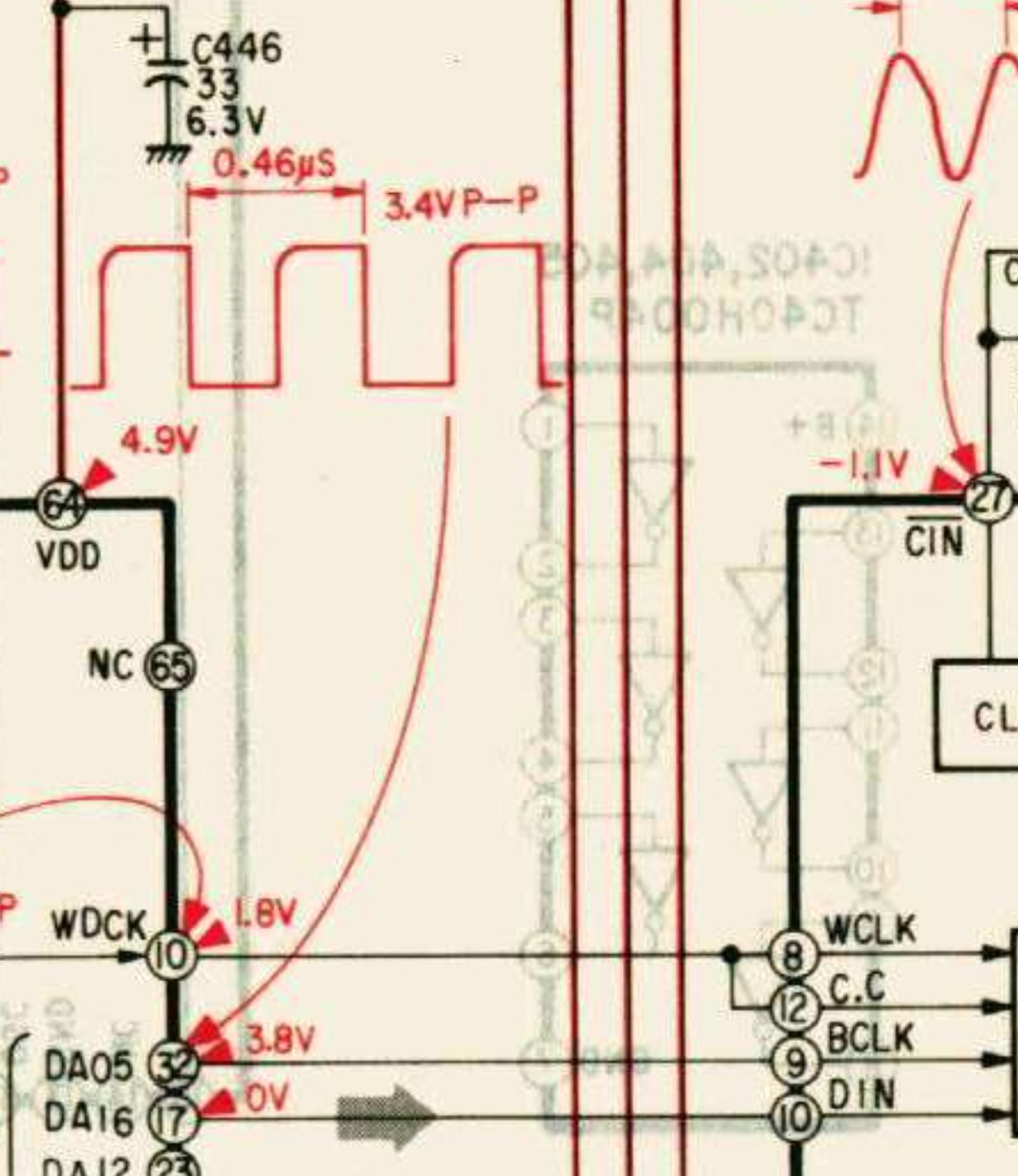

Do you mean new related to an early Sony CD-Player from the time range 1982 to 1986 or new in general?BCLK inversion pattern is new to me. Maybe someone else knows about it.
Could it also be that the inversion / irregular bitclock pattern is an error of the authors?
Because in the CDP-101 service manual the bitclock @ DA05 is shown as a regular signal.
I also remember that I did see it that way as well on my scope but need to verify.
