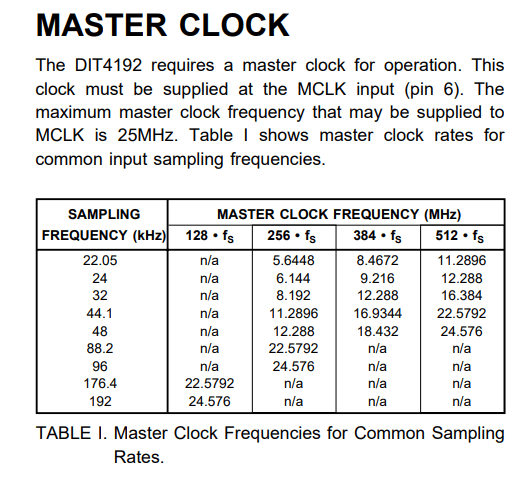

The DIT 4192 needs a standard 19.9344 mHz frequency.
Why? (BTW, that should be MHz for MegaHertz; mHz is for milliHertz).
DIT4192 Datasheet lists the clock frequencies it can use for a 44.1kHz sample rate:
Moreover, you could use a different part, such as AK4137, if you don't want to use a master clock (although SQ tends to be better with a crystal clock as opposed to using a PLL).

Dear Markw4, I would propose to you not to hijack this thread to expose your own beliefs but give answers according to the subject clearly stated in the thread’s title. I have a frequency counter and there are some candidates in the circuitry to check. As there is an on Chip PLL next to the 8.6mhz xtal, I assume the 4.2336mhz are produced there. I do not have the service manual in front of me for the moment.
