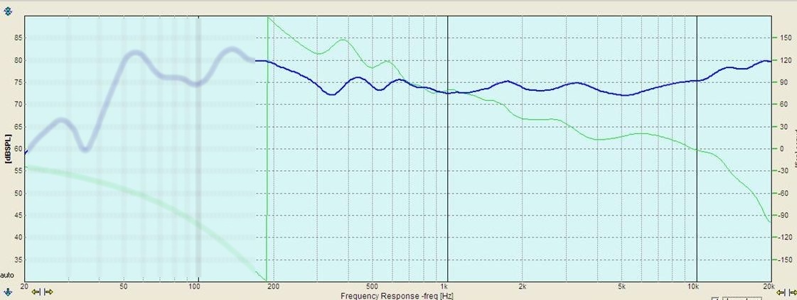

The Sonus Faber Extrema has the STOOPIDIST crossover I have ever see. It burns half your amplifier power on a ridiculous resistor/inductor tweeter section. They call it "CAPACITORLESS", but I call it "BRAINLESS".
The circuit is along these lines:
Now you might think there is some audio voodoo magic in there, or at least be confused enough to give them the benefit of the doubt. But there isn't.
This circuit works exactly the same, without burning all your bass power in a resistor:
That is why Sonus have dropped this topology. It is plain daft. The speaker sounds good because it has good drive units and cabinet, the crossover was an embarrassing mistake. More graphs here if you want to follow it up:

I've been scratching my head over the AR-SXO crossover for months. This Sonus one seems to be along the same simplistic lines. John Kreskovsky is of the "older and wiser" opinion these days that series crossovers have no particular magic.
That's a bit sad, but in the case of the Sonus Faber Sine-Cap crossover, it is provably a very poor design. The capacitor equivalent appears to work identically, without the silly power consumption and need to protect the tweeter with a big bypass capacitor. Who better to test it but you?
You are then left merely with the tendency of these low order crossovers to fry the tweeter or at least drive it into distortion, and let breakup from the midbass unit through. They never are 6dB per octave in practise either. I was seeing something like 16dB per octave here.
FWIW, there is a very fine 2nd order design lurking in the Sonus Faber. Almost ruler flat.

🙂 We might be digressing a bit here. No doubt that first order has some nice qualities, but some weaknesses too. I can understand you are a bit cross about this, but the testable assertion I am making is that the capacitor circuit will work as well sonically, and better on power.
😉 Now if you'll excuse me, I must sign out. I have to remove a tank from my bass crossover which reduces cone breakup one way, and then increase the rolloff capacitor a tidge which does it another. You see, I do build stuff and listen to it.
