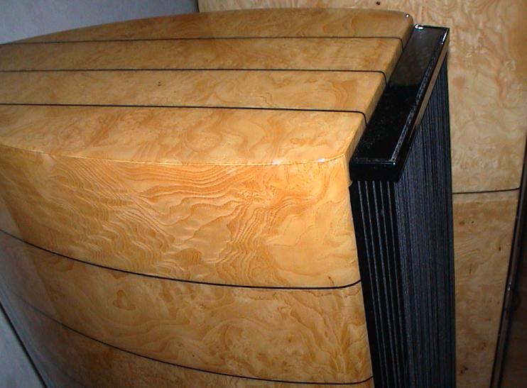

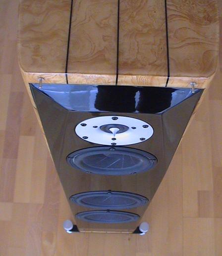

bfard - compliments, your speaker looks really good. Reviewing this and other threads suggest that there are actually not very many speakers out there
using this form factor. A lot of work !
My pair (2011) is not a clone but loosely follow the form............
dan998 -
tweeter is
Madisound Speaker Store
and woofer is an Aurasound 8 inch also from same supplier, I see they are no longer listed, (was a closeout driver)
Xover 2nd LR @650
tweeter is
Xover 2nd LR @650
