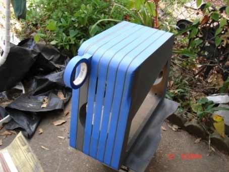

Sorry for the delay on my response! I was impacted by Hurricane IKE and lost part of my project, but I'm back working on the project. I used the photos of actual Extrema to realize the roundness of the side panels, I also wanted the curve to follow the curv on the leather front piece. I used a Tang Bang driver instead of the KEF, since they are hard to find, or the condition is not that great in the case of used ones.

One thing that worries me about the grooves - how are you going to get an air-tight cabinet? Maybe filling the grooves with a bit of silicon in the areas that will be covered by the drivers?

Yep, I'm planning to fill the grooves around the drivers, otherwise, this closed enclosure design will fail.
Besides Silicon, can you think of any other material? Silicon should do the job though.

Ideally the grooves would not have gone all the way to the driver cutout, or better still, the driver's were recessed.
Another option would be to use quite a thick gasket on your drivers and hope when it compresses it fully seals the grooves.
Hard to tell the depth and width of the grooves from the pics.

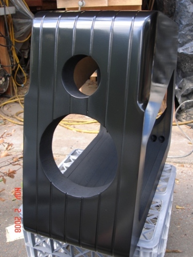

bfard said:This is the final coat of paint! I will have to polish and buff it.
Sweet ! you do have a lot of time on hand 😀
bfard said:I'm using the same type of paint Sonus Faber uses for the body! It's getting closer and closer.
what kind of paint is it ?

The only think i am perplex is the use of SS woofer instead of a flex units. Probabily you have saved a lot of money.......
