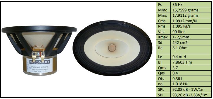

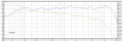

SWR300A
I think I have a kind person watching over me because I just received some information on the SWR300A which looks a lot better that what I recently posted regarding bass extension... i.e. it has potential to get down loooow
What is the technical difference between a wide range and a full range driver? The obvious answer for a neophyte like me is that it means that a wide range driver doesn't cover the entire frequency spectrum but looking at the graphs it seems to cover all it.

But if I understood correctly the SWR300 is only for bass reflex and it's not FR but wide range driver. Correct me if I'm wrong.
Well, according to their own data sheet (presumably normalised to 1m/w conditions although these are not specified) the SWR300 is good for about 15KHz or higher on-axis, which is pretty good for a whizzer cone ~11in driver.
Re 'only for bass reflex' -not so. It's fine for a back horn, QW or similar. It just doesn't need one.
There isn't one, as in, a technical difference. Personally I prefer the term wideband / wide range as a broad phrase rather than full range since all drivers without exception are BW limited -it's just a question of how much. 😉 You might find wideband / similar is sometimes used to describe those of slightly more limited range, but there's no fixed / formal limit as such.
