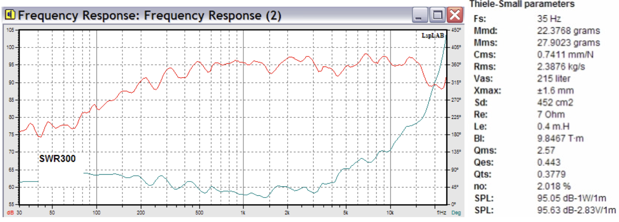

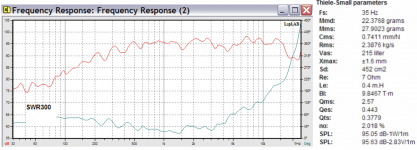

My main concern with full range drivers is shouty treble but from all accounts these drivers seem to elicit positive reports without any concerns. Given that the top end is good, that leaves the low end to worry about and here, as usual, big boxes are best and large drivers tend to do better overall. So I'd be looking at their largest full range driver, the 300, which to my eyes shows bass response that would benefit from a horn loaded approach.
