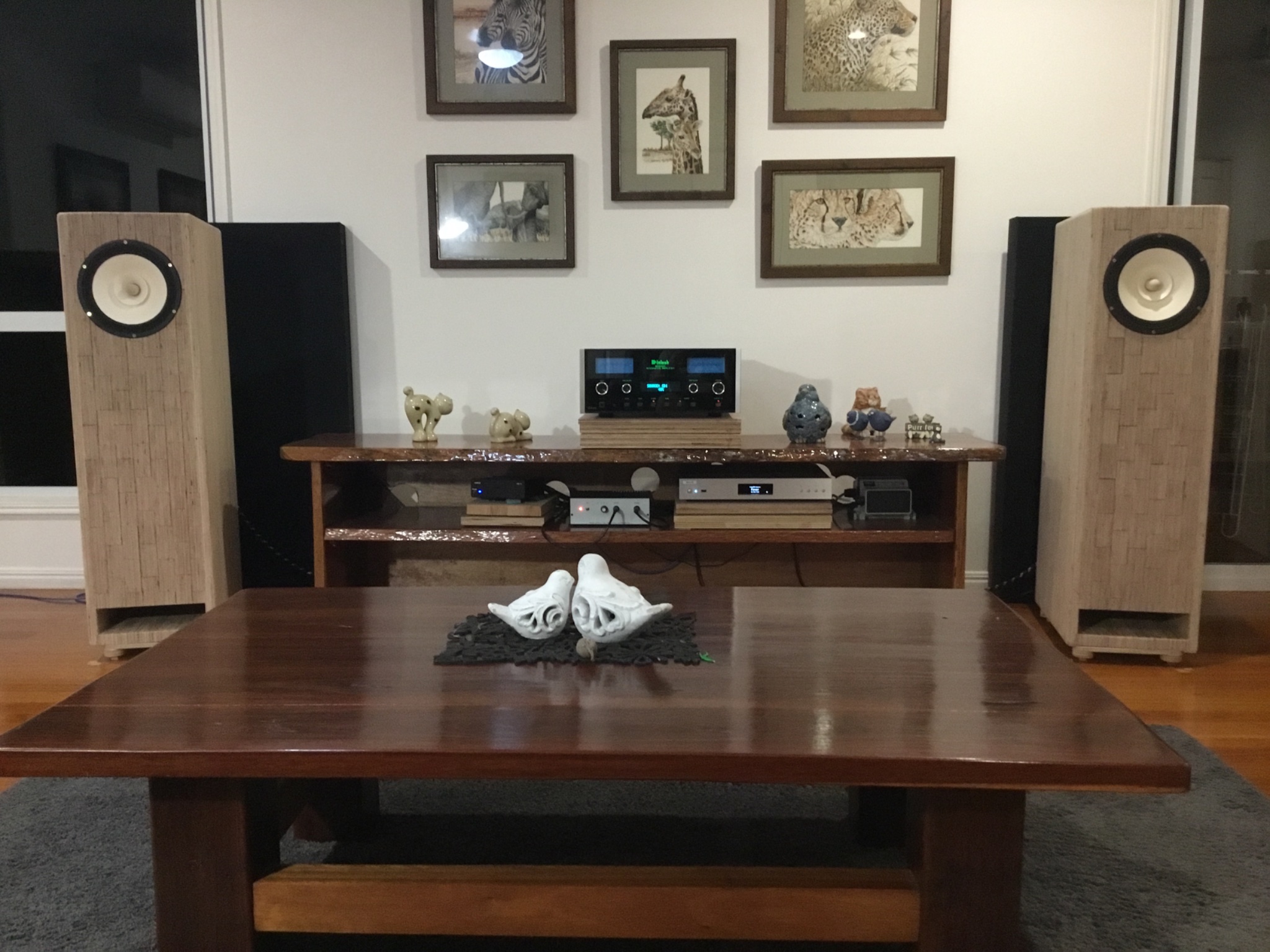

Definitely, these drivers are fatigue free compared to others!
I’m finding the 250 to be a nice size!
I’m guessing that Field Coil drivers are heavier because there is a Huge amount of copper wire making up the Electromagnet! Mine are much heavier than my conventional drivers.
The new box is ready to accept the drivers!
It’s not varnished yet, see how it sounds first!

Hi Chromnuts!
Yes, a bit like chopping blocks.
There is a type of timber beam known as “ LVL” … unlike plywood which has its layers running 90 degrees to one another, LVL has all its timber grain running the same way. I use many pieces cut 30mm wide and glued together like a chopping block!
It’s the best construction that I’ve found for Folded Voigt Pipe type speakers.. The sides are just dense plywood..

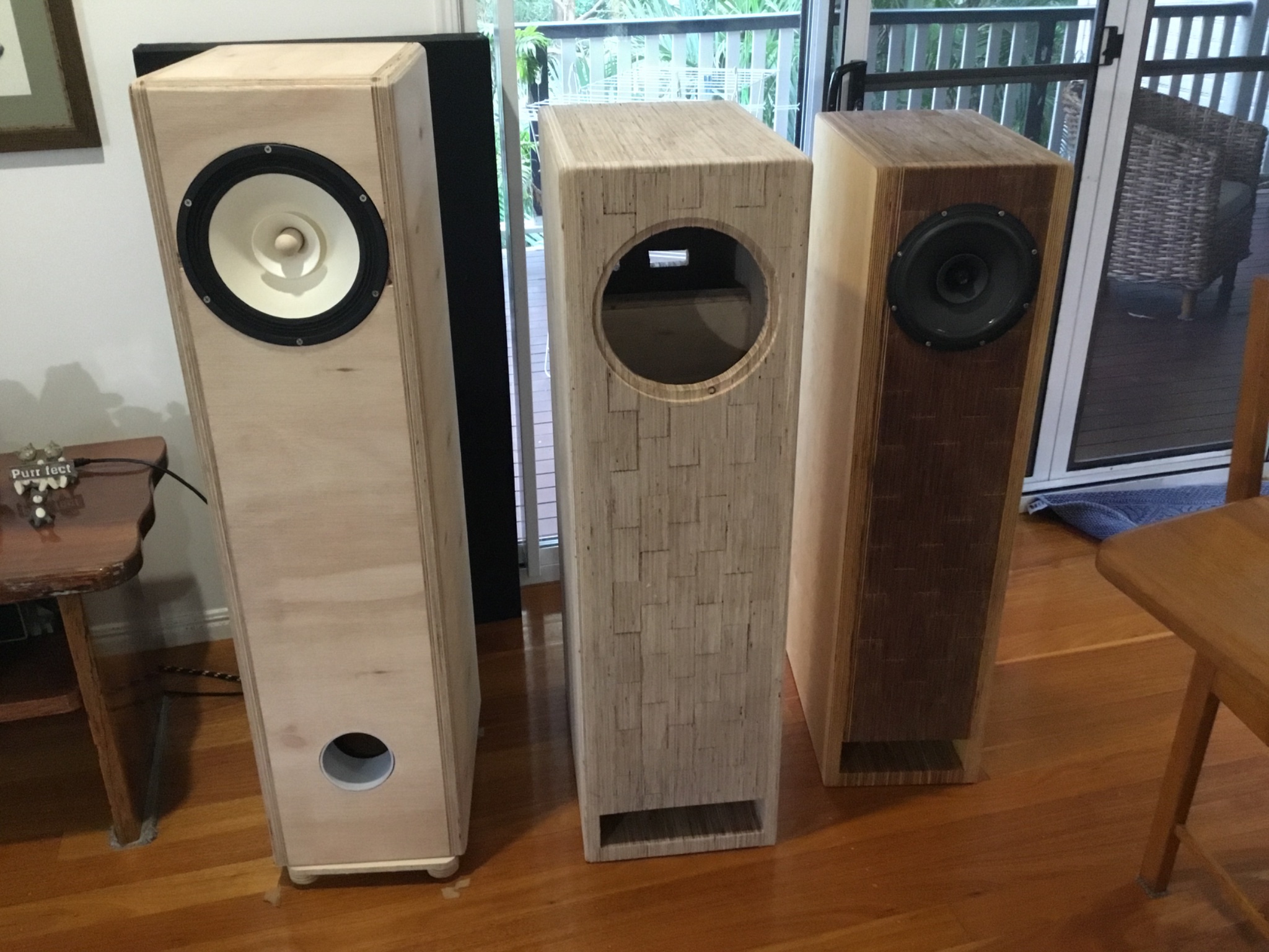

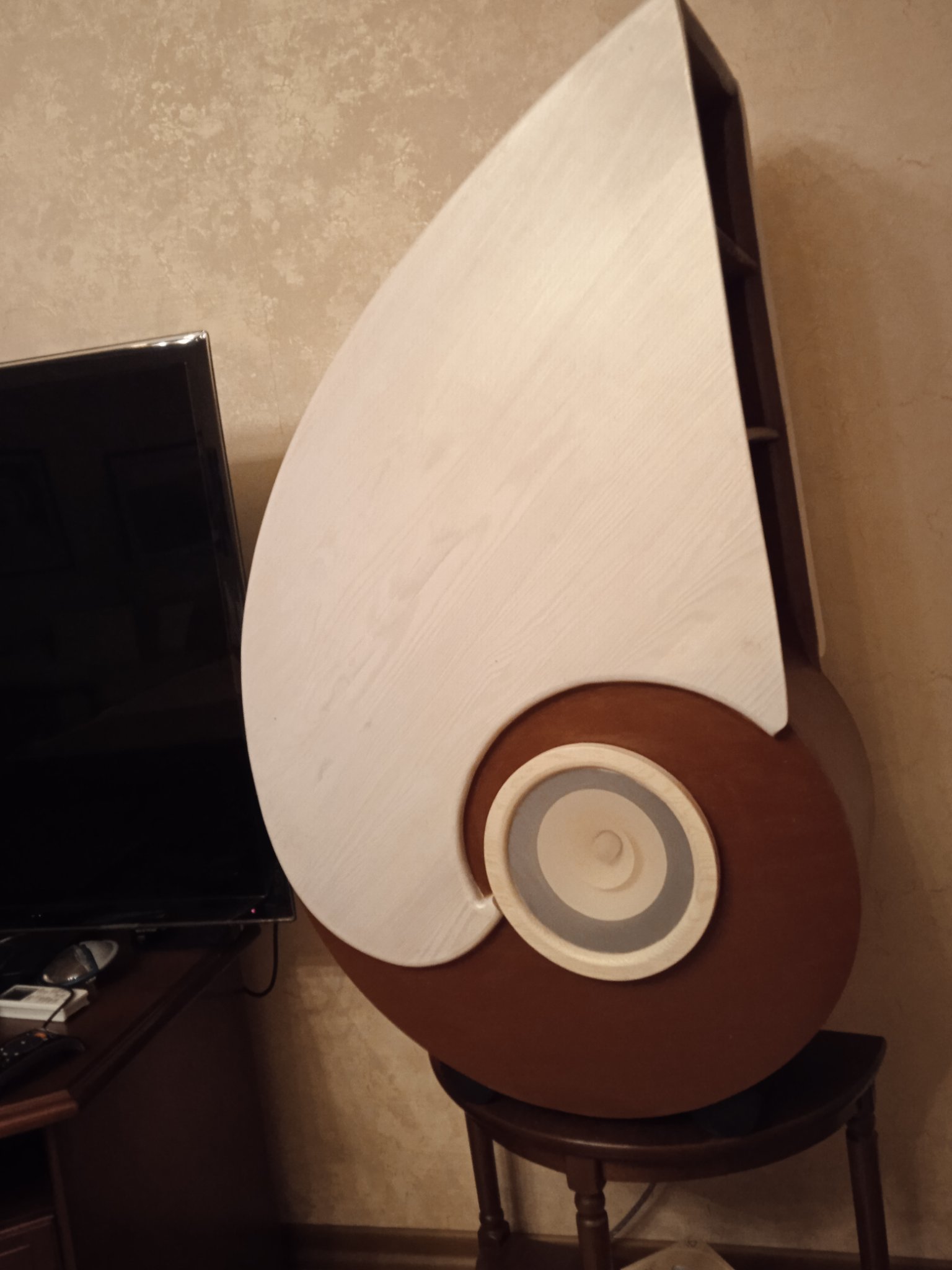

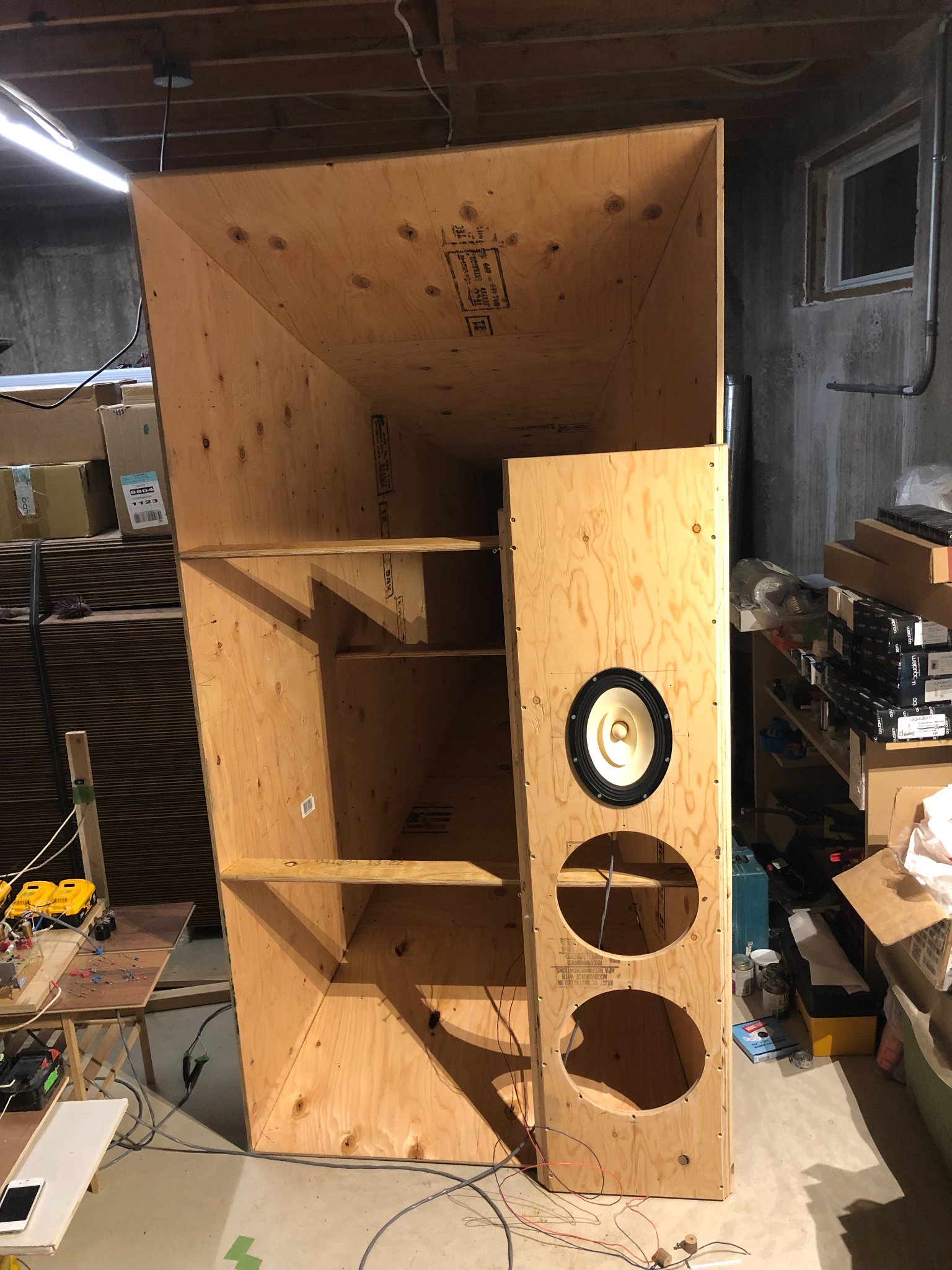

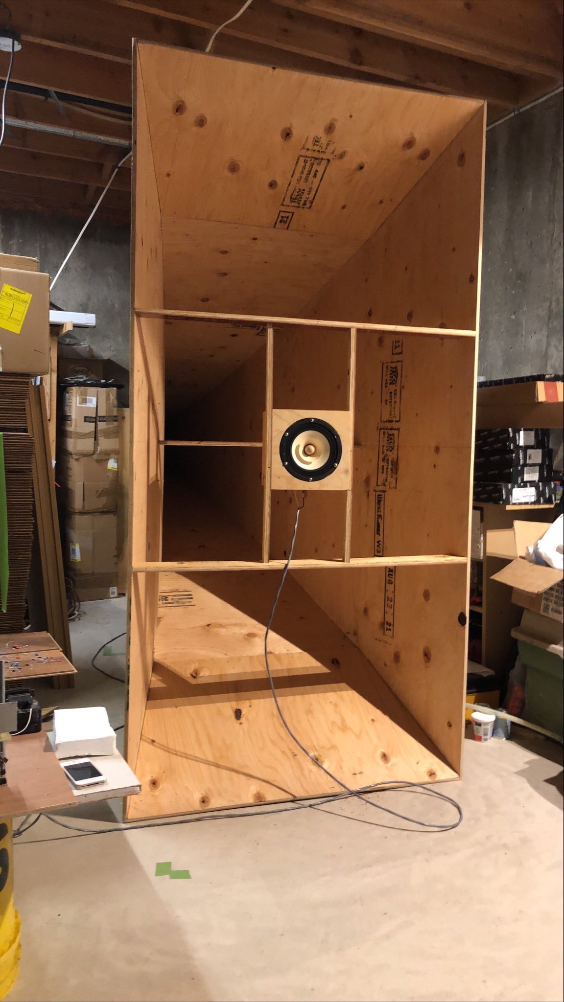

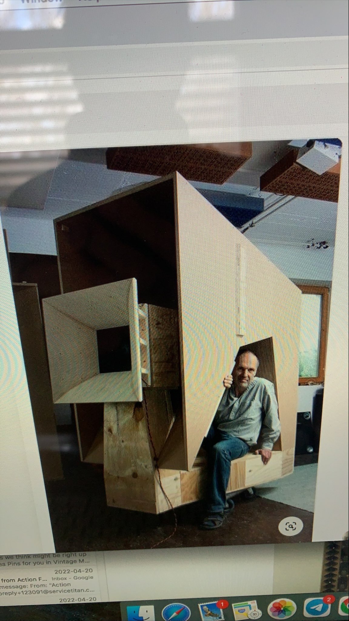

Please, there are such giants and with SONIDO drivers. But for such boxes there is a very important factor, this is the "wife factor".

Ha ha 😂!
With boxes that big, it might be good to make sure that the Dog 🐕 Kennel is comfortable to sleep in, because that’s where the Lady Wife will send you!! 🤣😂😆
