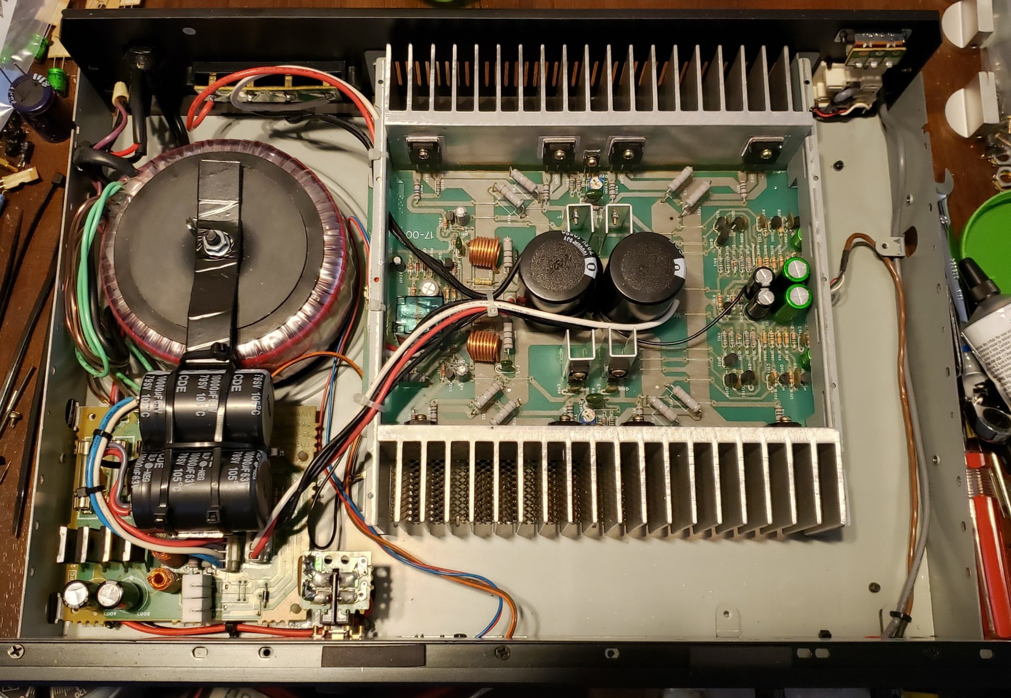

Thanks profiguy. One question to clarify, if I may. Do I want to solder AFTER the resistors 501/401? Is that to attenuate the levels coming in? I assume that removing one pin on the c401/c501 capacitors disconnects the rest of the circuit. Does that mean that the auto-on is disabled? (Guess that's two questions)@mpdevivo - just clip the red and white wires coming from input board and solder white to r501 / red to r401, then remove or lift one pin on both c401 / c501 4.7uf electrolytics. You will also want to use good non polar electrolytics to replace C801 / C901 4.7uf lytics like nichicon muse series and increase their values to at least 22uf for better LF phase linearity and lower cutoff. You could also add some smaller 470nf PP film caps parallel across them.
The Achilles heel of this amp are the main filter caps. They are underrated in voltage and can go bad prematurely. The supply rails are running close to +/- 50V and the caps are rated 50V. I have 2 of these 260 amps for testing speakers and both amps had bulging PS filter caps. I couldn't find 15000uf / 63V versions at the time so I used 10000uf / 63V which were a little taller size but they fit just fine under the cover of the amp. I dont notice any difference in SQ between the 2 cap sizes and also can't measure any more appreciable supply ripple at lower drive impedances. It may be the replacement caps have lower internal R. Either way, these little 260s sound pretty good for cheap bargajn amps. I found them for only 20 bucks each at a thrift store.
I've got the MKII version, and it already has big 15000uf caps in the middle of the main board, so that's good.
I ordered improved op-amps to see if that makes an improvement, but I'll probably go ahead and bypass the whole input board. Oh, I also realized that its easy to bypass the level-setting pots by swapping internal cables. It just switches the Left/right signals.
You want to connect before the resistors since they're a part of the HF lowpass of the turn on board and aren't needed, as the main amp pcb has an input LP on it as well. This is how I run mine with zero stability issues.
Removing the two electrolytics on the input pcb disconnects the turn on circuit.
Make sure your filter caps are rated higher than 50V,. I have the mk2 version as well and it has 50V 15k uf as well.

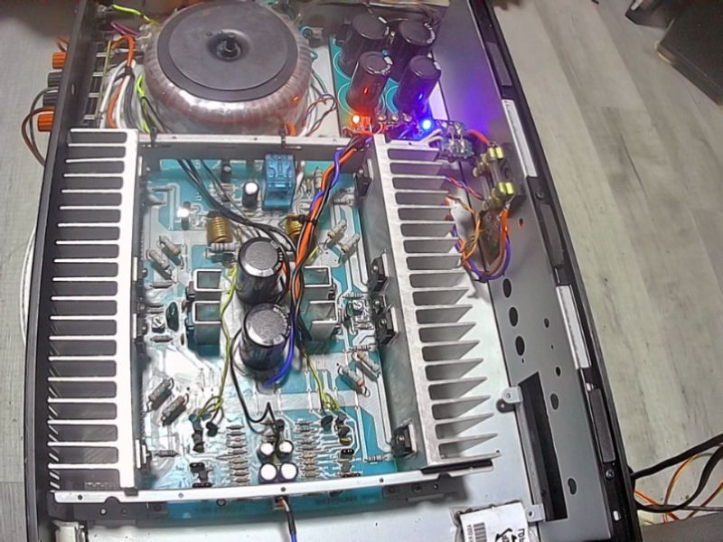

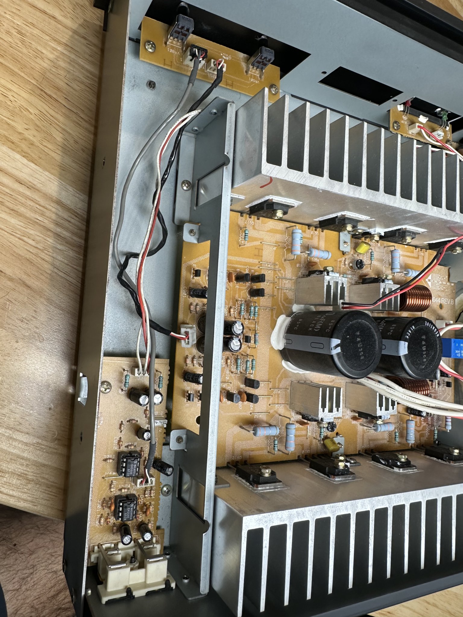

Here's a shot of my 260 test amp...
I made the following changes to it -
- Removed auto ON circuitry, relay and op amp input buffer pcb
- Bypassed input op amps
- Added conductive plastic pots to inputs for attenuation
- Upgraded all electrolytic caps to Nichicon Muse and Panasonic EB series
- Added extra PS filter caps totalling 20000uf@63v and noise filter chokes with dampening resistors
- Bypassed power relay and wired existing power switch to transformer primary instead with added .047nf/400v arc suppression cap
- increased bias to 5mV across .33R emitter resistors (up from 2.5mV) for lower distortion
Wow! Thanks for sharing. I like how you removed the entire input buffer board. I will most likely do that and bypass the left/right level setting pots as I don't need them. The next step you recommended was to replace the C801 / C901 capacitors. The schematic is a little blurry, but it looks like they are specified at 25v, though the components on my board say 63. Should I go with bigger 63v caps just to be safe?Here's a shot of my 260 test amp...

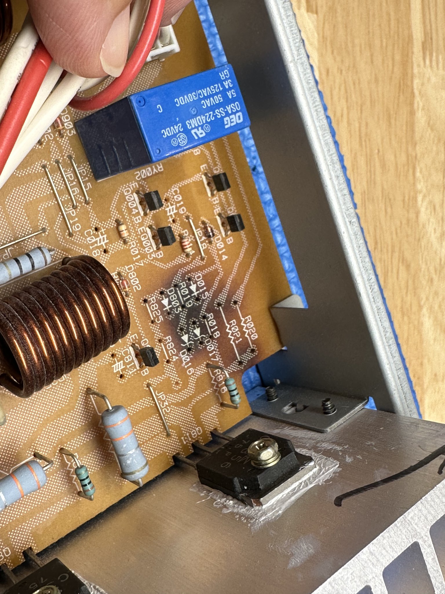

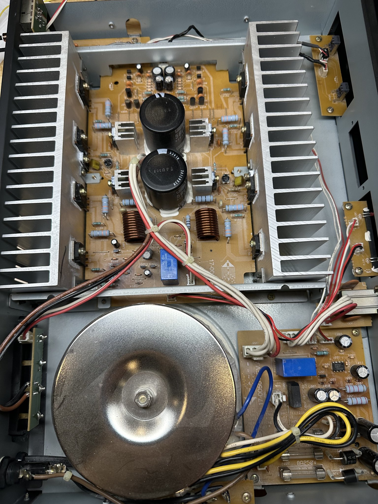

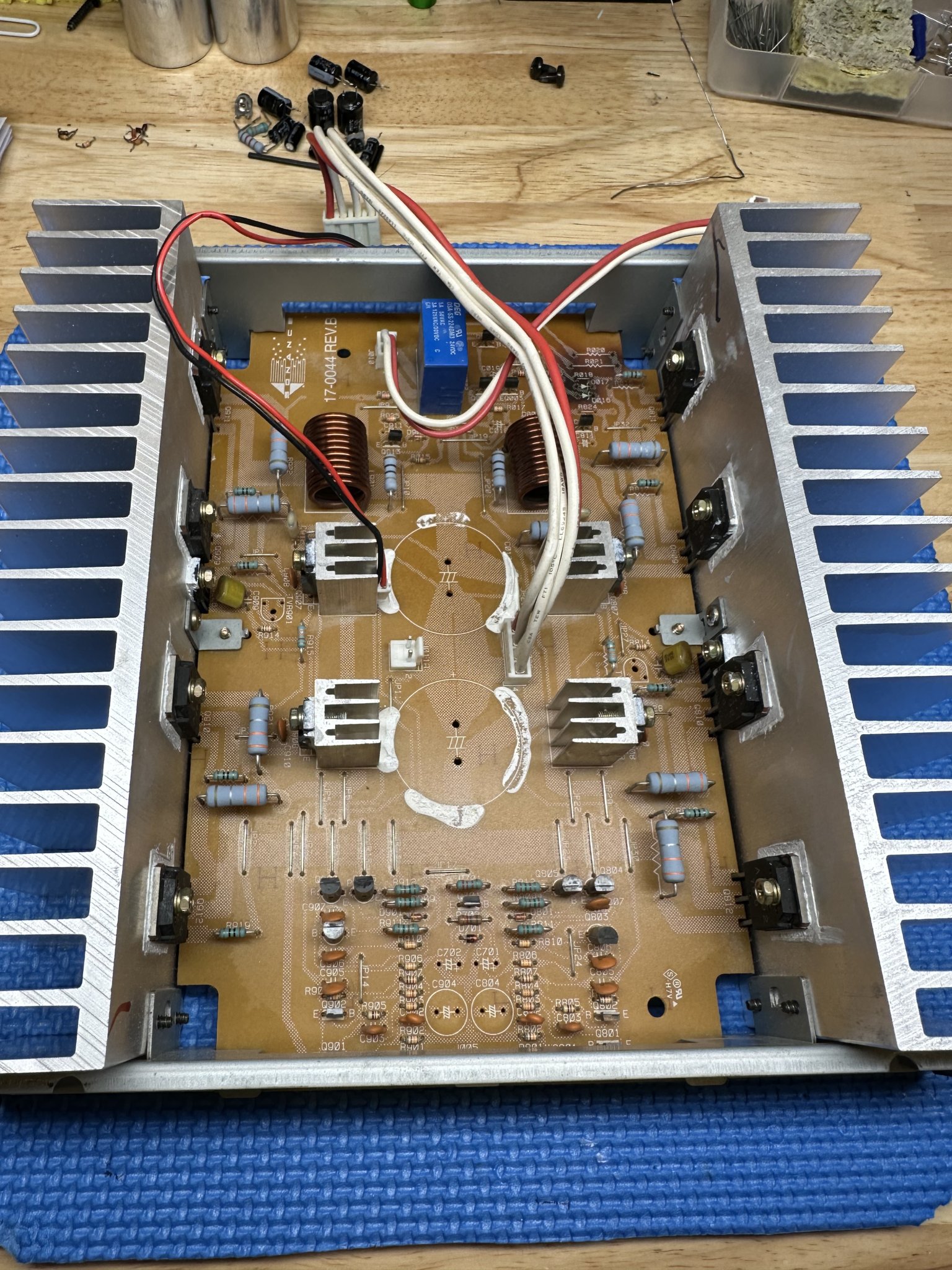

My wife had a Sonamp260 in her work studio playing for many years, we decided it was time for an audio upgrade. The byproduct of this is, I now have an old Sonamp260 that still works fine. What to do?..... Search DIYA for anyone that has tweaked these. BANG, here we are 🙂.
I always felt the input buffer, volume pots and auto-switching circuit held back ultimate performance from this design. My 260 seems a bit older then the ones pictured here, the posted schematics are almost the same but for a few component changes, the main pcb is slightly different as is the psu board. The OS uses Sanken 2SC3856/2SA1492. But the heatsinks are slightly bigger, Yay!
I jumped right in and tried to disable the input buffer section by disconnecting the power connection, header J003A on the PSU board. But now the amp doesn't turn on. The workaround was to re-connect J003A, disconnect signal input to the main board (J005) and connect external RCA's directly to J005 header. This worked fine but the stock input buffer board and circuitry is still being powered for no reason. How can I remove this section and still have the amp turn on as normal?
I've also removed all the parts on the main board that will be replace. There is a pcb section that has been getting cooked over the years, higher wattage components lifted from the board will be reinstalled.
Luckily I got two of the FR4-green boards.

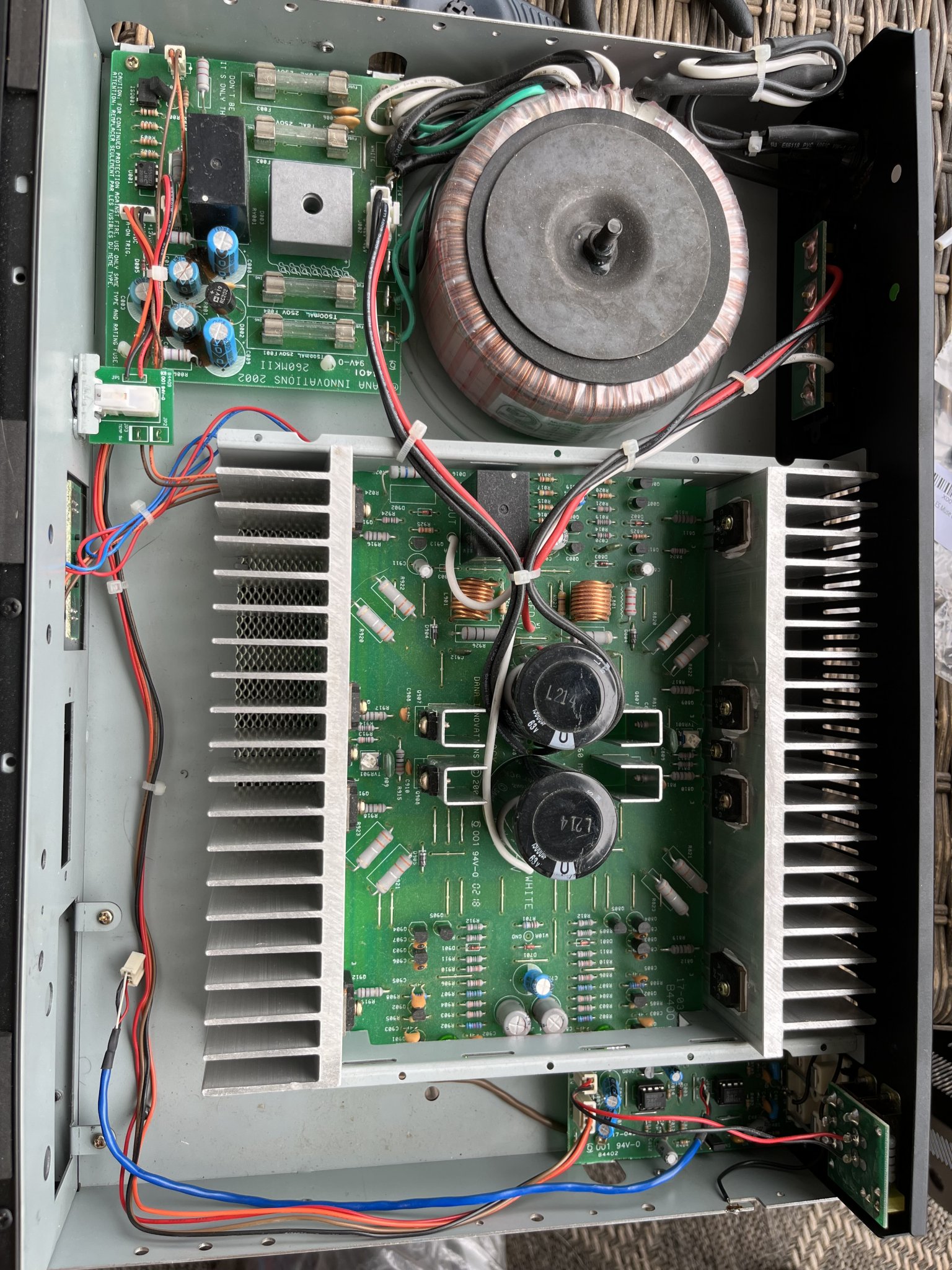

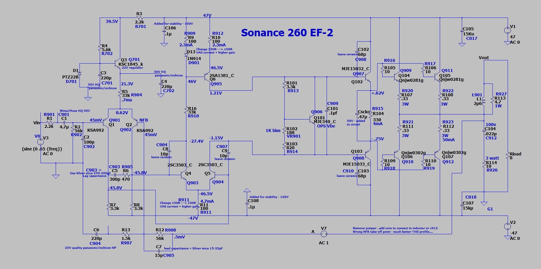

This is a nice amp. If a make a few changes.
Mine had one fully bad filter cap , every other one was high ESR.
Amazing both amps still worked (even with bad caps).
-Ditch the junk power board and remote start circuit.
-factory set super low 3-5mV bias settings , I set 15-16 mV (50mA per device).
-NFB takeoff point is pulled from one emitter resistor (PCB layout error)_ , takeoff from the output inductors. (yellow wires).
-Replace the lead and lag compensation caps with silver mica 15pF-lead / 270pF - lag
........Thats all on the simulated schema.
-VAS is "starved" (<2mA). change R909,911,912 to 100R. Bias should be turned all the way down. With VAS @ 2.8mA -output (15mV) is
about 12 O'clock on the bias trimmer now.
Slight recompensation - The JUNK ceramic lead was <7pF and the lag 330pF was way off. I replaced with a nice
15pF silver C905. And the lead was replaced with a new silver 270pF. This smoothed the phase margin plot , much better
than the "dodgy caps".
In the end , I am HAPPY !!! These are nice sounding amps , they can drive 80V P-P all day into a 4R load.
My two both lasted over 30 years , NOT ONE bad semi !!!
This design has the "80's" sound like the old Toshiba/Hitachi receivers. It also has native LOW offset , which
is dependent on the quality of the DC blocking cap.
New specs - .02% 20-20Khz , most of the range from 20-15Khz is only .002%. really good for such a simple circuit.
Damn , this amp is DEAD quiet ! Quieter than some of my DIY amps.

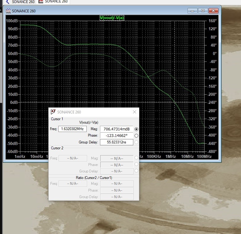

Update , I finally added the 6 100R VAS resistors. VAS idles at 2.2mA now , gets just a little (barely detectable) warm.
100R is convenient for current readings .48V = 4.8mA .
Loop gain is now 72db with unity gain at 1.6 Mhz.
But , have the bigger lead cap - 15pF. Margin is kept .

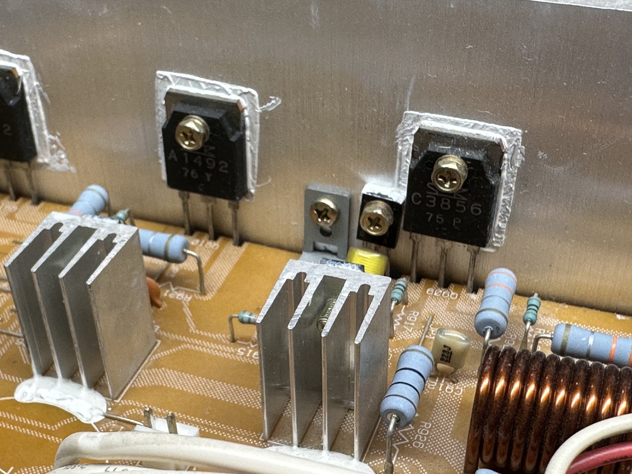

I did not think I would be happy with such a primitive design. Just 5 devices for the IPS/VAS ?
As a project - -
- using a separate current source for each channel.
-TTA/C004's for VAS , all the rest use ksa/c 120V to-92's.
-Higher Vceo drivers.
- Run at 60V rails.
Then , you would have a straight 120W/8R amp that could really peak out.
45-47V rails give you overkill SOA , why this amp is rated to 2.7R load.
I was surprised they took the NFB feedback WAY from the end of the output trace. Under load , that would add 90% of the
circuit's distortion.
The other distortion mechanism is the low current VAS running the EF2. The Sanken driver/output combo's DO have some of the best
beta for output stages , but 1.5mA is ridiculous ! Another easier way to boost VAS Ic would be to reduce R904 33K--->27K. LTP tail current
would be @.5mA.
The super low .35mA Q901/902 current is why this amp has such low noise.
Great garage or test amp - IMPOSSIBLE to kill this build quality - Ebay has dozens of these for 30-60$ - still ....
Edit - I now have two of these for under 80$ - could not be happier.
OS
As a project - -
- Run at 60V rails.
would be @.5mA.
OS
Sonance = the most simple version of the "Hitachi topology".
Below is the same topology with advancements.
That beats the "Wolverine" (sub PPM).
Oh yeah - perfect bias for the Sanken A1386/C3519 pairs is lower than the ON's 70-80mA per device.
My HK680 has the same devices , OEM settings are 10mV @ .22R = 45mA per device.
Sonance is 15mV @ .33R , about 47mA (per device)
