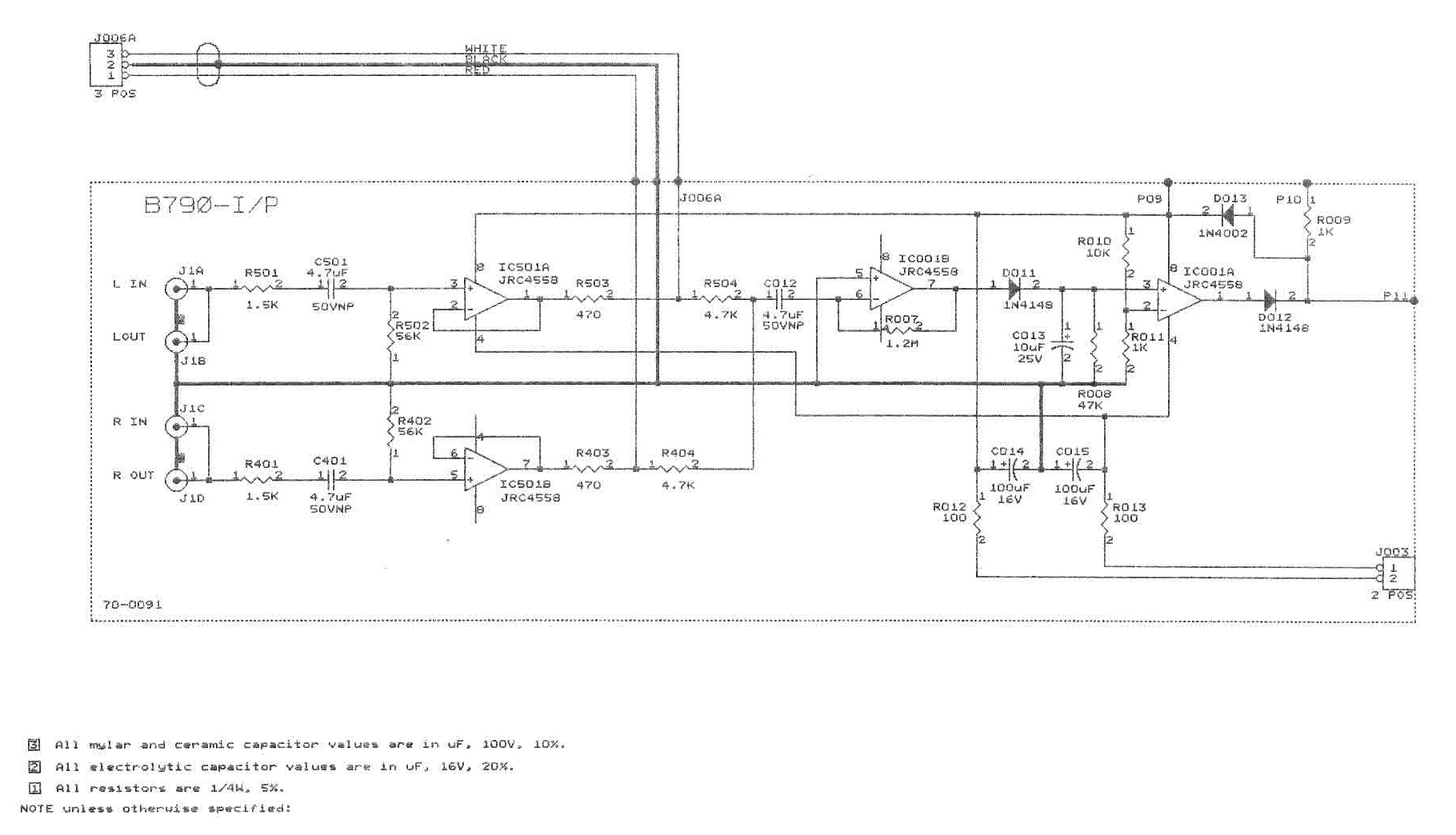

Hi folks,
I am new to the forum and have been lurking around for a couple of weeks now.
I recently picked up one of these amps at a local thrift for about $15.00. It sounds great as is, but my intent is to recap this unit and give it to my teenage nephew who is just getting into audio. But after reading through this thread, it appears it can be made even better. However, I am having a difficult time understanding all that is going on in this thread specifically, and I am looking for some clarification. It seems like there are a couple of different conversations going on.
I'd like to make the few subtle changes that @profiguy has suggested, but I am a little confused about his comments.
In the post above he says; "just clip the red and white wires coming from input board and solder white to r501 / red to r401, then remove or lift one pin on both c401 / c501." Then in post #22 he says "You want to connect before the resistors since they're a part of the HF lowpass of the turn on board and aren't needed, as the main amp pcb has an input LP on it as well."
So, do I just unplug the connector from this board (which I assume is the input board), cut the end and solder the red and white wires to the RCA inputs (arrows on the attached pic)? Is that the same as soldering to r40/r501 (A&B on the pic)? If not soldering to the inputs, what is considered before the resistor? Is that towards the back of the board where the lettering is, or closer to the leg with the op amp?
Also, instead of unsoldering just one pin on C401 and C501 (A&B in the pic), can I just remove them altogether if they are not needed?
Any replies would be much appreciated. Thanks in advance for the help!

I'm away on travel this week and can only check here infrequently, so if profiguy isn't able to respond, let me try. Your basically have things correct but have misidentified the proper red and white audio leads. The audio signal leads are in the blue-sheaved cable in the middle of the board. L, R, and Ground are labeled in the silkscreen there. Leave the ones you have labeled alone.
I left the ground lead alone, and jumpered L and R wires on the cable to the RCA fittings. Please verify you have chosen the correct spots on the RCAs for that (I always forget on those fittings and trace it out each time). Doing it this way is the same as connecting to "before the resistor", which is where the signal enters the resistor on the schematic, the end that is physically next to the RCAs.
Yes, the two coupling caps can just be removed.
If you also want to bypass the front panel level controls, etc., you can reroute the other end of the blue-sheaved audio cable directly to the main board. I don't recall if L and R are reversed if you use the original fitting (I think they are), but if so, you can compensate for that when you do the jumpering discussed above. As I recall, I did that because I wanted to preserve the blue-sheaved cable and its nice shielding.

Hi Northpaw,
Thanks for the quick and detailed reply! You save me from really screwing up.,
I will look into bypassing the level controls-if I can figured it out. I also have a bad power switch on this unit, so I have one ordered and on the way, Once I get the input board and power switch squared away, I plan on creating an inventory of caps so I can order the replacements. This unit sounds pretty good (especially for $15), but I hope the changes can make it even better.

To Northpaw and all that have provided input to this thread, THANK YOU!
Over the weekend, I completely recapped this unit. Also,
  1. Changed the C801/C901 caps to 22uF
  2. Completely removed the C401/C501 caps
  3. Changed the main filter caps from 50V to 63V/15000uF
  4. Soldered the input board leads directly to the L/R inputs
  5. Replaced faulty power switch
After replacement I checked the DC offset and it was R-3mv and L-8mV. Pretty much the same as it was before the cap replacement. Unfortunately, I don't have a scope, so I won't be able to adjust the bias. If there is a way to do that without a scope (and killing myself) please let me know!
Then I ran the unit at high volume for about an hour and rocked the house. It sounds unbelievable, and didn't get too warm either.
I do have another one of these units, so i will be doing the same on that unit as well sometime in the future.
Thanks again everyone.
