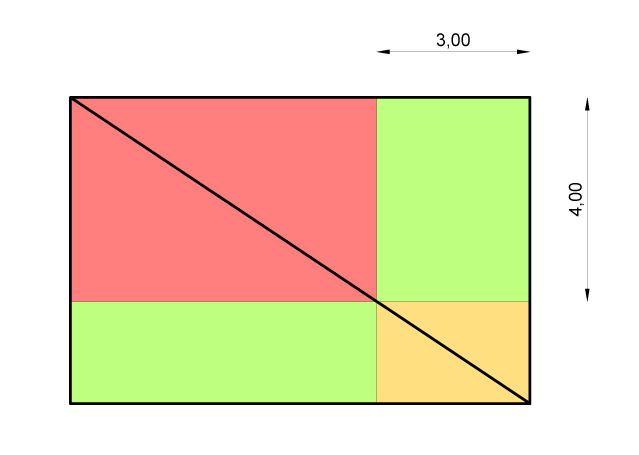

What is the area of the shaded rectangle?
the dimensioning of the drawing is incorrect, the area can be either 10,84 or 13,2 :D

Not enough info; undefined.
Unless you assume something about the two opposite sharp angles.
Jan
Assuming the two opposite sharp angles are the same( same slopes ) you end up with: The area of the shaded rectangle must be 12.
For a mathematician, this not enough to answer, because this is no proof the triangle exists.
Then more work shows that it does exist. Not only one but any as long as it's area is 12.

thick black line triangles are similar (area is the same).
red triangles are similar (area is the same).
yellow triangles are similar (area is the same).
green rectangles must have same area. one of them is 4 * 3.

The rectangle area puzzle.
There is no specific need for the 4 and 3 values, this is to lead to messing with Pythagoras, that ends nowhere.
Proof
Instead of 4 and 3 let's use A and B.
Draw the figure with a rectangle which area is AB
X horizontal edge.
AxB/X vertical edge.
The upper small triangle has straight edges X and A.
The slope of it's hypothenus is A/X
The lower small triangle has straight edges B and AxB/X.
The slope of it's hypothenus is (AxB/X)/B.
We see the two slopes are equal.
Hence we do have a figure where the answer to the puzzle is AxB regardless of the chosen X.
QED
