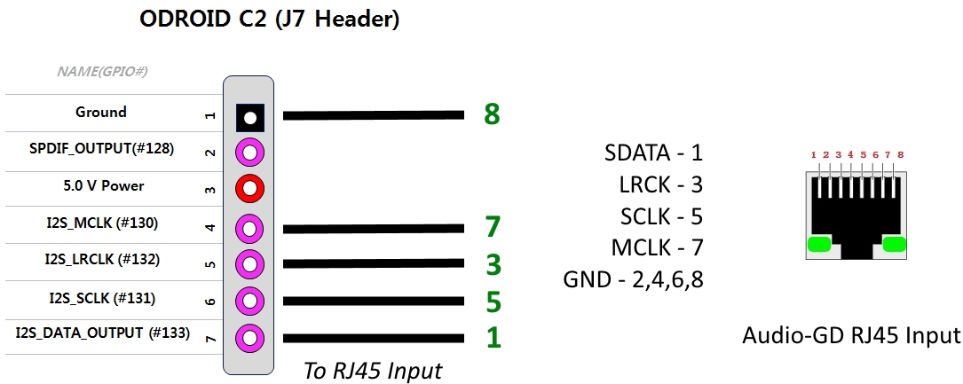

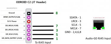

I am trying to understand whether I should wire my ODroid C2 directly to my DAC by I2S, or if there would be a major benefit by going to something like the isolator hat, FIFO board, McFifo? There are quite a few choices here so it's difficult to determine which is the best one. I do not wish to use RPI because of its slow Ethernet connection. I want to keep the ODroid C2 because of its GbE and eMMC storage. I must find the best choice for ODroid C2.
I was planning on making a cable to run from my C2 7 pin I2S header to the RJ45 input of my Audio-GD NFB7.77 according to the photo attached. The NFB7.77 should be able to clock the signal without the MCLK present. Without the MCLK, do I need to worry at all about poor clock quality from the C2? Would there be a vast improvement by going with a McFifo or I2S isolator hat? All input is appreciated.
If you are worry about jitter, FifoPi would be your solution.
Ian
