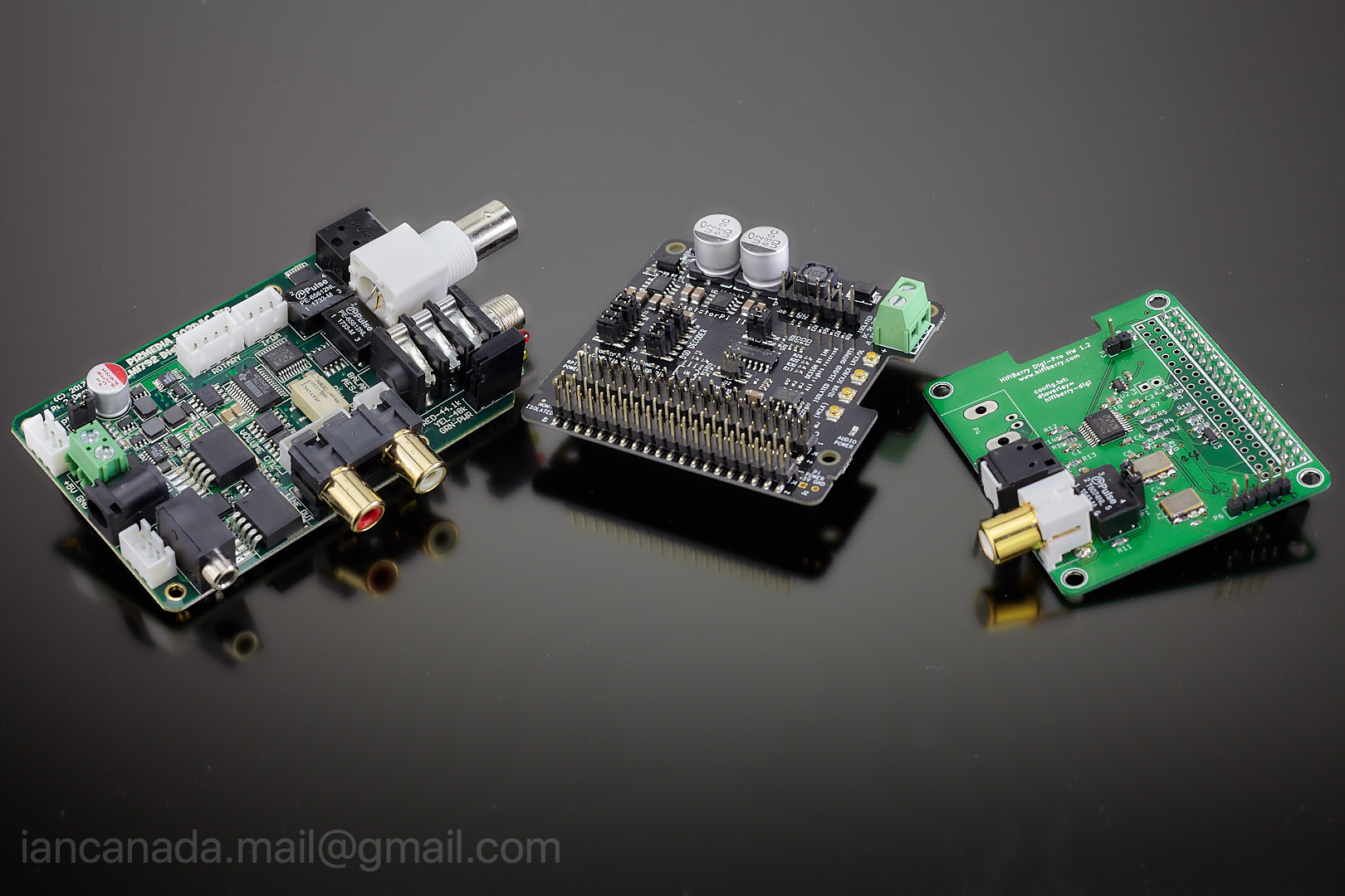

Besides all the features originally from IsolatorPi, what are the new updates on IsolatorPi II?
1. IsolatorPi II now supports 502DAC Pro, Hifiberry Digi Pro +, and all other WM8804 based master clock mode applications;
2. IsolatorPi II has the optional 40Pin non-isolated GPIO connector pre-installed. With which, we can connect the possible ESS DAC controller, Ir receiver, the rotary encoder and all other non-audio devices to RPi. The good thing is that all of those devices will become 100% isolated from DAC under this configuration.
3. With IsolaporPi II, now we can power RPi from GPIO (reported better than USB power) through the no-isolated GPIO connector, or, from the +5V and GND Pins beside if that GPIO is occupied.
Ian

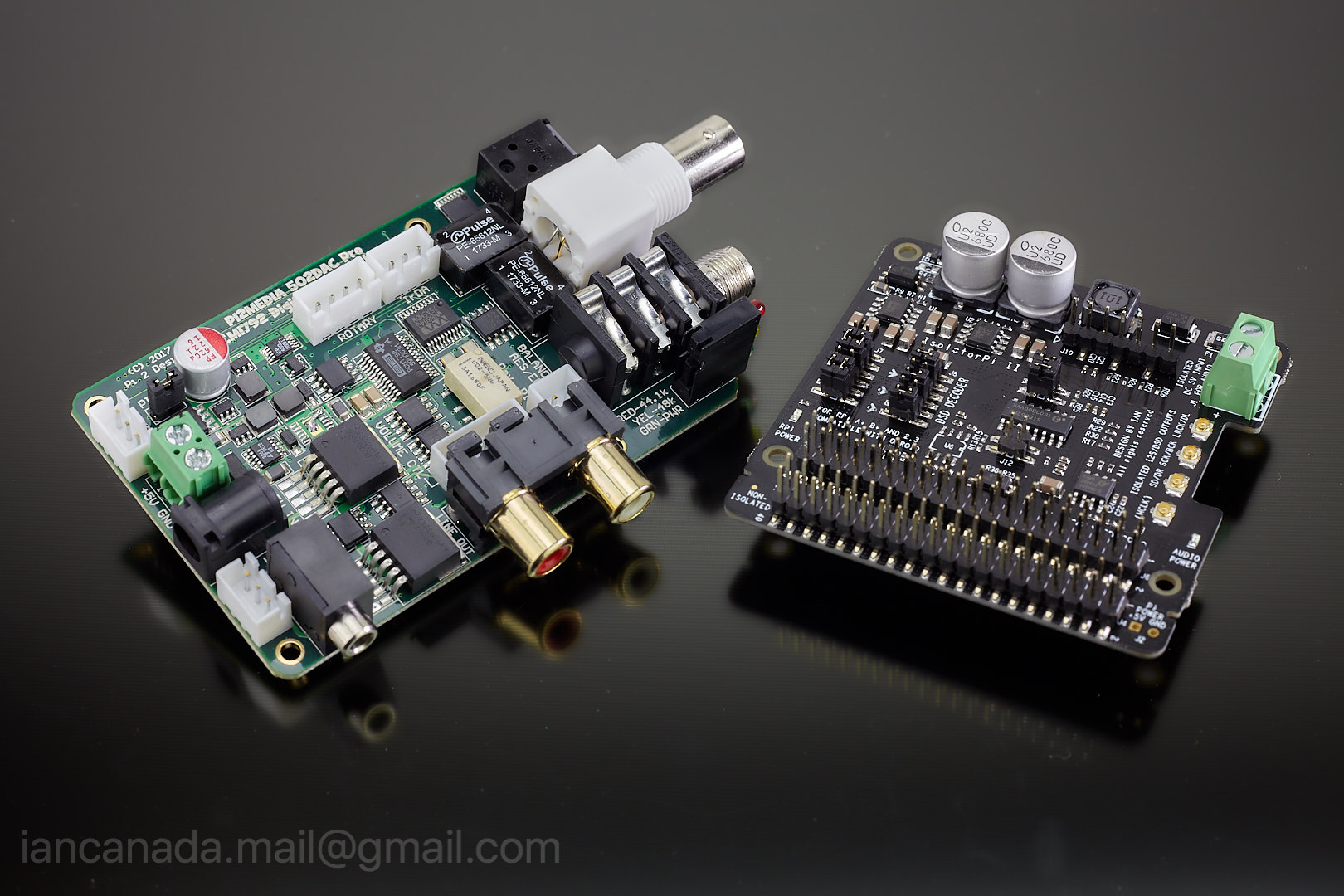

IsolatorPi II was tested working perfectly with 502DAC pro.
502DAC Pro is an audiophile grade DAC HAT. The sound quality is amazing. It has almost everything: PCM1792, master mode WM8804, S/PDIF output, balanced/se output, and LME49600 headphone amps. It's the best DAC for RPi so far I've ever listened.
It can benefit the most out of IsolatorPi II because it works in master clock mode. Clean isolated 5V DC power supply will power 502DAC Pro from the IsolatorPi II. 502 DACPro takes awesome current around 1A. Red/Yellow LED will be switching when music switches between 44.1/48KHz Fs groups.
But too bad it's been discontinued. Michael told me that price can not cover the cost. I think it's true.

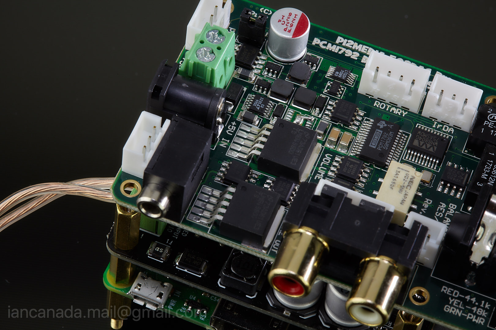

Finally, we can no longer use the USB power!
