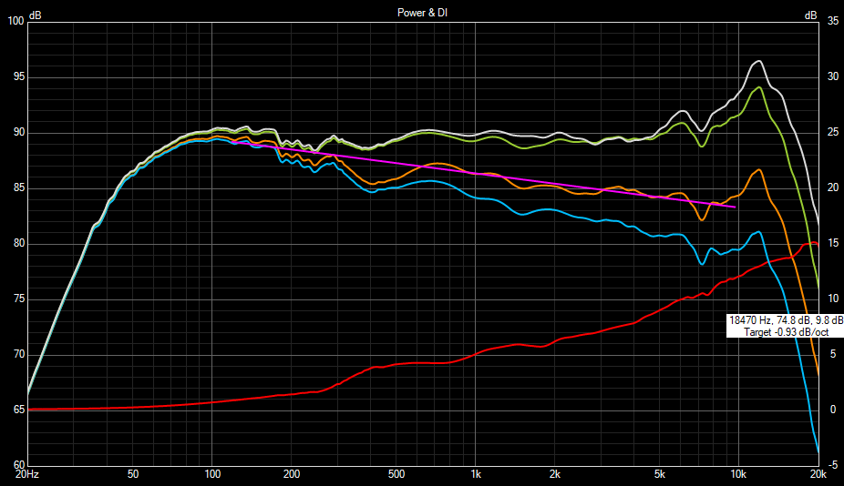

Are you crossing those amts passively, and if so, how do you deal with the esrly HF roloff?

The key is to not focus too much on single axis response. I tried a few different things, but found what sounds best is to follow VituixCAD CTA-2034-A method and tune for constant slope of in-room and power response. Screenshot attached. You will see, that most of the natual rising response of the AMT is left in place here, but in-room and power response are flat to 10kHz as a result of the tweeter directivity profile and crossover involved. It is not perfection, unfortunately the very top end performance of the AMT is the weak link in this speaker, but it is still incredibly enjoyable to listen to, the tonality through the midrange and bass is perfect.
In the screenshot, don't read too much into the midbass response, it is real hard to get accurate measured data with woofer at floor level, as well the PR output is not included here for the bass performance <100Hz. On the other end of the spectrum, the wiggle at 7kHz was only present in one of my AMTs, the other measures perfectly without the wiggle. I even went as far as to disassemble and inspect them, but I couldn't see any problem, reassembled and nothing changed. My ears cant tell the difference between the two tweeters when listening so I am not very concerned.

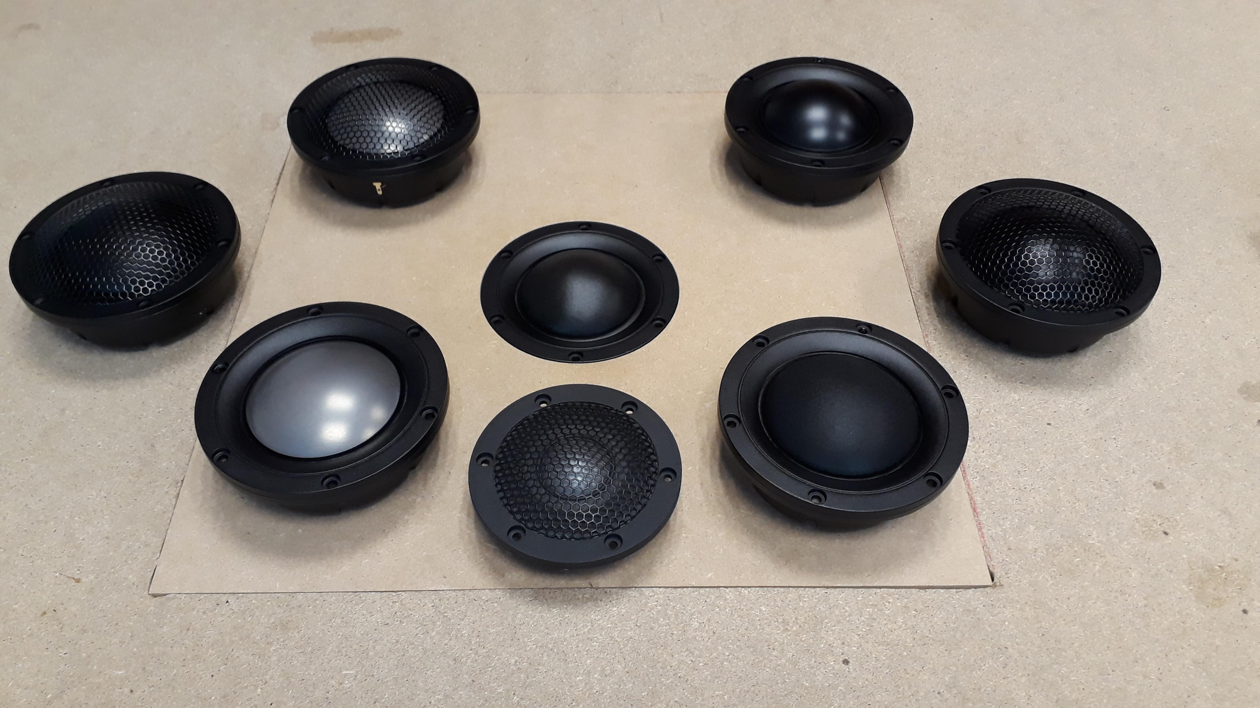

Found a new pic of the Bliesma domes. Hope they land soon and have nice measurements (for hificompass to conifrm).
If the 3" soft dome/paper/aluminium could do 750hz-4khz with LR2 either end and low enough distortion and for $200-250 then they would make a killing.
They'd have my cash in a heartbeat! Though, I'd be happy with 3khz. In the meantime, I'm tempted by the Kartesian Wom120, which strikes me as a bargain.
