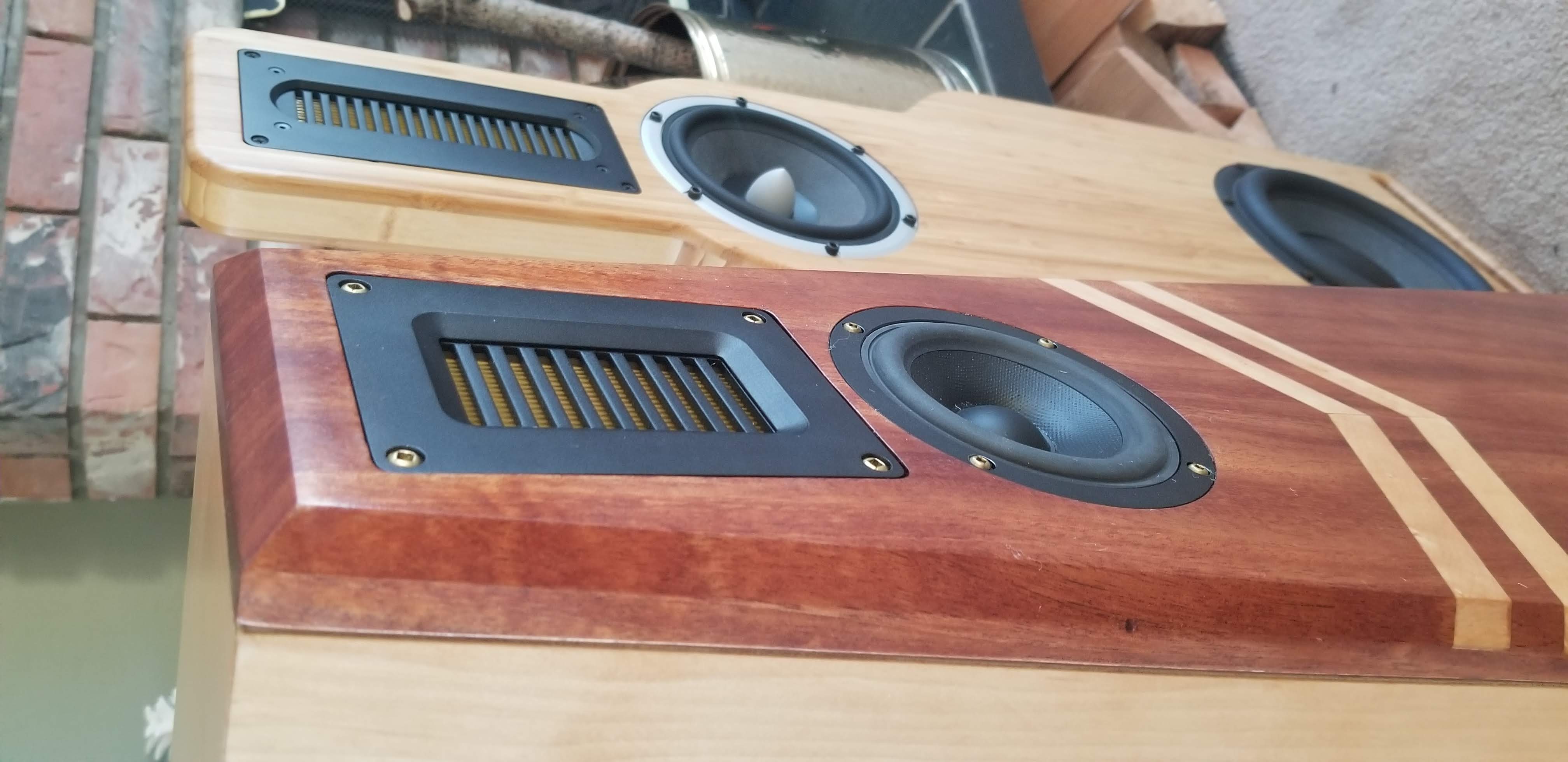

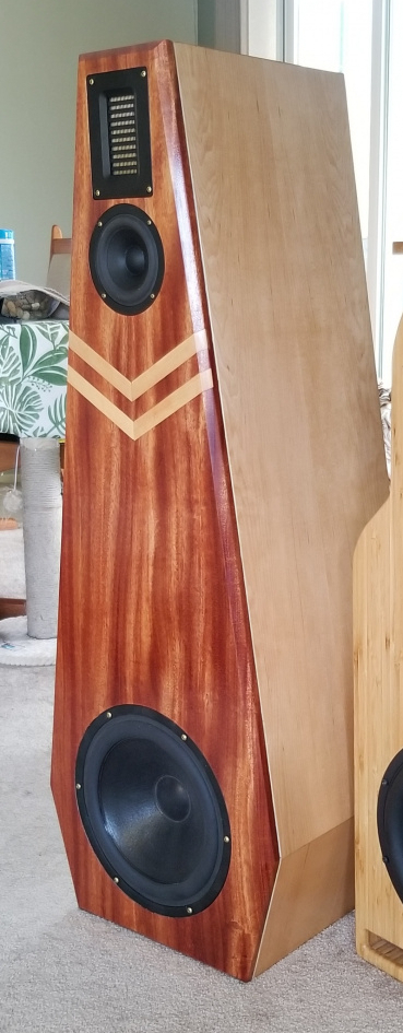

This is what I did with them 😉
What mid is that? Assuming HF is the dayton amt pro4?

Amazing work -looks like your cats are well trained no claw marks on speakers 🙂

Mid is Wavecor WF120BD04, tweeter is Dayton AMT3-4.
The cat is much more interested in our house plants than the speakers, it’s our dogs I have to worry about when they wrestle .
