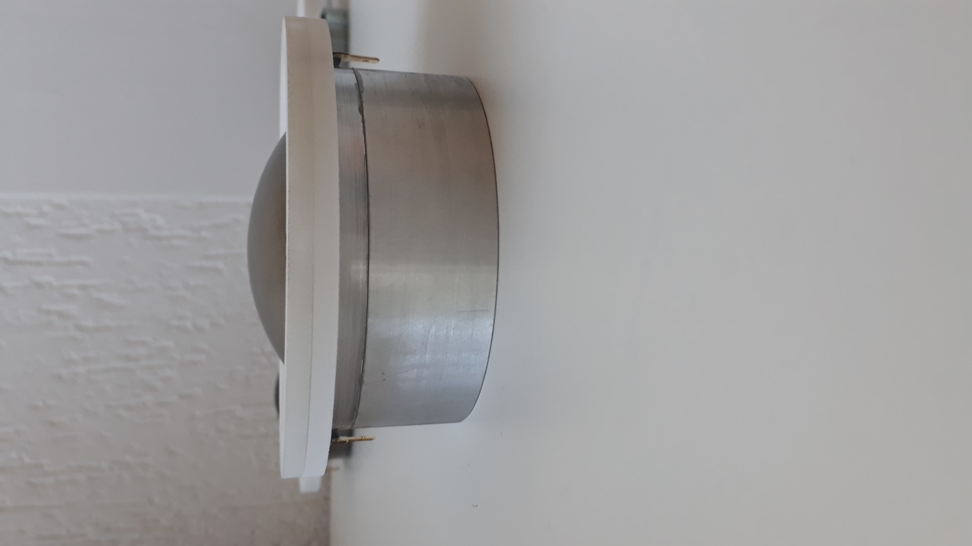

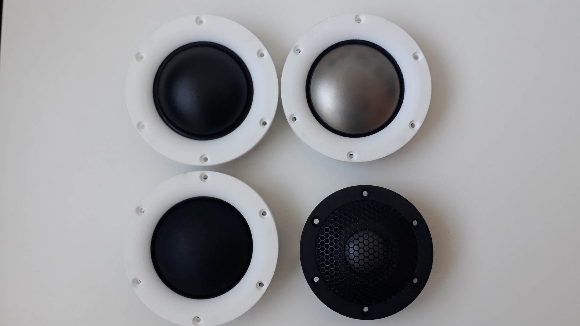

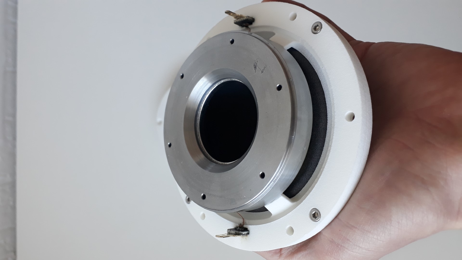

The berylium dome will be the first to be released but an aluminium, paper and fabric dome are coming later. Flange is 121mm wide and 10mm thick according to Malikov (Bliesma founder/engineer). This 121mm flange claim seems to be consistent with the photos he has posted, where we can see this new mid-dome next to a T34 tweeter. At long last a mid-dome without a stupid, unnecessarily large flange, which will allow higher crossover with the tweeter ! The surround also seems to be quite narrow, like the tweeters from Bliesma.
Since the images are not that easy to find in this russian forum, here are the photos Malikov has posted.
attachment.php
attachment.php
attachment.php

Thanks for posting the pictures, it tried but without success. According to Google traduction, it seems that Stanislav designed this dome to match the t25 tweeters. I already imagine really expensive 3 way 10+3+1 (in my dreams because totally out of budget 🙂)

My guess is that the prices will be higher than 500€ a piece, especially for the Be version. The T34B are already 400€ each. In the russian forum, Malikov said something along the lines of a very high price that he prefers not to reveal yet (that's by using a translator though, it was not really clear).
The 3" Be dome is going to be very expensive. That's a huge amount of Be compared to a tweeter. It will be interesting to see where it has its primary breakup.
To compete with the ATC/Volt tweeters they are going to need a large amount of xmax, not sure if they look capable of that from the pictures but we shall see.

On the russian forum, Malikov himself said that the flange diameter was 121mm. By comparing the diameter with the T34 (104mm) on the pictures, I also find 121mm. Therefore, this information seems to be true.
I agree with you otherwise. My point concerning the flange diameter specifically comes from the center to center distance problem. If we can cross 15% to 20% higher, that is still some desirable flexibility to have, or to reduce lobbing at a given frequency. Since it is pretty much a free incremental improvement from a design perspective, why should we not welcome it ? When nearly all other manufacturers build unnecessarily large flange for similar drivers (or tweeters), it's good to see something making sense for a change.
For instance on most ATC speakers, the 104mm tweeter and 150mm mid-dome results in a CTC distance of around 130mm. The Bliesma 67mm T25 and 121mm mid would give a CTC distance of slightly less than 100mm. A difference of around 30% is not to be scoffed at IMHO.
