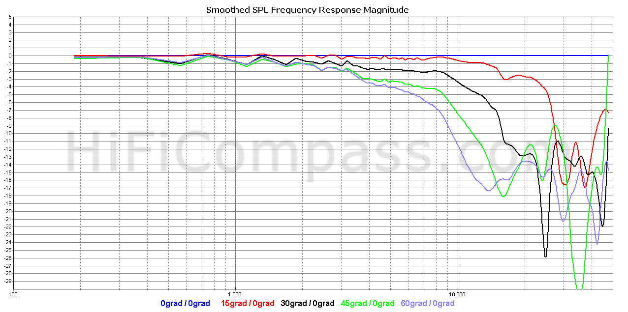

This driver certainly is very (too ?) expensive.
But what obvious flaws do you see about it ? The 16 khz dip ? That would be a consequence of the waveguide's throat width. Not something you can easily correct unless you use a smaller tweeter. Maybe you are thinking about something else ?
celef said:It looks good but at this price point i would expect more, i have this feeling that sb acoustics is rather sloppy, why do not they fix obvious flaws?
Thanks!🙂
I would like to know too, what is so wrong with TW29BNWG-4? I think, they pulled out the maximum of possible from mating a stock tweeter with a waveguide. If it was a design from scratch, they could achieve much better performance. But who needs it?
I recall my results of TW29DN and Jantzen WG, there was no dip (actually it is more like diffraction) around 17kHz, and I always wonder if TW29BN would work well in that WG too. Definitely worth trying before bying this BNWG.
Jantzen WG has very different profile compared to BNWG.
The fabric dome behaves quite differently in the top octave compared to the beryllium dome, so the difference may be not only due to the waveguide shape
Pida said:I recall my results of TW29DN and Jantzen WG, there was no dip (actually it is more like diffraction) around 17kHz, and I always wonder if TW29BN would work well in that WG too. Definitely worth trying before bying this BNWG.

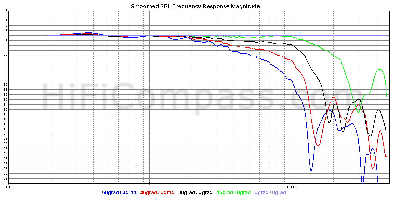

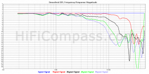

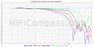

The WG design has an influence of course. But, IMO, the main cause for the absence of the 17Khz dip in the TW29DN case probably comes from its more directive off axis response compared to the beryllium version (earlier break-up of the soft diaphragm). According to Hificompass test, the former has a deep null right 60° off axis where the beryllium is narrowing, but not as much. Ring radiator tweeters are even narrower than soft dome.
TW29DN soft dome FR above, TW29BN beryllium below. Because of its narrower directivity above 10khz, the soft dome version probably does not interact as much with the waveguide throat, which would explain the absence of the dip in your case.
All good points and I am well aware of them. I just mentioned that jantzen plus bn combo could work well. It is very easy to mount tw29 on jantzen wg.
