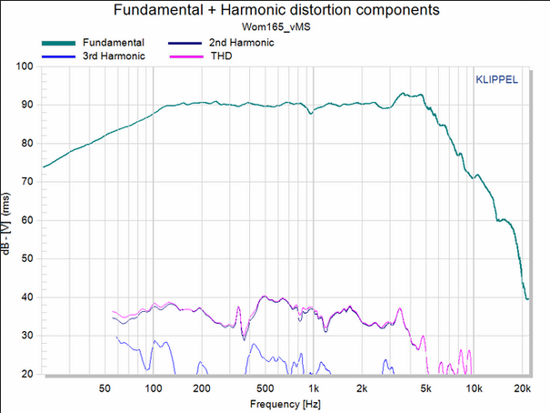

Hi HiFiCompass,
If you have the possibility to test one of the Kartesian Acoustic drivers,
that would be great.
Check out their Mid120_vHE, 5" 8ohm 91db and very linear
or Wom165_vMS, 6.5" 8ohm 90db
Most of their drivers use a hybrid cone material made of carbon and glass fibers,
that is 10 times more rigid than conventional carbon fibre.
Their drivers are available through TLHP
Danny
