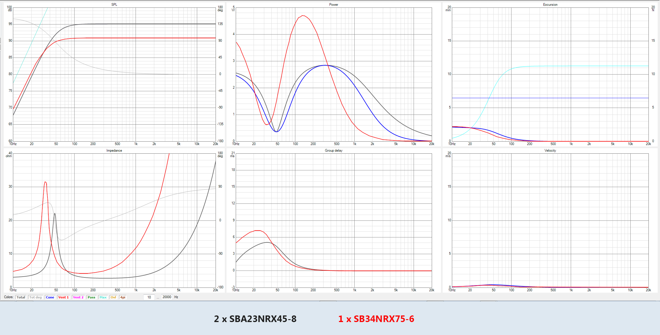

2 pcs SBA23NRX45-8 (Sd: 2 x 216 = 432 cm^2) - connected in parallel. Zmin: 2.8 Ohm @ 324.7 Hz
vs
1 pcs SBA34NRX75-6 (508 cm^2)
Box tuning = Qtc 0.707 for
Black graph is 2 x 8" and Red graph is 1 x 12"
+3dB = x 1.414 SPL
+6dB = x 2.0 SPL

Not really. There is a difference between driver performance, matching etc vs comparing the output of 1 vs 2, 3 etc drivers.
If you use 2 x 12" you will see similar "doubling" of the SPL like we see here. Its a common rule that doubling the Sd halves the excursion or at the same excursion but +4-6dB.
Another point is box tuning or the Qtc which also affect the overall output, sealed vs ported and so on.
My response was to show what happens when you use two smaller vs one large woofer with similar motor structure, relatively similar sensitivity.
12" (6 ohm nominal) = Sensitivity (2.83V/1m) 88.5 dB
8" (8 ohm nominal) = Sensitivity (2.83V/1m) 90 dB
The 4 ohm version of the 8" = Sensitivity (2.83V/1m) 92 dB but would not do well in parallel connection (Zmin 1.7 Ohm @ 386.1 Hz) so when used in series the resistance clime to Zmin: 6.6 Ohm @ 386.1 Hz and output drop to 91dB with a cone excursion of 1.1mm @20Hz.
The 12" compared to the 4 ohm version has the 2.1mm at 91dB output, so in the 2 x 4 ohm scenario (series connected), the SPL = same but excursion = half.
There, I hope that helps 🙂

The answer is yes. At the same frequency, same baffle shape, the drivers are acoustically close-coupled, etc., if you have the same volume displacement (swept volume of the diaphragm/cone), the SPL is the same. The sensitivity of the pair depends on other factors such as wiring.

The T-S parameters are only to help you design the enclosure for a specific transfer function (frequency response) in the bass region. They will not tell you what SPL a driver can reach.
To calculate maximum SPL, all you need is the volume displacement and at what frequency of output. This is easily calculated with a sheet such as this:
http://www.linkwitzlab.com/spl_max1.xls
Note that the calculations on that sheet do not factor in power compression, which is a phenomenon where as you add increasing power (voltage), the actual SPL gain is less than expected due to thermal-related electrical losses. You can do additional research on that regard on your own.
As to what is the true Xmax of a driver, it depends on what your design will allow. Many times, the Xmax on a spec sheet is at a higher distortion level than what you would like to tolerate.
