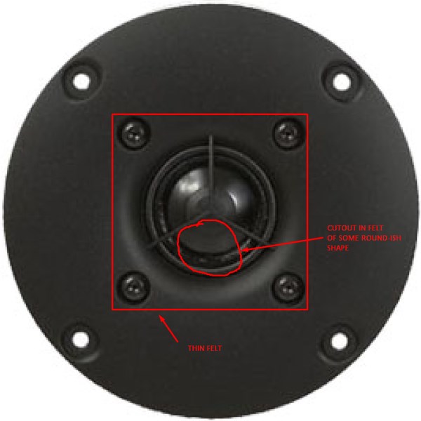

All I meant was this (see attached). The felt will act as an acoustic low-pass which will strongly attenuate the high frequencies being radiated around the dome. Those are the ones that combine destructively off-axis and cause beaming at the listening position. At lower frequencies, ideally, the felt minimally attenuates so you don't have excess power loss or added distortion.
The opening is so that you have a small radiating point that is relatively much greater in magnitude compared to elsewhere on the dome. This means you have what acts as a much smaller tweeter at high frequencies. Putting the felt across the entire tweeter will do nothing but low-pass the sound output, with no benefit to dispersion.
In theory, anyway... the reason why I said you need DSP for this is because it would be a pain to EQ the tweeter passband with fixed passive components, or even analog op-amp filter sections.

reminds me a bit of the tweeters baffle absorption which Audio Physic is doing.

Everyone should read the stuff here at least once (and the other pages on the same site): Felt Rings verses Felt Blocks for Baffle Diffraction Reduction
