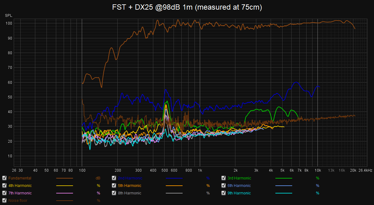

I see your point. This “resonance” is ever so subtle, and likely below audibility.
On the grand scheme of things level of importance is low.
Sometimes we just want to know what we are measuring
Eg.
Before-
Problem with driver?

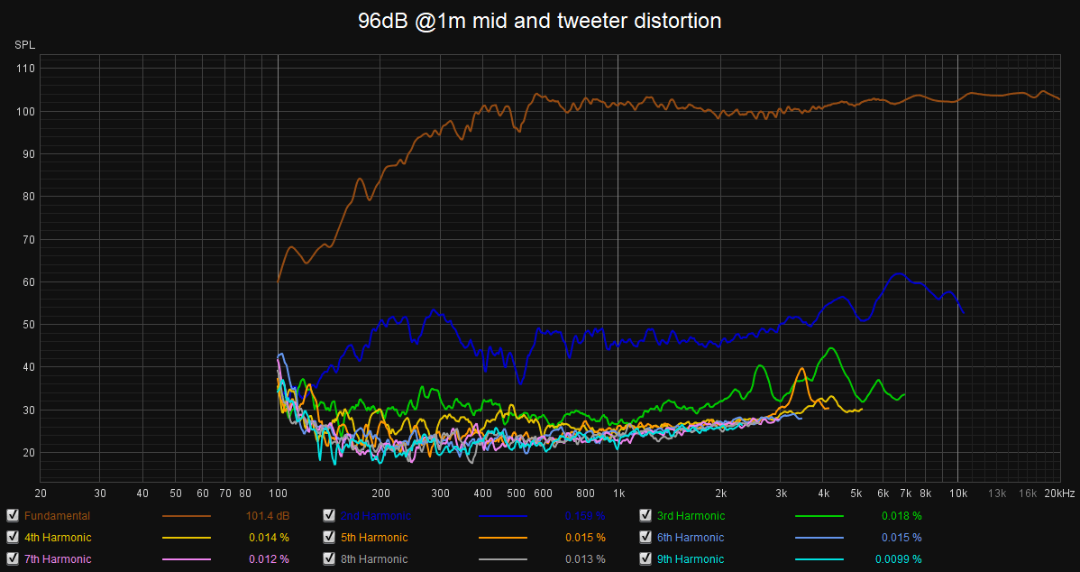

After:
Difference?
Viscoelastic material between frame and cabinet, and between screws and frame.
Answer: “problem” with mounting

From my past experience dry or wet mounting we called it then.
Simple example: vibrationsensor in M16 Bolt shape, mounted dry on large lathe to measure bearing noise was regardless of torque peaky . Mounting with some matter (some fat) in between the peaky behaviour was gone. We attributed it to the not 100% contact, in other words pockets of air in case of dry mounting. This allowed some movements and/or reflections between sensor and heavy lathe at particular frequencies
