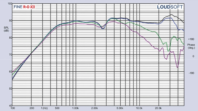

The measurements of the Scan-Speak D3004/606200 Textreme dome tweeter:
https://hificompass.com/en/speakers/measurements/scan-speak/scan-speak-d3004/606200

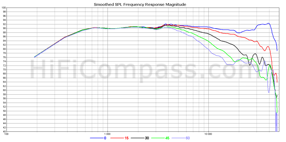

Strange how different your spl response is compared to Dickason... perhaps Dickason didn't mount them flush to the baffle?
https://audioxpress.com/article/test-bench-scan-speak-d3004-606200-tweeter-from-its-illuminator-line
They say "After completing the impedance measurements, I recess mounted the Scan-Speak D3004 TPCD diaphragm tweeter in a bookshelf-size enclosure that had a baffle area of about 11”x6” and measured the horizontal on- and off-axis at 2.0V/0.5m...."
So, it looks like we are seeing diffraction/interference effects from the front panel
Dickasons measurements are often ... inconsistent. This 2,8kHz dip doesn't come from the tweeter for sure, I would not publish such data, not even in a forum.

And of course "infinite" baffle as Purify does (one reflecting wall in a measurement chamber or a flush plate in the floor).
The dip is present on HIFI Compass and the manufactures data. Voice coil is more prevalent.Dickasons measurements are often ... inconsistent. This 2,8kHz dip doesn't come from the tweeter for sure, I would not publish such data, not even in a forum.
