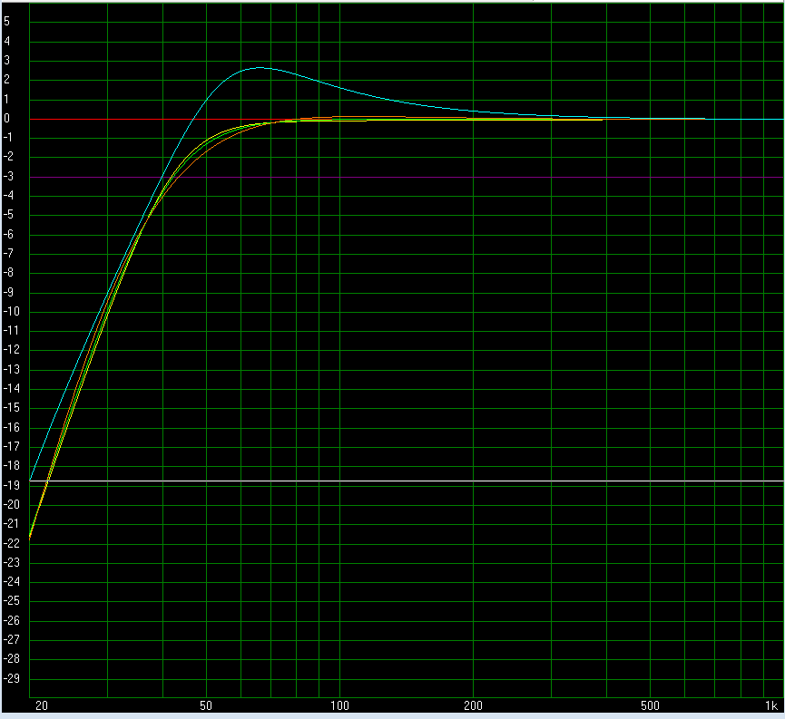

More about how important it is from a box/cabinet design perspective.
I have attached two graphs of a certain woofer.
The first one is a closed box, where I changed just the Cms to 75% (=10% distortion) and 50% (=20% distortion).
I also changed the BL to 82% (=10 % distortion).

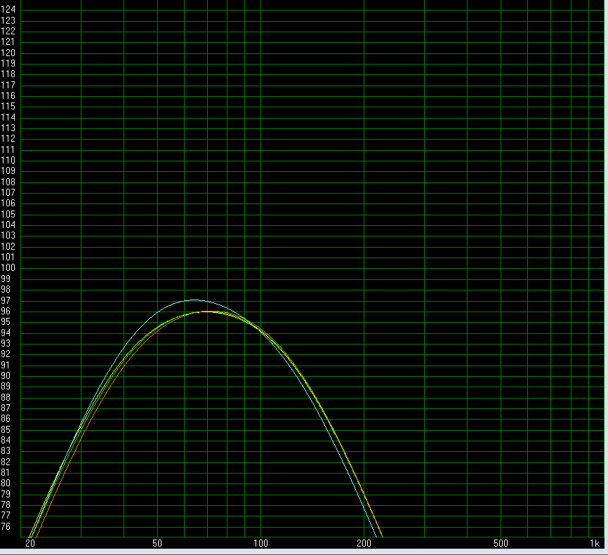

The second graph is the same idea with a BR system.
All other variables being kept constant. (volume, tuning of the port etc etc etc)
As you can see, the Cms doesn't have a huge impact, even with a change in Fs from 28Hz to 39.5Hz (dF = 11.5Hz) at 20% distortion (50% of value Cms).
But only a little change in BL (equivalent to 10% distortion) has a huge impact.
So from a cabinet design perspective, you would rather like to have a nice constant BL over Cms.
Yellow = original
Green = Cms 75% (= 10% distortion)
Orange = Cms 50% (= 20% distortion)
Blue = BL 82% (= 10% distortion)
Your simulation assumes that Rms is constant, but it is not. Rms increases as the frequency decreases, so Qms and Qts would not remain constant compared to the case if Rms were constant. BTW, you are absolutely correct that the box tuning is quite invariant to Cms.

That companies take a different variable that maybe suits better (also open for debate, but different discussion), is fine.

I totally agree, but this is also what Klippel assumes!!Your simulation assumes that Rms is constant, but it is not. Rms increases as the frequency decreases, so Qms and Qts would not remain constant compared to the case if Rms were constant. BTW, you are absolutely correct that the box tuning is quite invariant to Cms.
Nevertheless, in view of the non-linearity of the parameters, I believe that the most correct way to measure them under the conditions closest to those of actual operation
I have also an hard time beleving that Rms will stay constant.
That being said, it won't be as significant I think. (that's also what Klippel claims, although there is no data to back that up)
It will mostly have an effect on Qms. I have even experimented with this by opening up the motor structure more and more.
(by drilling and closing more venting holes for example)
As I stated, this is from a box/cabinet design point of view!!
So it doesn't say ANYTHING about non-lineairities and even less so what is better or worse.
But I think a 2,5dB peak (= different total Q factor) can be pretty audible in some cases.
Ideally, in the end both need to be good enough obviously.
