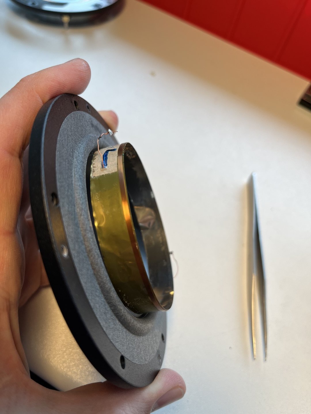

I got answer from Bliesma regarding the damaged driver. The voice coil was smashed - seems like 500Hz at 27V are mechanical to much ;-) With a crossover at 500Hz this would not have been a problem cause it would have been a few dB down already at 500. Thermal it wasn't a problem, as I thougt.
Exceeding excursion by accident?
I wonder if this is predictable with modelling prior to high power testing?
M74x-6 drivers have 1.2mm x-max...
Much like conventional tweeters, these domes are in sealed boxes, so SPL vs Vd is predictable.

As they are underhung voice coils I would have expected a higher Xdamage as 2,5mm. But maybe there was a tiny pop in addition with the start of the measurement signal? Seems like the ATC is at least more robust in this regard.
Nevertheless - when testing these extreme conditions failure can happen. Don't do this at home when you are on a tight budget 🤓
Therefore I wanted to report here about my abuse so nobody needs to repeat my brute force approach 😉

Stas is very gracious and helpful in emails. However I'm under the impression that Bliesma is deliberately obfuscating the power handling capabilities of their M74 series of driver. It seems odd that although there are many established industry standards for determining power handling, Bliesma does not disclose a rating for their drive units. I believe they have working on their own technical paper on power handling, but have yet to release it.
It may be that the single suspension is causing problems during a such a large mechanical displacement, and together with the extremely tight gap tolerances, may have induced minor rocking modes that caused the coil to jam within the gap momentarily, (together with the huge motor force) leading to the former deformation. This is just sheer speculation and it may well be that the former did indeed hard bottom (although that would frankly indicate a rather poor design choice, to leave such a short headroom for overexcursion). However if it was a hard bottom, you would surely have heard an audible clack from both drivers as well?
