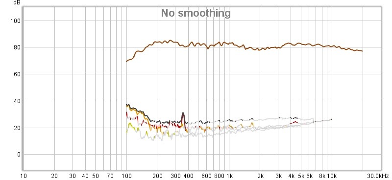

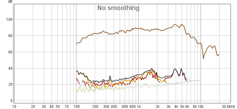

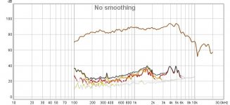

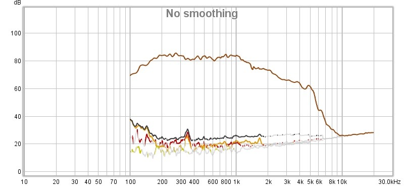

Here's what I'm getting out of 6ND430 and a Wavecor TW030WA11 measured at 12" on center crossed at about 1800hz. I had to use 10db increments because the distortion comes out too low for 5 DB. The 350hz peak is the table vibrating not the speaker. The raw response is pretty close to manufacturers data. I use an active crossover at about 300hz to a TD15S. Distortion on this pair is a little higher than the horns I use.Throwing out some ideas... ScanSpeak Revelator 18M4631T00, an older design but still very relevant. Eighteen Sound 6ND430 is another one. Its a short list !

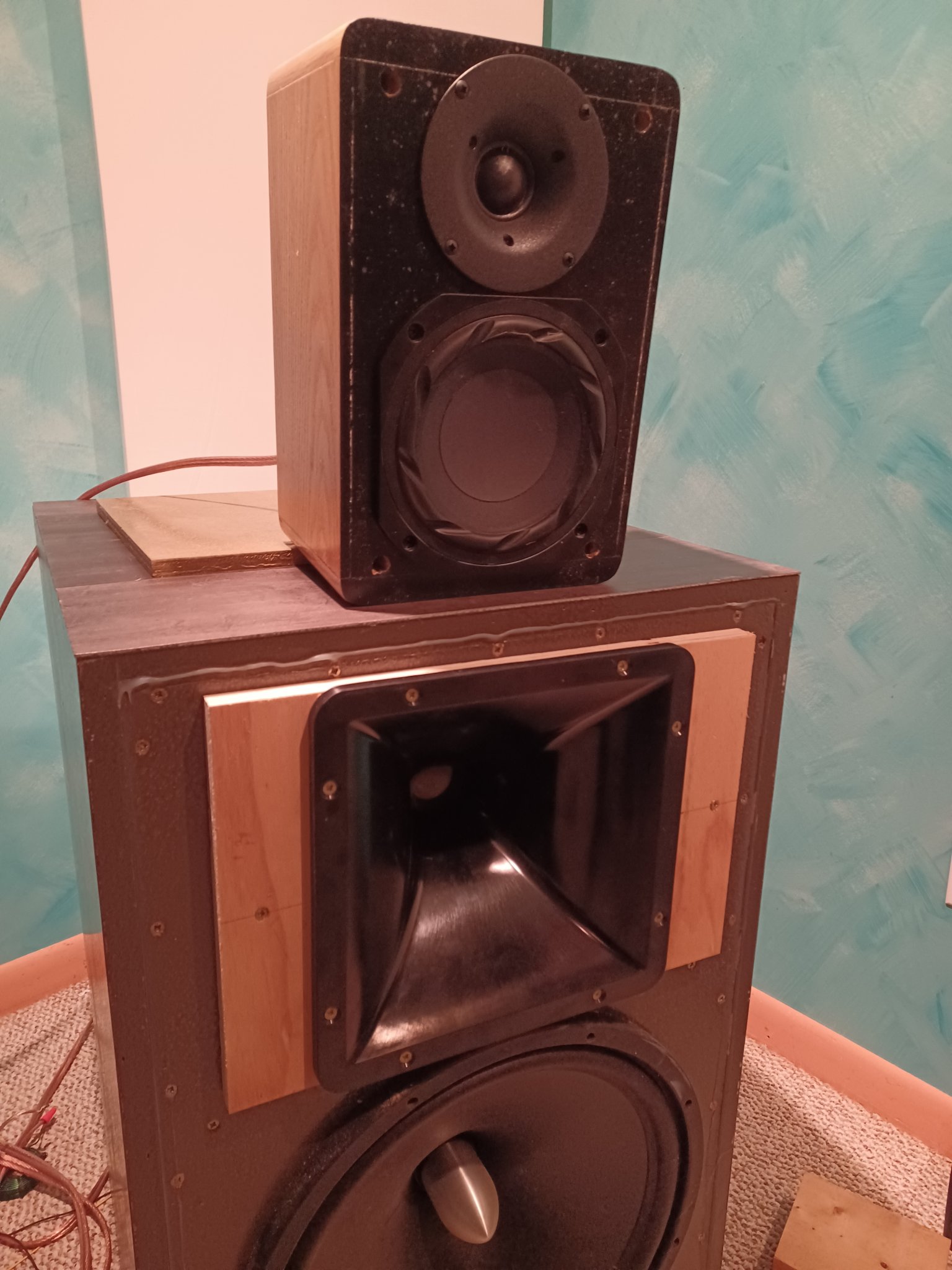

The box is an old MCM prebuilt I've used for many different ideas. Once I figure my final direction, I'll recut the front baffle and integrate the system into one box.
I went in this direction due to natural issues with the bass box and woofer. The box has two internal nodes at around 300hz giving me a dip in the response and phase glitch at around 300. Second, the woofer has the typical cone\surround interaction resonance giving a dip or peak at 450ish hz depending on the measurement angle. There's also a slight distortion peak at 450is but a distortion dip at 300ish. Keep in mind the distortion peak is still well under 1% in fact it's under 1% at deep bass frequencies at loud levels. So I choose a device that'll keep up with the woofer and cross just below 300hz. At the time the 6ND430 was a top contender and still is.
The tweeter is simply an all around great tweeter. Easily used over a range of cutoff frequencies. Any cutoff needed from 1500 on up can be designed with a reasonable network.
The rise in response makes the 6ND430 a little harder to use and to obtain a nice frequency response I ended up with a simple 2mh 20 uf crossover. I little lower than I wanted but anything else I simulated or measured is worse. More complexity didn't show improvement. So I stuck with the simplest crossover design. One of my goals was to use each device within it best operating range. To get best overall frequency and phase response I'm pushing the tweeter below it's 2200 sweat spot. Keep in mind the distortion peak at 1500hz ish is still very low.
Sonically it's neutral. Very good sound stage, imaging and immersion. Individual instruments have very good detail. Vocals are a little recessed (compared to the horns) but have almost no artifacts. It's hard to hear Esssing, Tching, tiz or sizzle. If I hear any artifacts I now blame it on the recording. LOL Vocals sound deliberate, articulate with inflections intact. It's very listenable and at moderate to loud levels without fatigue. Dynamics again are very good. Punch is a little fuller than the horns. The horns have a little sharper snap, It's hard to beat the dynamics a 3" diaphragm horn brings to the system. Treble sound more extended than the horns and clean clear and BIG like cymbals sound.
The horns do bring a little more high frequency dynamics and a little different punch. Also, more forward vocals. And sometimes seem a little more immersive. YMMV

TBH I don't know for certain because I don't have a calibrated SPL meter. The calculated reference efficiency is 91.9db I was wrong earlier. I use a two ohm resister to level match the Wavecor which is a 4 ohm version which is 94 db I'm guessing the final sens is 91db and it could be ond db higher or lower.
I just looked at the other midbass units linked. Their measurements for the 6ND430 are similar to mine. The Monocor looks hard to use the others easier.

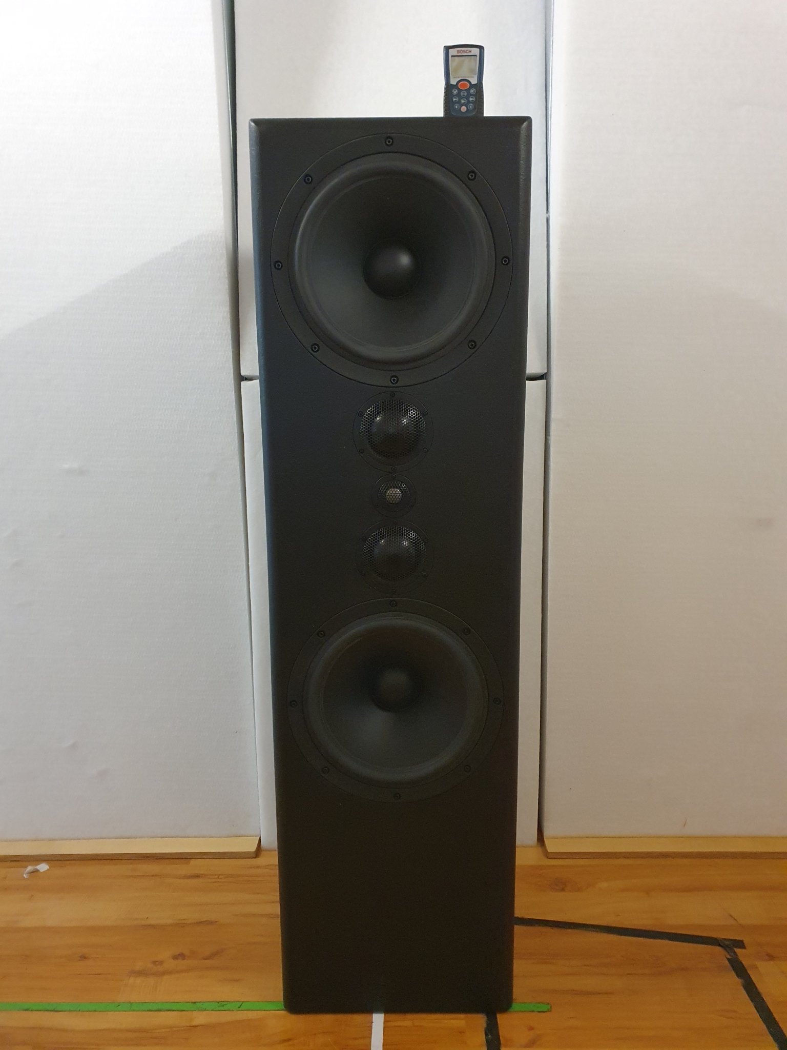

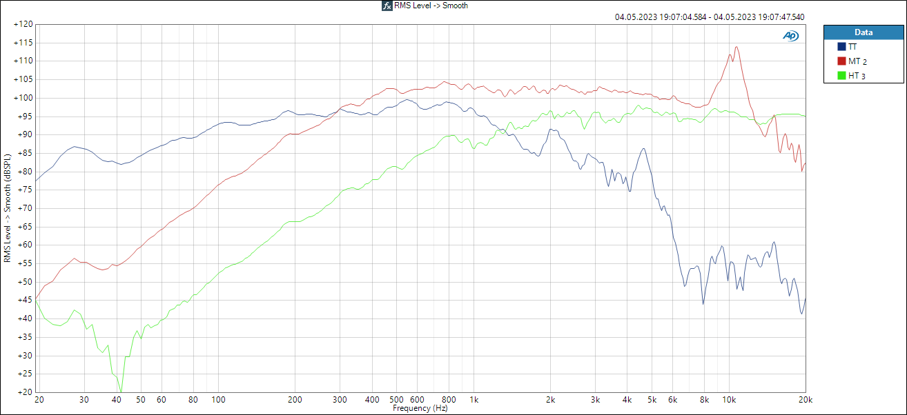

I'm working on a new reference measurement speaker for a customer, now in prototype phase.

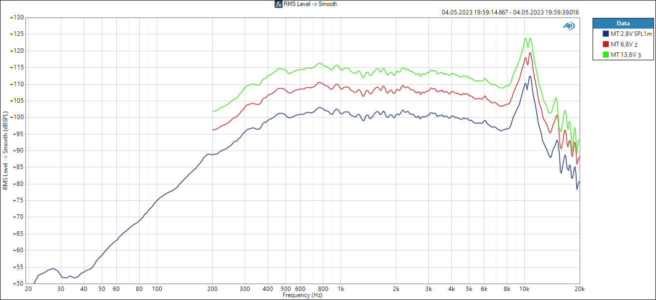

I destroyed a Bliesma M74A midrange driver during my tests ... so this measurement data was expensive. 😵
(1s sweep from 500Hz to 20kHz at 27V - about 125W. I thought the 3" coil should be able to take this, the 2nd one is perfectly fine. Contacting Mr. Malikov at the moment, let's see if this was a faulty model. But >120dB/1m IS pretty loud ...)

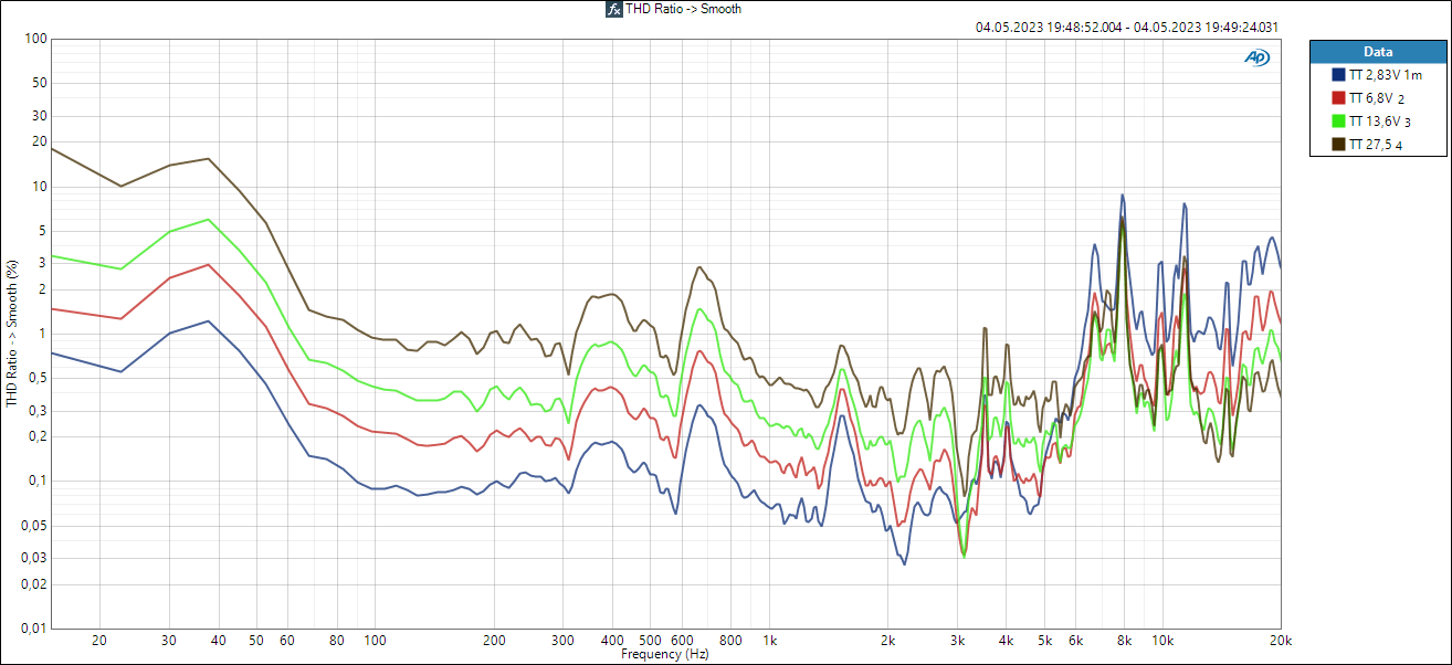

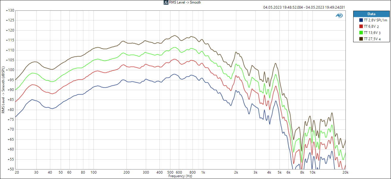

Measurements in 0,5m but SPL level calculated for 1m distance. At low frequencies you have room influence, windowing is 0,5s.
Frequency response of the 3 ways at 2,83V.
SB34NRXL75-8, 2pcs in parallel:
Bliesma M74A, 2 in parallel:

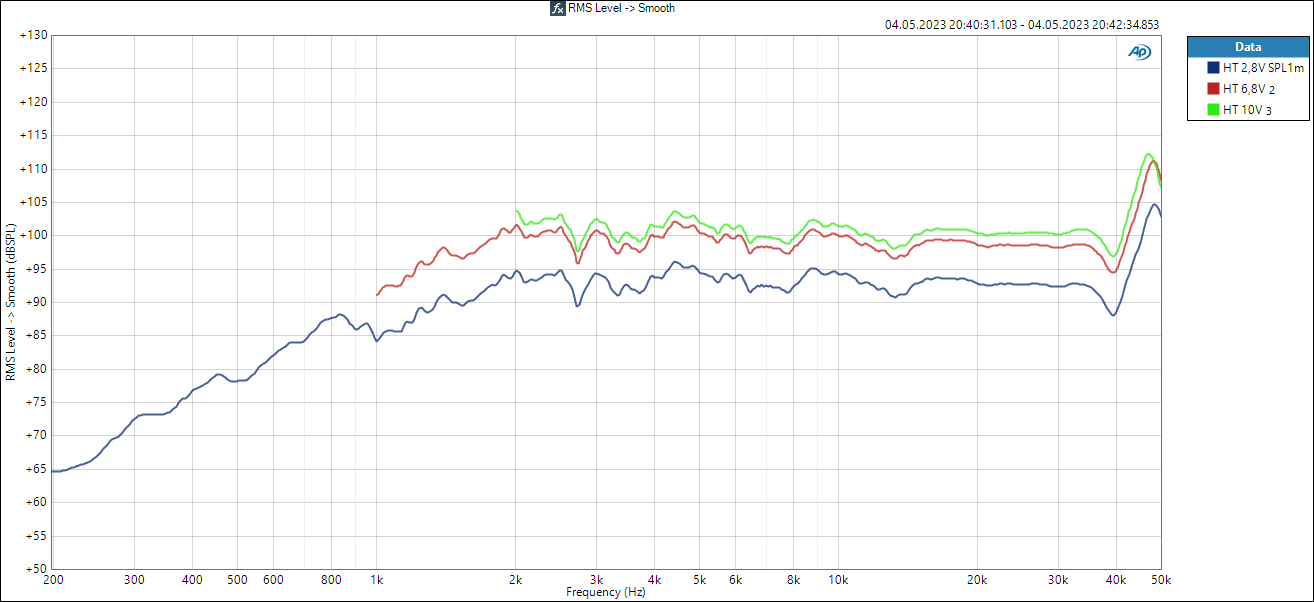

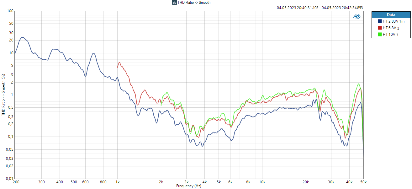

And Blisma T25B: - scale up to 50kHz!!!
After my experience of destroying the 3" I was gently with the level - normally it should take higher voltage for 1s.
Looks like an easy match for the crossover network.
The only sad thing with this project ist - this speaker will never play musik. It's here for sweeps from 16Hz to 100kHz only. 😢

Seems like an expensive tool to make sine sweeps...The only sad thing with this project ist - this speaker will never play musik. It's here for sweeps from 16Hz to 100kHz only.
Hopefully some kind of speaker for scientific use that talks to plants or something, cause damn. That's loud and expensive.
okay, please be careful with measuring tweeters with long sine sweeps or even long MLS signals.
Real music is dynamic in nature and does not stress midranges and tweeters like long test signals.
If you must do testing at 110+ dB/1m, keep the signals short eg. Closer to 1 second second, not 10 secs. And give plenty of time to rest (eg. >1 min) between sweeps.
The dome/cone excursion May handle it but not the voice coil. Otherwise you will let out the magic smoke.
Eg. Doing sweeps at 2.83V, and stepping up the voltages to 20+ volts with long sine sweeps to stress test the driver… well… consider that a scientific experiment to determine failure point.
Ask me how I know (but did it with a €30 driver not a €300 driver). You can do it with a €3000 driver that not my business but just be aware that the problem remains the same.
Once is an accident; twice is foolish…
Are you able to disclose more?
Did you hear that (no pun intended) that MRI Brain datasets was used to train AI? So we (humanity) can figure out how humans can recognise words?
https://arstechnica.com/science/202...bility-to-recognize-what-the-mind-is-hearing/
