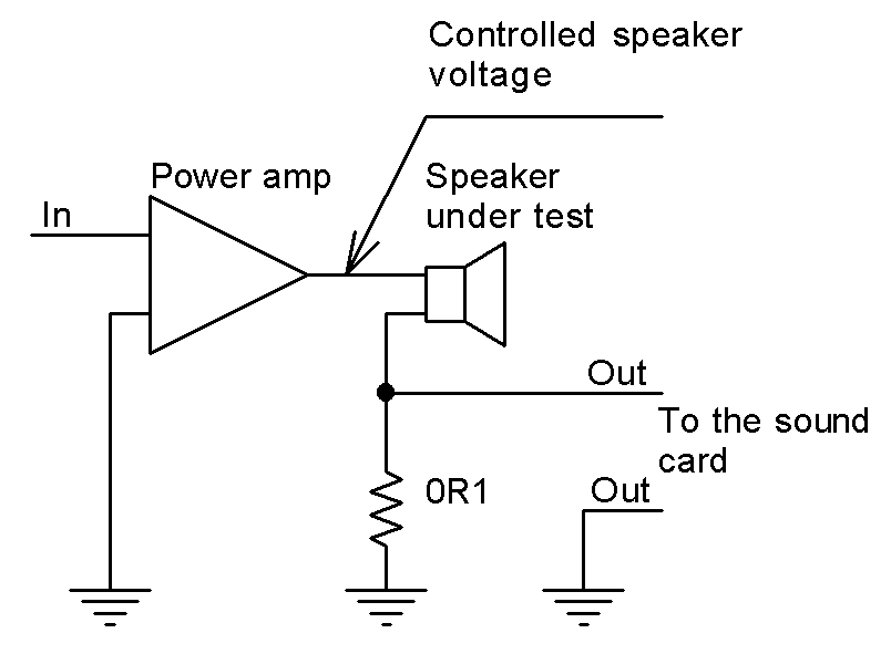

Can you please provide some additional information and preferably a schematic how you do your voice coil current distortion measurements? I thought you had some information on your website, but I can't find it anymore?
I would like to cross-correlate some measurements myself. 🙂
