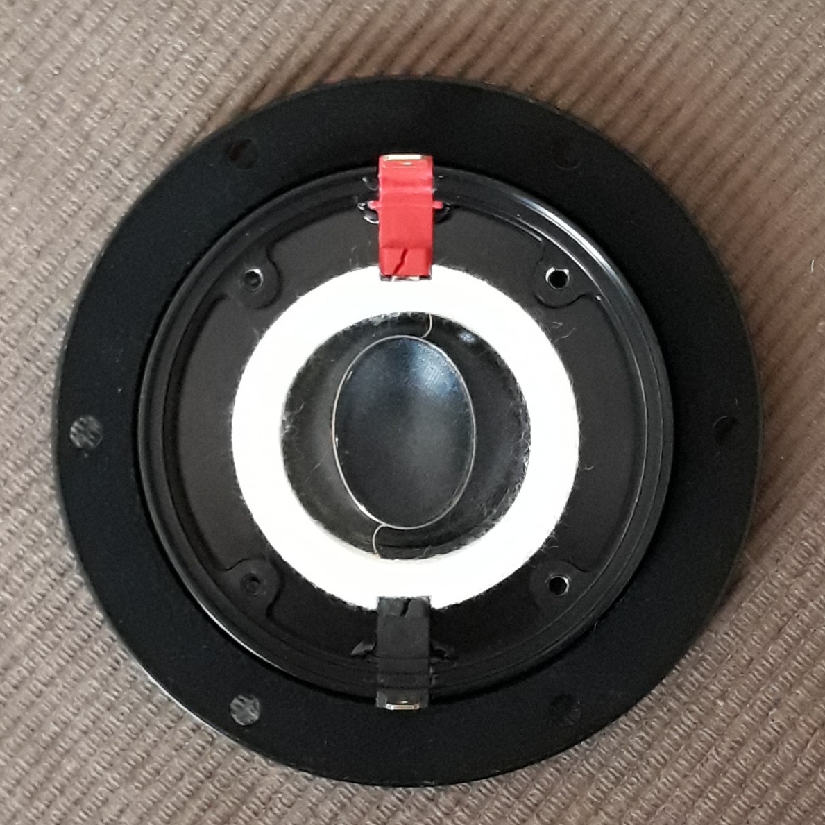

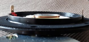

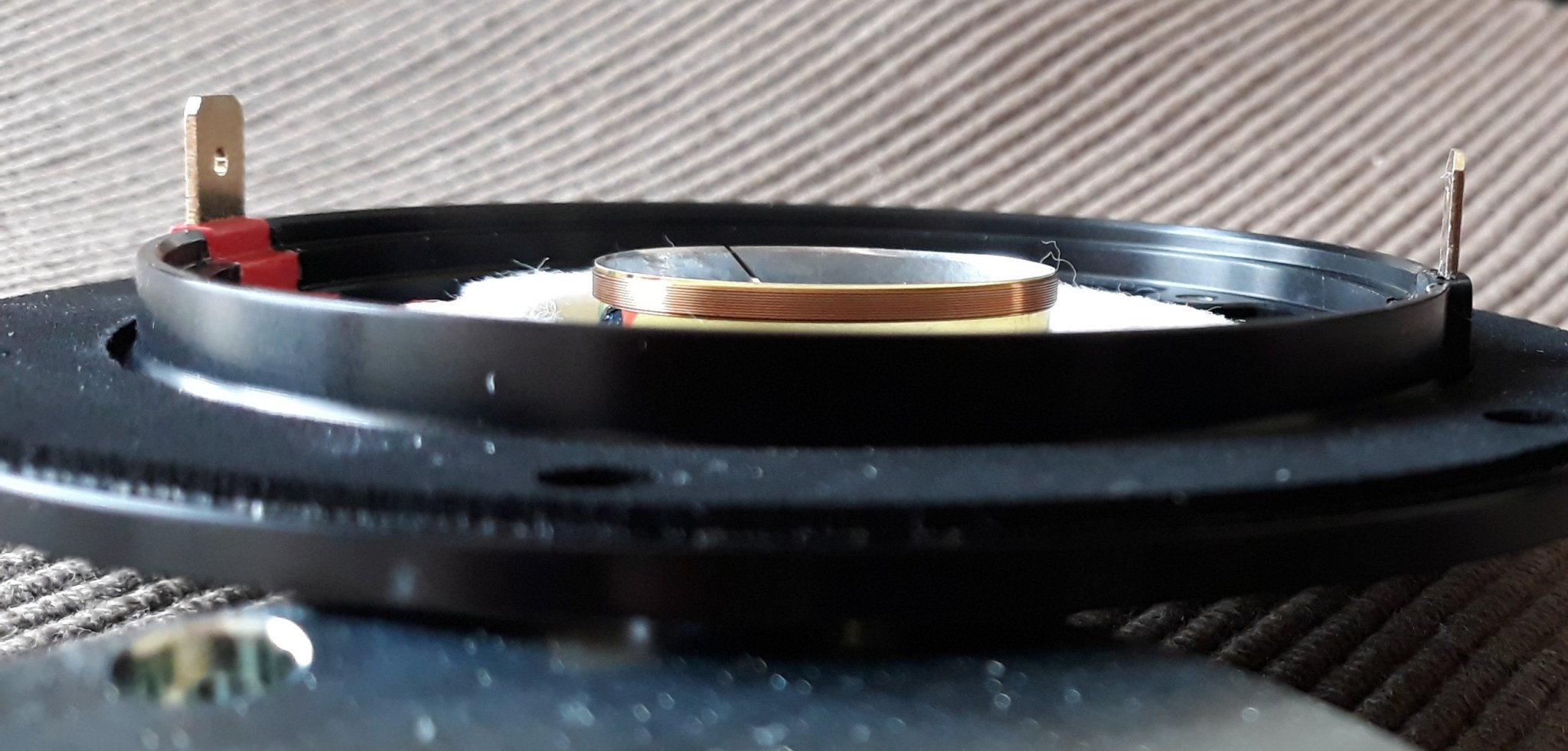

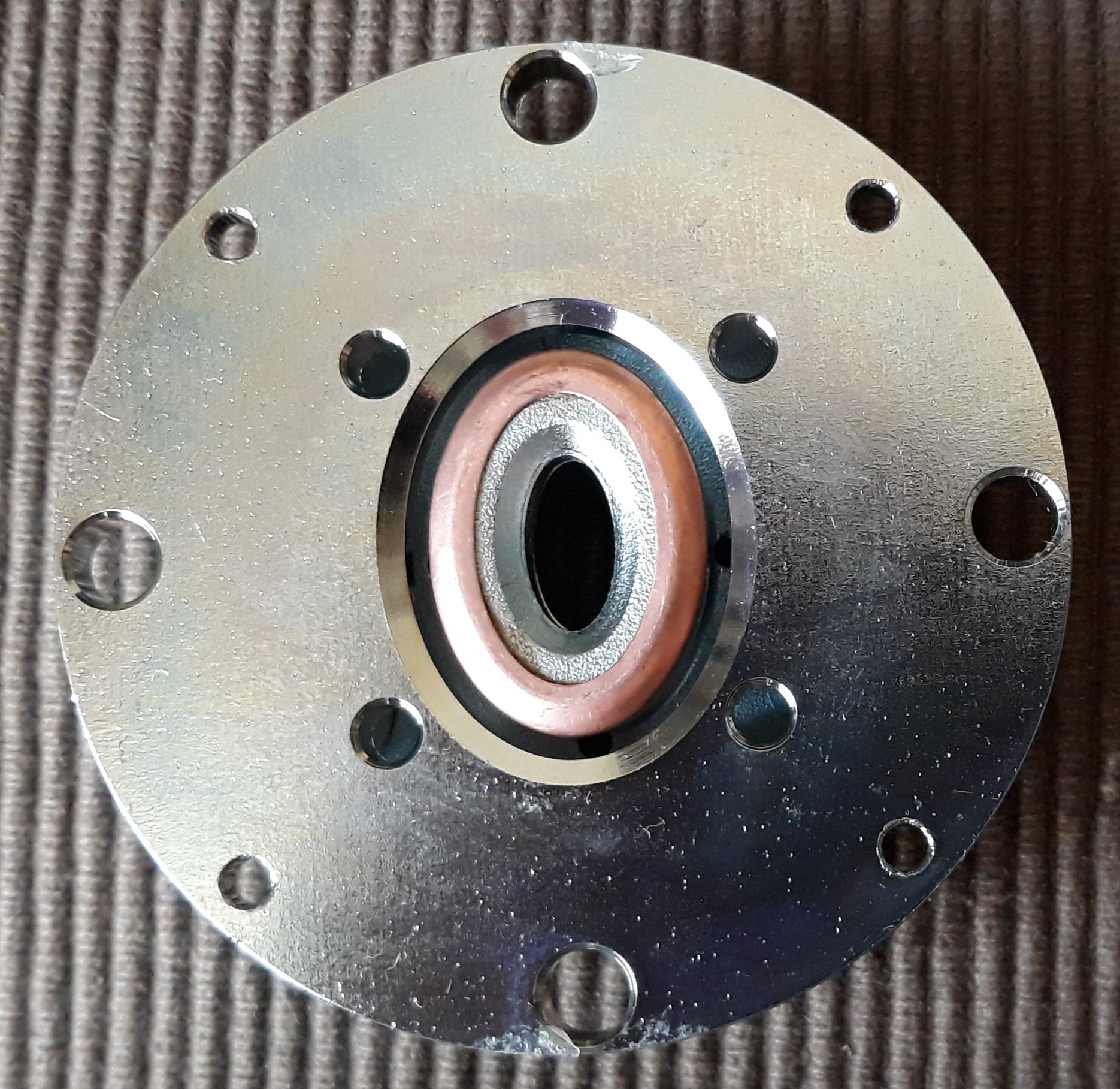

I understand what you say about. No, the problem in both tweeters is in the voice coil rubbing, certainly. I spent a lot of time trying to fix this problem but without success.
The reason is the axis of the elliptical voice coil doesn't match with that of elliptical motor. There is an angle between them about of some degrees.
Moreover, the voice coil edge has a bit of propellerness.

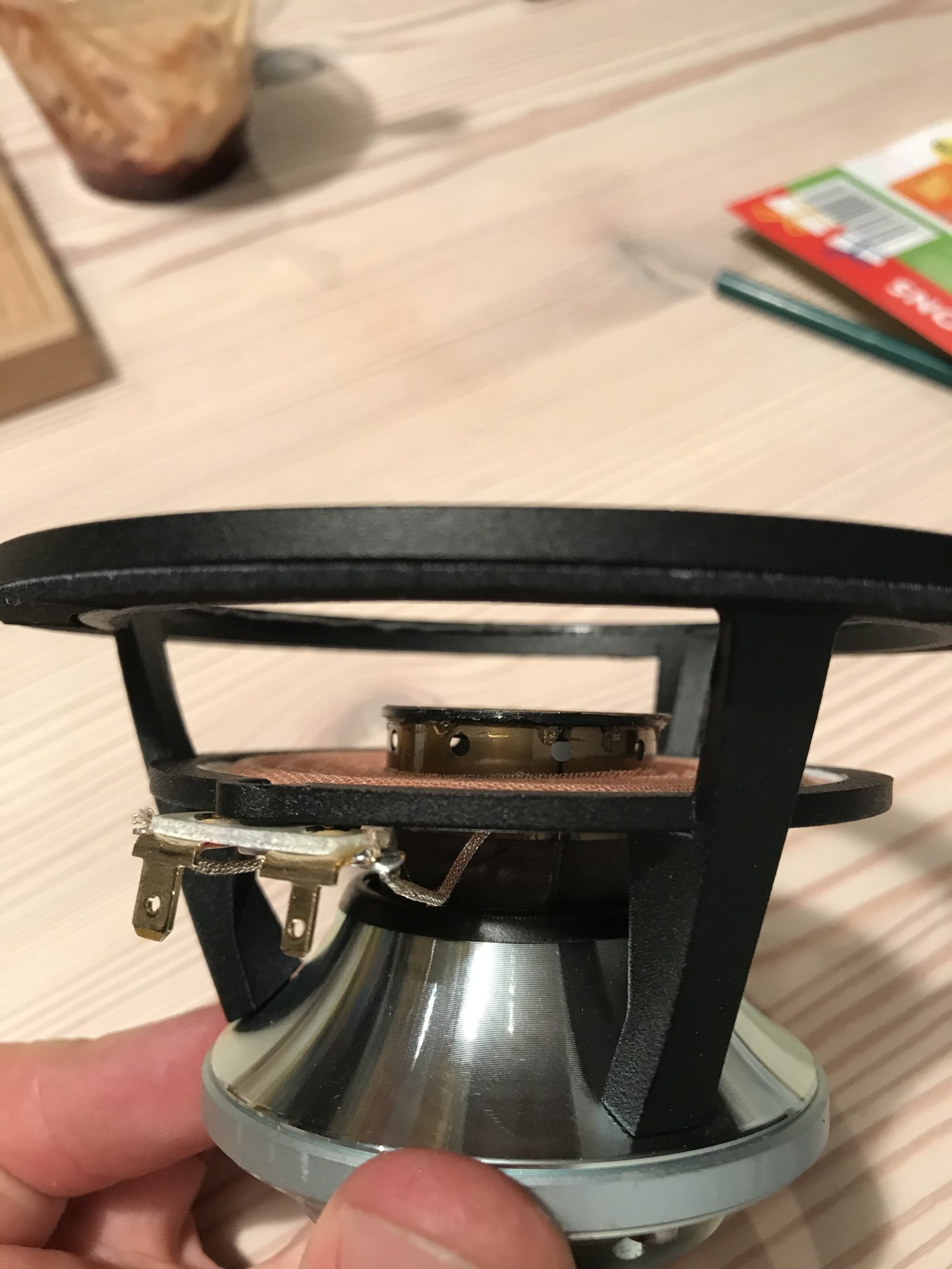

Another high value driver from Lavoce! A 6" high sensitivity midrange with fairly smooth FR and good distortion. Shame about the non-circular frame.
The circular framed MAN061.800 must be quite good too. (MidrangeAluminiumframeNeomotor 6" driver, 1.8" voice coil)
I had a angled voice coil recently with 12mu, quality control issues.
