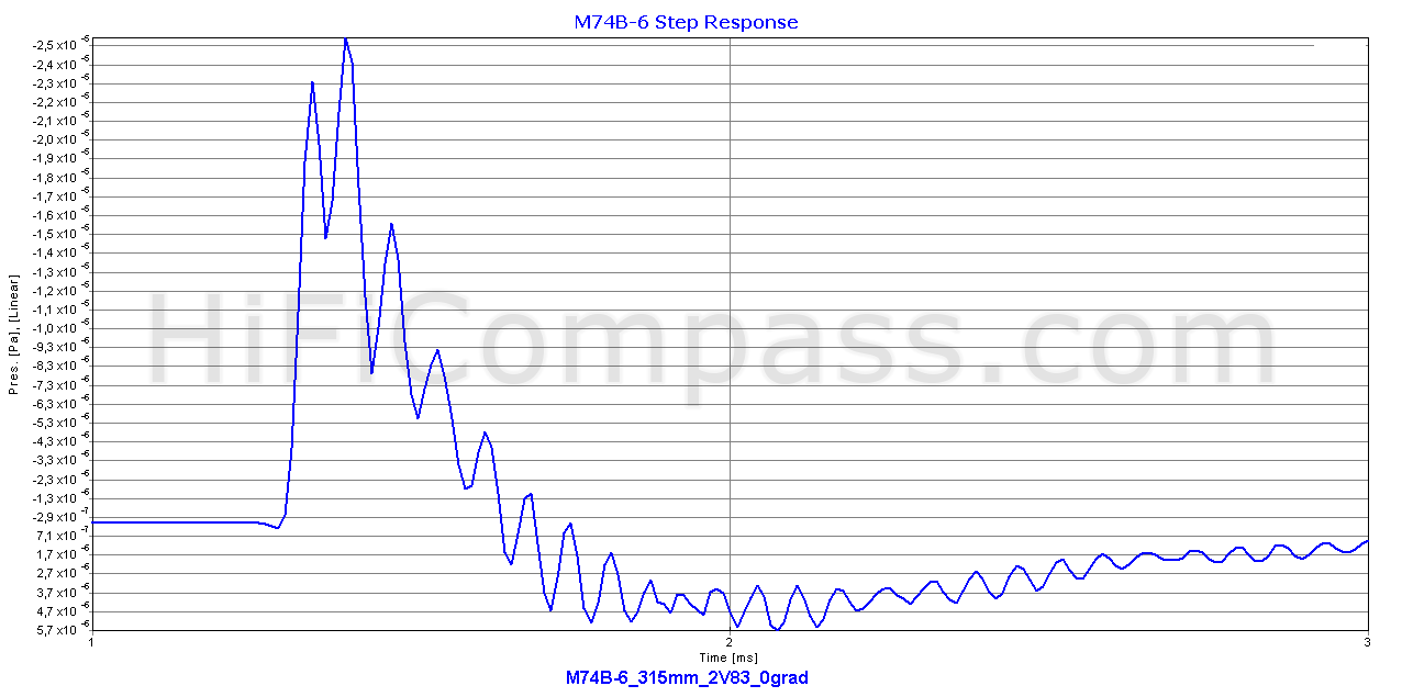

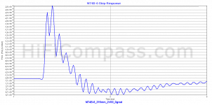

IMO the wrong angle is thinking any one driver is perfect. They all have flaws. The Be M74 has a double hump in the impulse. The Fan 30.71 has a slow decay in the midrange. (edit: i should say though... a damn good value)I was certainly inspired to write about which drivers to use, based on their dispersion, and upper and lower limits in terms of distortion, to select a suitable crossover point. Which is clearly related to directivity. So I don't think we're completely off topic.

Can you post that impulse plot?The Be M74 has a double hump in the impulse.
I think he means the step response as there was no Impulse response graphs in the review.
There is also this useful paragraph included which is very relevant
"Of course, the transient response of the silk version looks the most beautiful of all, against which the rest of the curves bear a strong imprint of resonant frequency response bursts. With proper filtering in the crossover, all these ripples disappear and the curves will be very difficult to distinguish, so you don’t need to give it an increased value . After all, the transient response is only a direct mirroring of the frequency response."
Yep, basically anything with a rigid cone resonance is going to have a jaggy step response. I never look at them anymore.I think he means the step response as there was no Impulse response graphs in the review.
