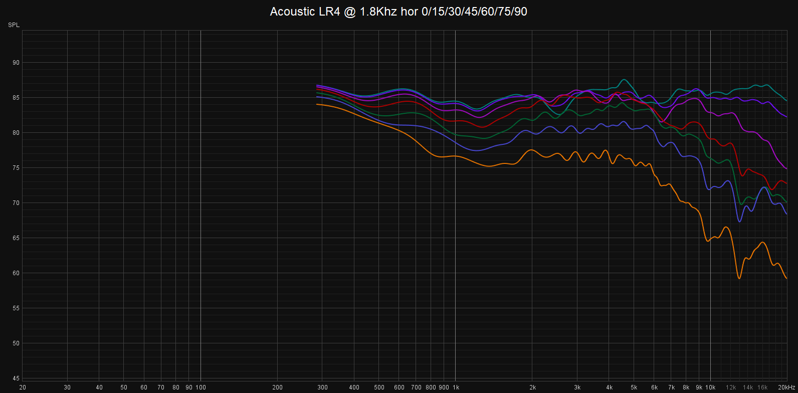

Here’s measurements from my prototype using what I had laying around (old boxes and old tweeters- so baffle dimensions, driver placement, CTC distance, cabinet volume and port tuning were all fixed) prior to crossover work.
but still fairly respectable on axis and horizontal response… out to 90 degrees:
https://www.diyaudio.com/community/...er-speaker-builds.352063/page-47#post-6821857
I agree with Pida. T34A/B for a 2 way sans waveguide, if you want to go with a dome…

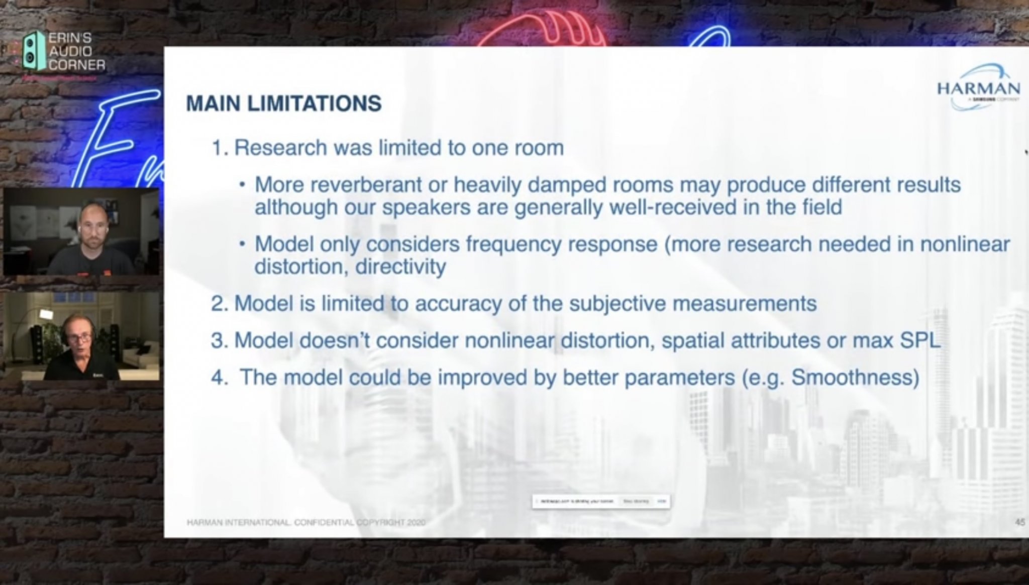

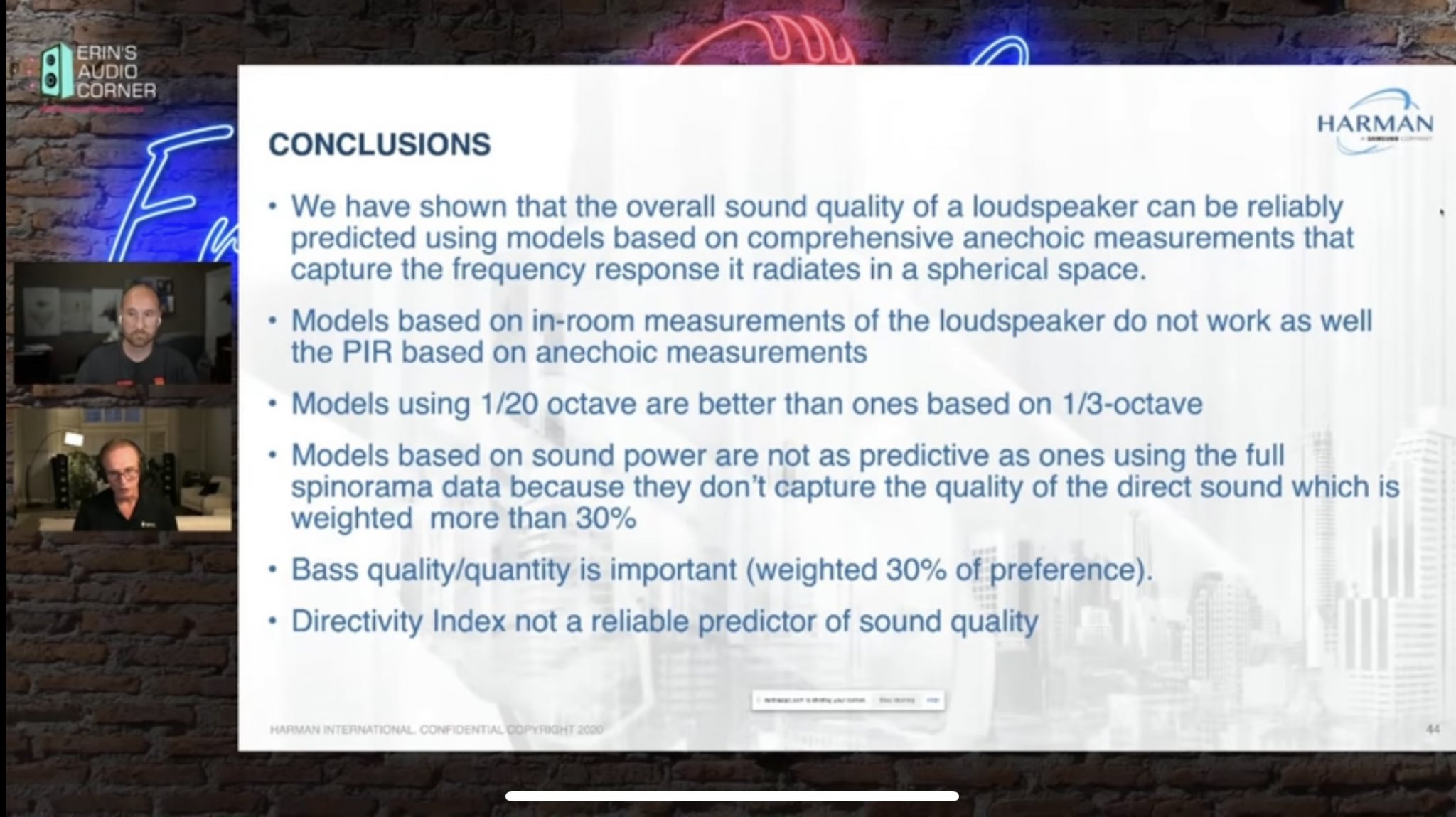

can you point to the evidence of this statement?
It’s not even clear if, in real rooms, directivity is correlated with listening preferences in double blinded studies.
Point to evidence?
It's an intrinsic result of an higher directivity index?
But in general I would recommend reading Sound Reproduction by Floyd Toole.
He showed very well that directivity is one of the main factors of sound quality.
Earl Geddes showed this as well.
They both have done plenty of double blind tests.
So why this little snippet says it's not, I don't know.
I also don't know the full context of that screenshot since Erin himself knows that a good and constant directivity is very important.
Also it seems to be from Harman?
Which makes even less sense since Floyd Toole worked in behalf of Harman.
If you're talking about if an higher directivity index is preferred?
I never said that it's always the case.
A technical good in-room response isn't the same as listening preference.
An higher DI will give you less reflections and reverberation by definition.
If that's desirable totally depends on the type of room and how well the room is treated. It also depends if one prefers detail or prefers spaciousness.
It also depends on the amount of listeners.
Btw, maybe we could ask the moderators to split this of to a new topic, because it's getting heavily offtopic?
Toole did not test directivity index (how directive the radiation is) and listener preference. In fact, he mentions that is one area that needs more investigation. Now smoothness of DI is something that is part of their preference metrics. There is some reason to doubt high DI always wins. There was a well known series of listening tests of the Revel Salon 2 vs JBL M2 put on by a Harman dealer. Toole participated in one. The Revel was preferred at all events. Not by huge margin, but preferred nonetheless.
Right, that's why I added another reply, because I realized that's what he probably meant.

It’s been shown that smooth and uniform DI is preferable. Also that smooth on-axis response is preferable. Fairly easy to conjecture - if not already proven - that a good sounding speaker has to have smooth DI and frequency response across the listening window. Does it need to have a high DI? I think b_force is right to ask for evidence on that, which hasn’t been shown so far.
I should point out that all of Harman's (Olive and Toole) investigations about DI and power response, and therefore the conclusions about smooth DI and flat on axis frequency response were compiled using direct radiator loudspeakers in boxes. I build dipole loudspeakers and I find that the flat on axis response sounds too bright in a very obvious way. It's only when I tilt it down by about 6dB per decade using EQ that did the tonal balance start to sound "right". I based this EQ on some of the work that Olive and later Toole published on preferred in-room response curves (e.g. see Toole - The Measurement and Calibration of Sound Reproducing Systems JAES 17839, section 4 - Small Sound Systems). This might be due to the relatively constant DI of the loudspeaker when equalized for flat on-axis response compared to other types of loudspeakers, and so to achieve a similar DI the dipole loudspeaker must have its on axis response tilted down. Just a guess on my part at this point.
I think their early research used the Quad dipole speakers. But yeah, certainly not a large sample or more modern designs. Interesting to hear your thoughts on the on-axis response. I have a dipole I want to build and this was always a question in my mind. I don't see it talked about ever, but my thinking was exactly your experience: the in-room response at the seating position should be sloping, and with a good dipole this would require the on-axis also be sloping.
