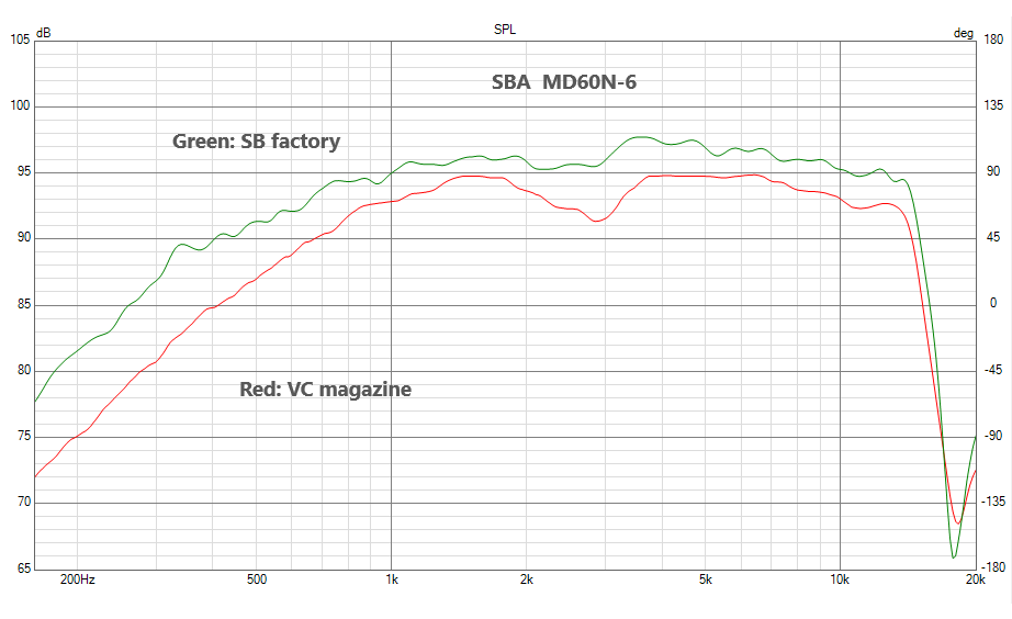

Hificompass has the original SBA datasheet hosted on his website. The impedance and frequency responses are different, as Marvelaudio mentioned.Probably nothing other than the chamber stuffing. Neither have impedance plot similar to what Hificompass measured, so unit to unit consistency may not be great, but we'd need to see at least an impedance plot of more than 1 unit to confirm that.
Is it enough to save this 2.5" dome in 5" faceplate? I dunno...

It looks better than the original, or preliminary datasheet.
Good dispersion to 3Khz (@45 degrees, only -2dB down)
He measures on a 15x6" baffle this time, which is great thanks for letting us know what happens on a real baffle (yes that dip at 3KHz is baffle diffraction effect) but Vance why did you only show use distortion (which is very good) down to 1KHz .
I'd like to know the lower limit- how close can it get to eg. 500Hz?

Why do you think there is a 'new' version? The one hificompass tested was a production model, but the datasheet was for a prototype, and he noted the discrepancy. Quite likely all they did was update the preliminary datasheet to the final production dome numbers.Maybe this driver is designed for hornloading ... btw before buying how does one know if it is the old or new version?
I have 2 PDFs , one saying Prototype Data and is marked as Rev.0 (06.05.2019) and the other is the actual one from their website stating NEW / NEW PRODUCT in big fat RED letters! (dated as Rev.5 25.02.2022)

I just read the review, not the most useful one I've seen in VC. Distortion measurements only taken down to 1khz for a midrange?
It does show the same hump in H3 ~1.1khz that Hificompass measured, so I'd bet the H5 hump is still there as well. The impedance peak is sharp and even higher than the 'sample b' hificompass measured, maybe ~490hz or something. A ways off from the 'new' datasheet value of 400hz.

Fair enough; my conclusion is that there was a preliminary datasheet and a final datasheet, all for one product. The product appears to have some QC problems with the damping of the rear chamber. It isn't sold in matched pairs, so you'd be wise to ensure you can measure and deal with inter-sample variance if you plan to use it in a passive speaker. To me, it seems like wishful thinking to hope there's a new, much-improved version of this driver on the market, absent any evidence other than two versions of a datasheet, one of which is clearly marked prototype.

They should have just gone with a large well damped rear chamber, no struggle in production with that, and probably not much differing in driver performance over the resonant tube.The impedance peak is sharp and even higher than the 'sample b' hificompass measured, maybe ~490hz or something. A ways off from the 'new' datasheet value of 400hz.
I suppose I should be thrilled that Fs is off by only 90Hz, I have four Morel EM1308, Fs in the datasheet is 320Hz, reality is 600Hz+., and unfortunately the chamber in the Morel is glued shut, so there's no ability to modify or adjust the damping without destructive modification.
Wow, that's quite the discrepancy! I must admit I've not measured enough large domes to know; are mid domes out of spec this way more often than tweeters? I would have thought the margin for error on tweeter back chamber damping would be smaller, hence the error rate would be higher.
