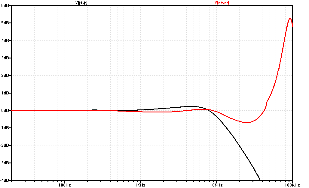

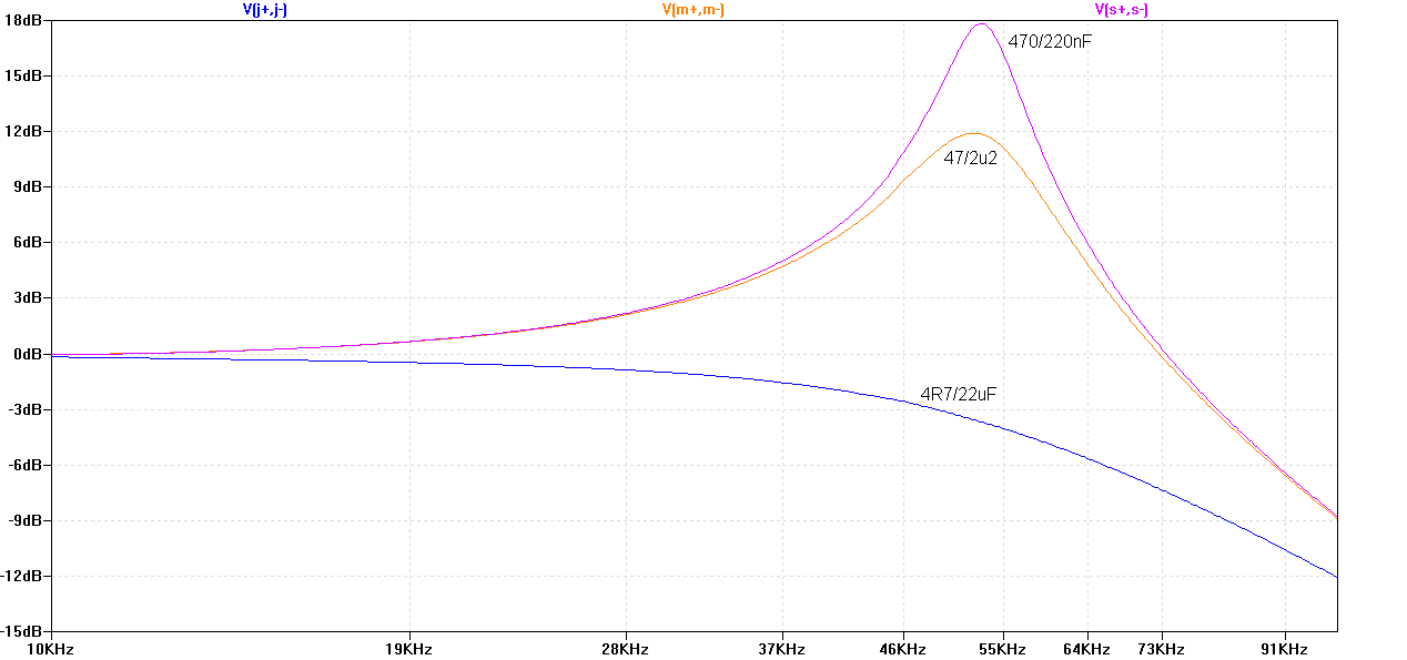

That doesn't seem to work:
attachment.php

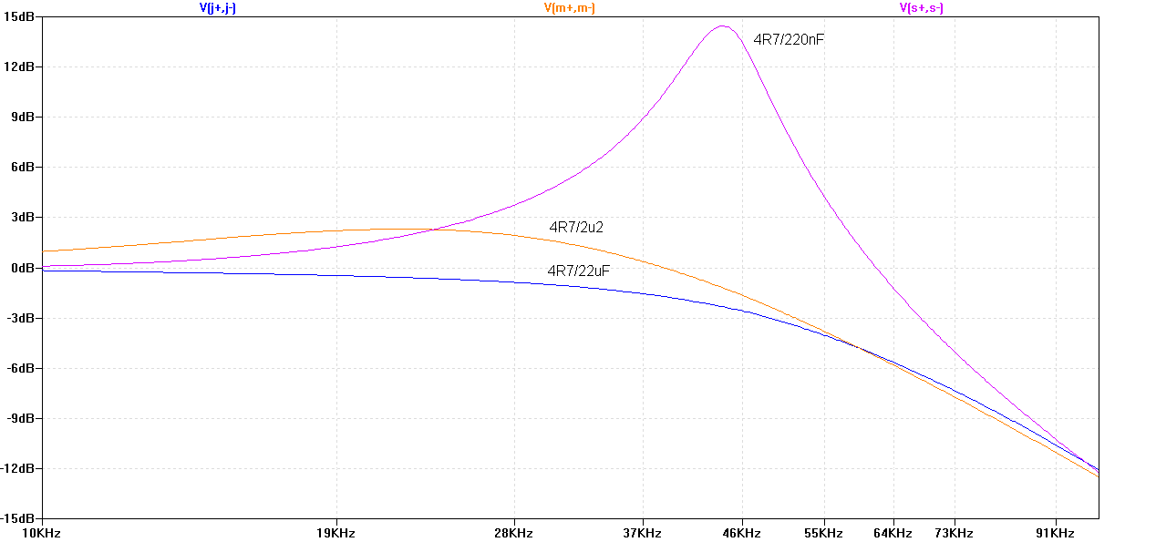

A highish resistance of 470 Ohms is like an open circuit (i.e. it doesn't have any effect), regardless of the capacitor used.
The low resistance value seems to be important. This is what happens when I leave it at 4R7 and only change the capacitor:
attachment.php
There must be something more to it than the time constant (which is around 1.5kHz for 4R7/22uF :confused:)
These plots were all done with the S6 speaker model, don't let the labels mislead you.

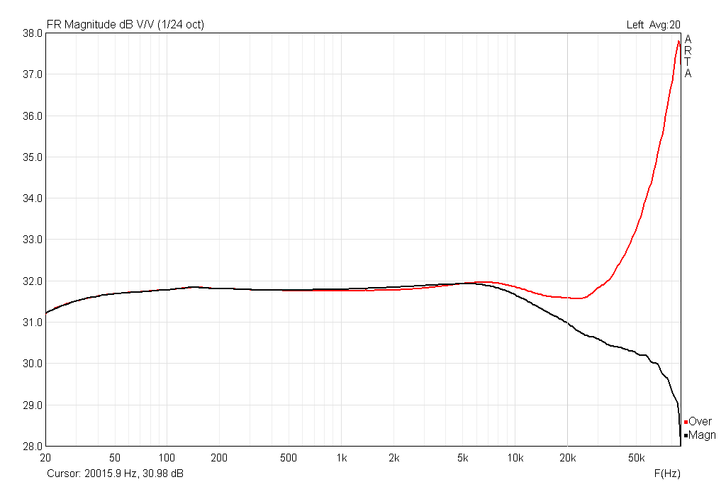

Here's a first frequency response test with a blue "Sanwa" TPA3118 board, powered by a 19V laptop brick. The JVC speaker and model were used for this test.
I probably cheated a bit here, but maybe not. The simulation was done with 10uH and 400nF on the output filter, to achieve a peak around 90kHz, like in the real-world measurement. The actual ceramic filter capacitor measures more like 800nF in-circuit, but due to it being ceramic, it might have less capacitance with the output voltage applied. Apart from that, the graphs line up pretty well I think.
Red trace is speaker-only, black trace is with an added Zobel comprised of 4R7 and two anti-serial 47uF electrolytics.
attachment.php
attachment.php
I'll make some THD measurements soon.

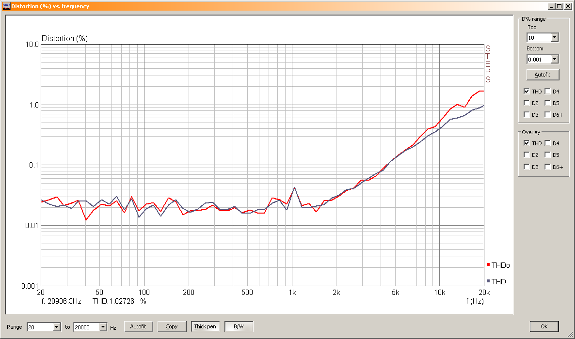

THD seems to be mostly unaffected. Above 5kHz it starts to increase a little less steep with the zobel (gray trace).
a ltspice power loss simulation will confirm this.

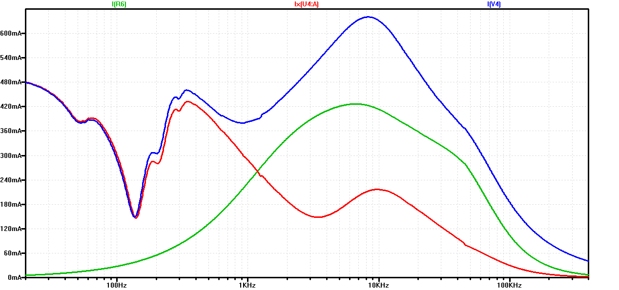

Sure, there's some current going through the zobel resistor, but how much high frequency energy is there in actual music? The switching frequency is of no concern, and a quick test (about two minutes) with a 7kHz sine wave at ear splitting volumes (1.5VRMS at the speaker) just barely got that resistor warmed up slightly. The resistor won't burn up from an idling amp and it probably won't burst in flames during normal listening.
attachment.php
Blue = total current
Red = speaker current
Green = zobel current

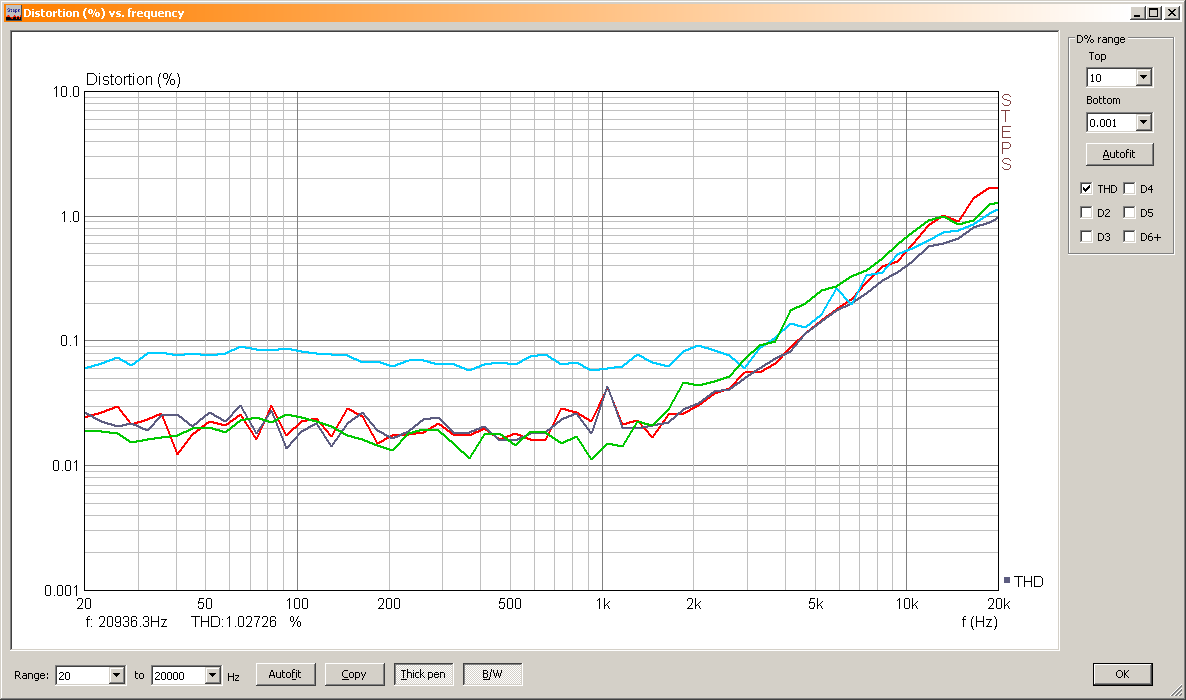

Joined 2008

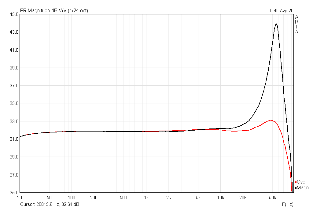

The THD actually got worse after my modifications :eek:. It's more like 0.07% now (blue trace) instead of 0.02% like before. Reducing the gain to the minimum of 20dB helped to counter this, but with a slight penalty above 1kHz still remaining (green trace).
attachment.php
I'm not sure what exactly causes this, but it's probably the output capacitors. For one they're now actually 1uF and not changing capacitance with voltage like the ceramics did, but being polyester types they surely have a somewhat higher ESR. Does that make any difference? :confused:
attachment.php
That's where the peak is supposed to show with 1uF caps: closer to 60kHz than 90kHz (colors swapped this time; peak without the zobel).
