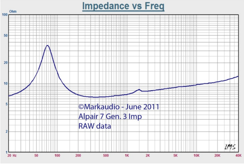

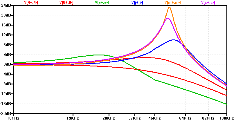

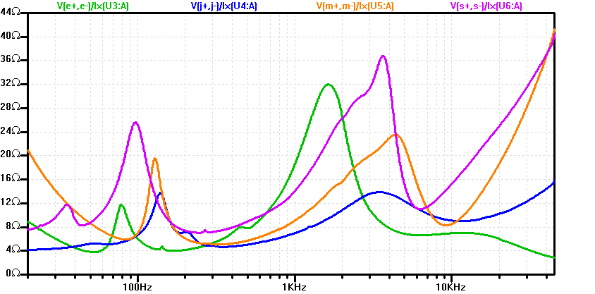

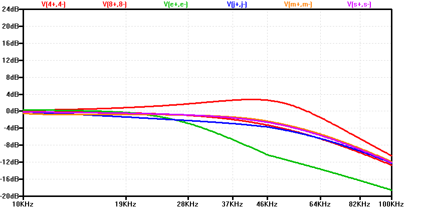

I do not doubt these calculations give optimal filters theoretically.
One assumption of these calculations is the speaker having constant impedance over the hole frequency band. This may not be true at higher frequencies, specially when using single wideband speakers. And it is certainly not true at the resonant frequency of the filter, so some snubbering for damping could be essential.
All in all I want to say that the TI application might be a 4~8 Ohm compromise, but it is not that bad in practical terms.
I don't disagree that a speaker can be a more complex load than a resistor, and can affect the filter's performance... knowing that information you can design a better filter I'd imagine. The code I threw together to do this can handle complex load impedance, got any candidate speaker electrical models I can experiment with to see how much the variation ends up being?

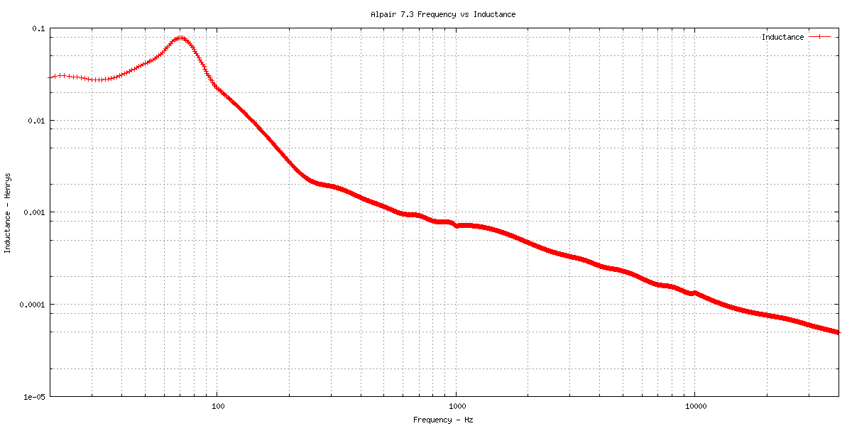

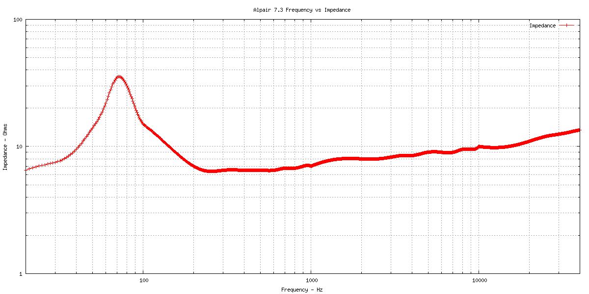

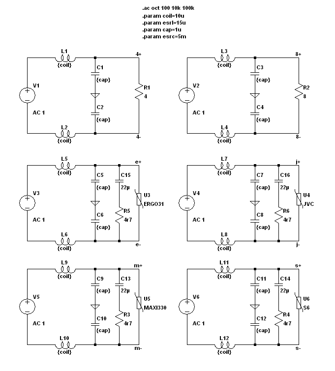

... got any candidate speaker electrical models I can experiment with to see how much the variation ends up being?
Sure. How about this speaker?
http://www.creativesound.ca/pdf/A10AP.pdf
Actually, what about two of those speakers, in parallel?
How much is a Butter worth?
post yer model schematics, parasitics , and any other assumptions used.
I couldn't find hardly any info on the inductors DS, losses vs Freq or SRF.
any consideration on 3rd order elliptical w/1st stop band notch at Fsample

Not sure if this is in any way meaningful or useful to anyone... but it was fun to play with the code and generate some graphs.
This is all for the Mark Audio Alpair 7.3, which is what I'm using on my desktop. Here's a link to the datasheet. Here's the parameters for convenience, along with the published freqency versus impedance graph.

So I created two graphs myself: one is a re-creation of the frequency versus impedance graph. This was done by the method I suggested above: picking points off the published graph, then using a canned interpolation function to fill in the blanks.
Next step was to use gmarsh's formula for le, calculating it for every f and Z point from the interpolated freq vs impedance data.
Some cheap eBay TPA3118 amp boards just sparked my interest in Class D. While I'm still waiting for the modules to arrive, I read up some threads here on modding them, especially regarding the output filter. Being a fan of LTSpice, I fired up the simulator and played a bit with different coil/cap-values for different output impedances.
The configuration on the boards seems to be 10uH and 1uF ceramic in a common-mode configuration (parallel bridge, PBTL). Those values simulate well with a resistive 4R load, and some slight 3dB peaking around 40kHz with a resistive 8R load. They're the two red traces in the graph below.
I wanted to know what the response would look like with a more realistic speaker load though, so I found a way to model my speakers in LTSpice. Since I have multiple different speakers around, I measured them all up and threw them in the sim. Here's the result:
The speaker with the overall lowest impedance (green trace) should work just fine, while all the other speakers with somewhat higher impedances show some heavy peaking, up to almost 24dB!
I second that. This is what I figured out to be pretty effecive (in simulation, at least!), before I stumbled upon this thread.
This is what the results look like with an added zobel of 22uF and 4R7 (same scale for easy comparison):
Now the three speakers that showed the highest peaking almost exactly line up with the resistive 4R graph. The green graph looks almost a little overcompensated already, but the response at 20kHz is not much different from the others. The cutoff frequency is a little lower though and thus should lead to a somewhat higher attenuation of the switching frequency (which is a good thing, so another plus for the zobel).
Anybody tried this in the real world? I've never seen a schematic with a zobel capacitor in the tens of microfarads yet, only things below half a microfarad. They're just not that effective in the simulator...
Here's the simulated circuit:
The different impedance plots of my speakers:
And finally the simulation file for your own experiments.
One big conclusion I'm drawing from this: USE A ZOBEL.
