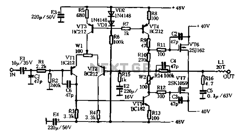

I was even thinking to the schematic i am attaching
IIRC Nelson Pass was once asked to share a design for a good sounding class AB. His response was simply "I don't know how."

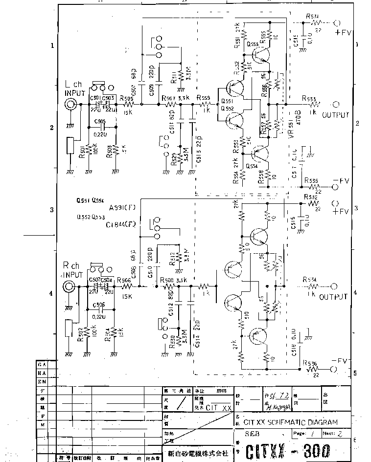

Hi ! if you are referring to me i am attaching the service manual i found on the web. I hope i do not violate any law ... 😱
Schematic is on page 6

You were right: no capacitor parallel to the feedback resistor!
But there is always stray capacitance, its value depeding on lots of things like length alongside other tracks, route and vias. Let's say only 10pF, then the rolloff starts around 2MHz.
To late of being usefull advice, you had better increased the value of 475E (R611-612) to 1k00 instead of decreasing R635-636, lifting this rolloff to an even higher frequency.
But, way more defining is the 33k2-330p RC load of the voltage amp, yielding in a rolloff of 30kHz! Being within the loopgain, estimated at 26000x or 88dB, havoc can still occur with a closed loop gain of only 18.5x or 25dB.
Other measures in the circuits are the low rolloff (475E-100u) at 3Hz and the input HF just under 1MHz.
Another unusal suspect is the feedback taken from the right side of the fuse, which I consider as the wrong side. If the fuse is blown or not present, the output is driven to maximum values due to the added feedback resistor of 33k2 (R633-634). Any signal present, even a small amount of (hf-) noise can cause the amp to clip from rail to rail.
You can notice that the headphone output is already dampened with 330E resistors, so what was your aim to use the loudspeaker outputs (apart from the reduced gain issue)?

You were right: no capacitor parallel to the feedback resistor! But there is always stray capacitance, its value depeding on lots of things like length alongside other tracks, route and vias. Let's say only 10pF, then the rolloff starts around 2MHz.
Thank you so much for you very kind and extremely precious advice. Never to late at all ... 930ax are all over the market. Actually i think i still have the remains of mine somewhere ... i could try to restore it 🙄
If i understand well you mean that replacing R611 with a 1 kohm resistor the amp will be stable anyway ? this is very important to me.
I need to study this more ... i am shocked about the fuse issue ... how they can not think about that ... 🙁

Hi just a comment ... when low wattage is enough i would expect something like the attached schematic ...
From what i understand an amp with a really great midrange
Ok a too basic schematic to be really exciting 😱
Fwiw the amp should be the Aura VA50
Moreover i am pretty sure that the 1st part of the schema (i.e. without the output stage) could be an excellent line stage ...
Impressive +/-48V rails
just a feeling of course

Hi thank you very much indeed for the valuable advice.
Just to be sure ... is it the one attached ?
I have a question ... reducing the bias has a really big impact on the sound ?
It is the only thing that i do not like much ... high bias
Are you aware of kit/pcb for diyers ?
