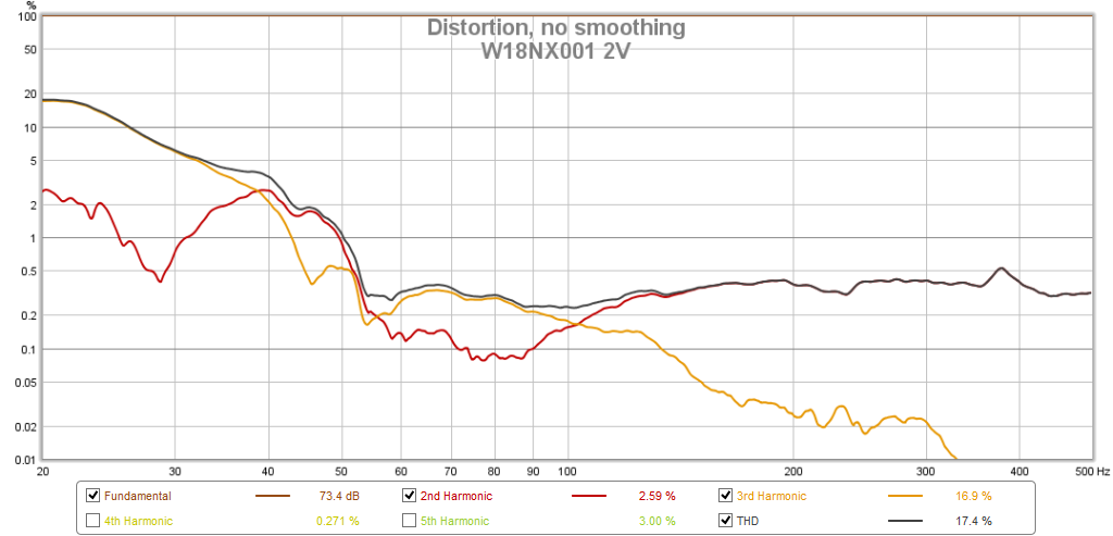

How do you correlate when acoustic output distortion is 55dB (562x) higher than the amp output voltage distortion if you make no measurement? You want to ignore the Elephant in the room? Good Luck but be prepared for a Frustrating and Long adventure. :D

That is doable. But the problem to what we listen is in the acoustic well before that target.... How do you correlate when acoustic output distortion is 55dB (562x) higher than the amp output voltage distortion if you make no measurement ?

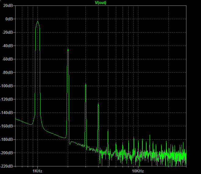

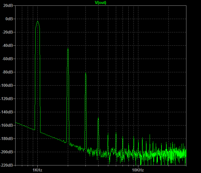

Pass H2 circuit is an excellent starting point, then other options can be explored. Attached are LTspice prediction of distortion spectra of original Pass H2 and a 6SN7 preamp tweaked to produce very close THD at 1V output.
