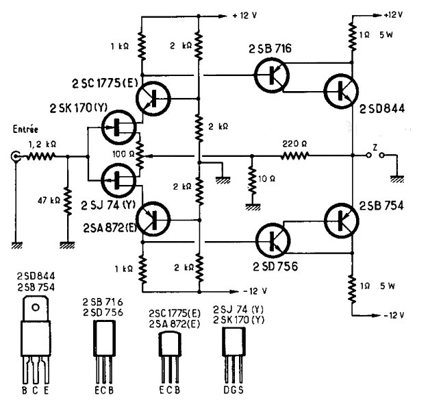

My design in progress.... I would love to see power amps that act only as a current gain stages with different currents of course (i.e. high current buffers)...
Hi ! i am not an expert but yes something like this. 🙂😉
A buffer should have from little to no effect on the sound with the VAS setting the sound. 🙄
In the example i have attached i see something looking like a diamond buffer at the output. The diamond buffer is a very elegant schematic with no feedback
Usually is for line stage applications ... nevertheless i guess it can be built with much more powerful parts.
Can it be conceptually the best possible buffer ? 🙄
I would be extremely interested in knowing this ... how good of a design is a diamond buffer
We are DIY, we only do bests. 🙂
Best fidelity, best imaging, best measurement, best in simplicity, best efficiency, best price and other bests, take your pick. There is no need to consider the second best.
A buffer is not a voltage amplifier, it's a current amplifier.
For the benefit of well sounding buffer amplifiers, the voltage amplification has to be realised by another stage or circuit.
Does the buffer sound nice? Maybe it's the voltage amplifier in front of doing the nice things. The diamond is symmetrical; I do not know people who can distinguish buffer amplifiers sonically from each other. Most say they can as long as they know another 'thing' is used. Double blind tests leaves all guru's in the dark.

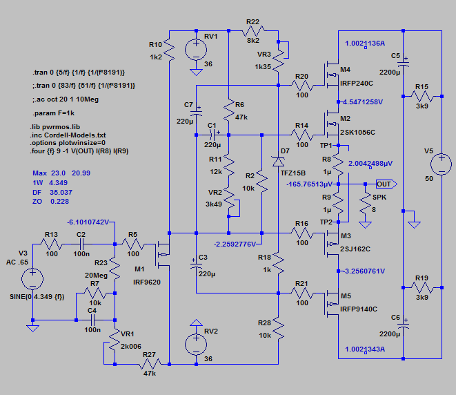

The Hiraga posted by you is the 'larger' amp, 15W or so. The other is just 8W.
...The diamond buffer is a very elegant schematic with no feedback ....
It has 100% feedback in every stage.
Right so! It has 100% local feedback.It has 100% feedback in every stage.
This kind of feedback is mostly harmless, it's another thing when overal feedback over three stages has to correct all diverging effects, not to mention phase shifts in the hf-bands.

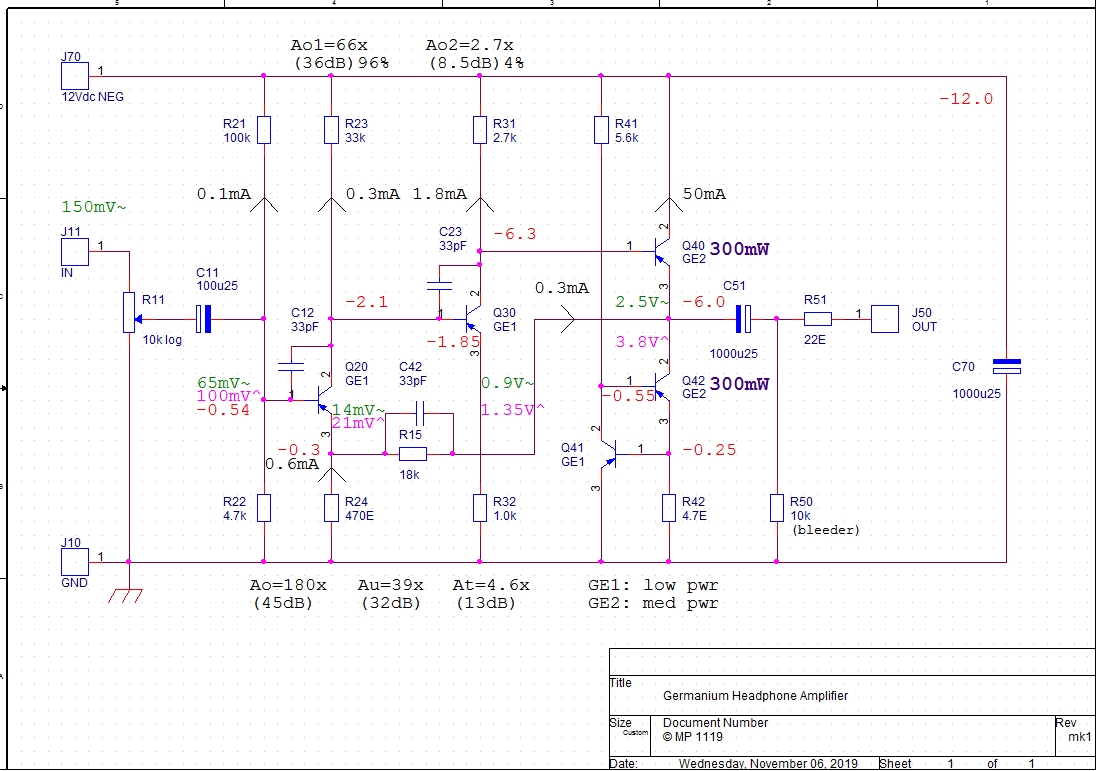

Designing are at least three things at the same time. Make a dc-stable design, make an ac flat design, balance the act of feedback (overall vs local) and have it a precise or pleasent sound. That's four balls in the air.
In another topic (Germanium audio preamplifier) a challenge was to adopt an existing design to germanium bjt's. Because only pnp's were allowed, I contemplated another approach from scratch.
Not to intent crossposting, but as an example what's involved in the designproces.
One can observe dc-settings, ac-values and peak-figures. Also, losts of estimations are still open for adjustments (millercaps) or reconfigurations.
Being it the first shot, I'm not happy with the balance of inputsensivety, amplifications and powersupply-dissipation-output.
That will take some iterations ('redesigns') to get it closer to the target.

Hence all these values in my design in post 107. Local feedback with emitterresistors and millercapacitors and an overall feedback for ac response and dc stability.

Now I know (again) why I have to iterate several times a first shot from scratch.
Balance of amplification per stage (less on primer TCA, more on the VAS... sorry TIA) and raising openloopgain by cap-bypassing the local feedback resistor of the TIA to appropiate levels.
