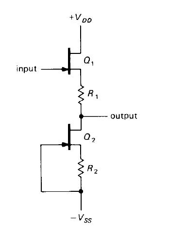

Patrick,
Could you comment on the attached drawing. It's an excerpt from "The Art Of Electronics" Horowitz and Hill. 2nd Edition. Pg 135
It talks about a source follower with source resistors R1=R2. Which guarantees Vo = Vi , if Q1 = Q2. This circuit has greater linearity when operated below IDSS. Compared to a circuit without source resistors.
Thanks,
Leo

See post#1, Borbely's article Fig.15.
This is the circuit everyone knows, everyone uses in one form or another (Curl Follower, Pass B1, and my original DAO Follower, ....).
There are many detailed descriptions of this circuit on the inet. Please refer to the original B1 thread from Nelson.
http://www.diyaudio.com/forums/pass-labs/124889-b1-buffer-preamp-2.html#post1547019
http://www.analogzone.com/col_01302004.pdf
The purpose of my article was to show something different, and hopefully also somewhat better.
Patrick

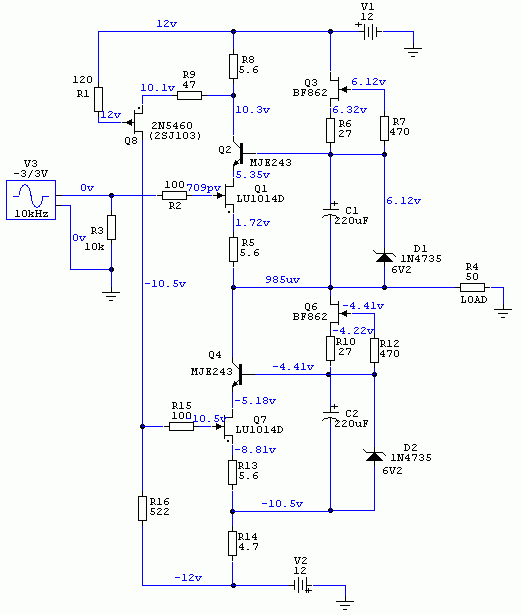

Patrick, what do you think of lowering Pd by lowering supply voltage ?
+/-24V is too inefficient for just 2 or 3 volts of output signal. Cascoding MOSFETs won't feel well with lower Vds, so I thought to use BJTs instead (they don't mind). Cascoding devices don't have noticeable sound impact anyway, and with +/-12V we could keep original Id and still have half of Pd.
> Is there a PCB for us DIY newbies? Are there any parts that are hard to source?
Simple answer is no & no. There is a layout published that you can copy, or you just hard wire P2P, which is easy enough.
If you argue that you only need 2V swing, then you hardly need more than 30mA current, which means that 200mA bias is a hell of a lot. I would still stick to 16V rail and 200mA bias, as I always want some voltage headroom. But by all means try it and let us know.

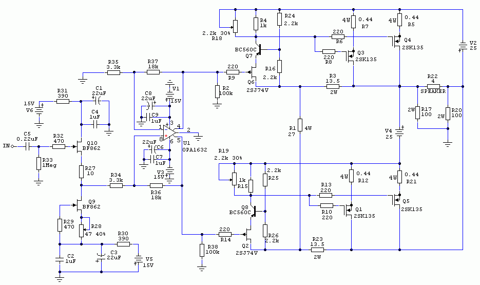

Since this is single ended class A headamp I'd like some current headroom too - you are right about current for 50 Ohms headphones, but 16 Ohms devices are getting more and more popular.
That will be my next project, right now I'm busy with this circlotron (you'll remember the idea from F5 thread), and I have 1 channel working nicely:
