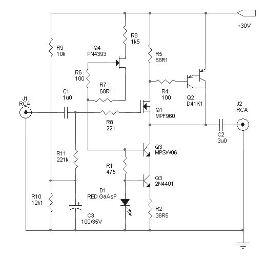

Another Source follower type - I'm currently using this in my test preamp ( just back from Burning Amp) as a unity gain line amp. A discrete Darlington with some nice modern bipolars would probably do better than than integrated one I used, though the GE D40K/D41KDarlington series was pretty fast in its day. I have a partially stuffed board in the basement (waiting for some more attention) to see if that is true. The TO-202 packaged Darlington with its long tab made it possible to run it without using a heat sink. The MPF960 uses a TO-92L package, so it is possible to run it with a good deal of bias current without a sink as well.

Someone asked about modifications to the DAO follower as built by Steen.
This is the version with the Taylor Current Source.
The 2SJ103 should have about 8mA Idss.
Depending on JFET Vgs variations, the resistor values might need adjusting. I should start with a 1k trimpot for R1 to set DC offset to zero first.
Hope you'll build this. Total dissipation about 15W.
Patrick
