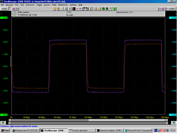

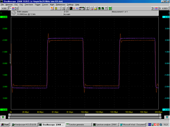

I hate to do this, but I am doing this for the other guys, not you.
As in ZV9, the DAO circuit I published has a cascode MOSFET, the gate of which is tied to a voltage reference (in case of the DAO the Zener diode and a cap in parallel). The other end of the Zener diode is tied not to the source of the LU1014, but to the lower end of the source resistor (ca. 3 ohm in the DAO). Thus,
Vds of LU1014 = V zener - Vgs(cascode) - I x Rsource ................(Ohm's Law)
Suppose you have a load of 20R (Grado), and you apply a signal of 1V pk-pk (sine). This means output power
p = V^2 / (2 * R phone) = 25mW so not excessive.
The peak output current i = 1V / 20 ohm = 50mA.
Thus the voltage drop at the source resistor (3R) will increase by 50mA * 3R = 0.15V.
The Vgs of the cascode MOSFET will also increase due to the increase in current, by an amount of
vgs cascode = 1/Yfs * 50mA = 80mV.
Thus, vds of LU1014 will decrease by 230mV. This vds drop is output current (hence signal) dependent.
It is precisely this decrease of vgs that causes the triode effect (the linear portion of the curve I published in post #26).
Of course this is not the whole story, as we have only been discussing quasi-static effects so far.
If you use the DAO with a 200R load (e.g. Sennheisser), you will see some overshoot when applying a 10kHz square wave. Where as if you reduce the load to 66R (e.g. AKG), the square wave is just about perfect. So it is not for no reason I keep saying that the published DAO is optimised for the AK701 / 702.
Which one sounds better ? That depends on the headphone (how much HF roll off it has). Can this dynamic behaviour be changed ? You bet.
A simple, naive looking circuit is much more complicated to design that it looks on the surface.
But no magic, just science intelligently applied. 😉
Good day,
Patrick
(Magenta is input, red is output. Left is RL 200R, right is RL 66R.)

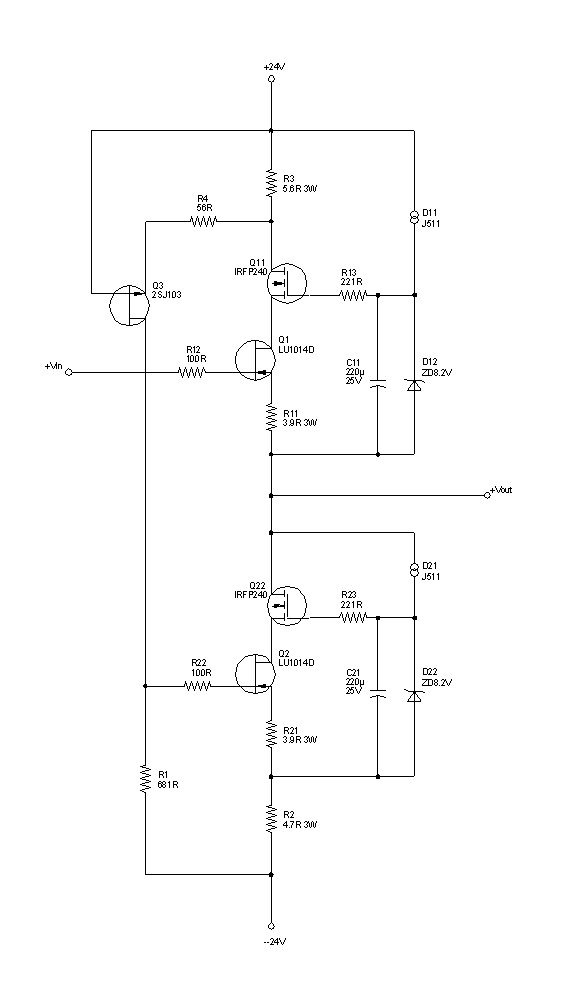

Hi Patrick
Thanks for the food for thought!
Just to make sure we're all on the same page, I've attached a circuit (copied from one of your earlier attachments).
As I understand it, the linearization mechanism you described above would apply even for a fairly simple follower e.g. just the Q1+Q11 part of the circuit, with a simple current source at the bottom.
Looking at the bigger picture, I see the same arguments applying to the linearity of the active source made of Q2+Q22.
One question, though - Doesn't Q3's non-linearity throw a spanner in the works, or is it relatively insignificant?
(Sorry if it's a dumb question, but I'm a total noob regarding fets😱)
Regards - Godfrey
You posted the one with the Taylor current source.
I was talking about the original circuit posted in Grey Rollins thread.
Yes.
In the TCS circuit, yes. Absolutely.
Very good question. It does.
So in theory it is better to use a high gain device there, such as 2SA970, as in the original circuit of the TCS in tubecad.com.
This would minimise the effect of Q3.
However, I had the 2SJ103 lying around, and I actually tried it. I ended up getting a good working point, where I traded a bit of 2nd harmonics for reduced high order (3rd, 4th, 5th, ...). So I did not bother to try PNP afterwards. And I would suspect that a PNP will get me more high order harmonics.
But feel free to experiment and report back.
Patrick

1. The schematic I am following is the one Godfrey posted above, which shows R2 at 4.7R and R3 at 5.6R, whereas the board Patrick posted in #47 has them at the same value. Did I miss something in the discussion above? Am I using the latest version of the schematic?
2. If I lower rail voltages to +/-16V or so (higher would be OK if the heatsinks can take it), should any of the component values be altered?
My guess is no, as long as I don't mind the bias current dropping, but I presume I could also raise that again by lowering R11 and R21?
3. I can't seem to get my hands on 2SJ103. I have 2N5460 on hand, and getting 2SA970 (which were mentioned just above) should be no problem, so I could substitute one of these for Q3. What changes in component values would be needed, and which would be a better option? (I can see about getting other substitutes also, if anyone has a better suggestion.)
4. Up above, Patrick suggested using a jfet with gate and source tied together in place of J511. This seems pretty straightforward, but does it make no difference whether it's a N- or P-jfet? I presume N- would go in the other way round from P-?
Thanks for any help.
Cheers
Nigel
1. I do not consider 3x12R // to be same as 3x15R //, but use the values in post #128.
2. No, and bias will not change practically, but you lose head room. So no 200R phones.
3. If you want to use 2SA970, you will need to change all values around the Taylor Current Source. See Tudecad.com for details (if you know what you are doing). Otherwise I suggest you build the simple DAO first and mod to TCS later when you can get the 2SJ103. Or ask Steenoe if he has some left.
4. N is easier to get than P and has less capacitance. You can also use a resistor that will give you about 4mA to the Zener.
Patrick
