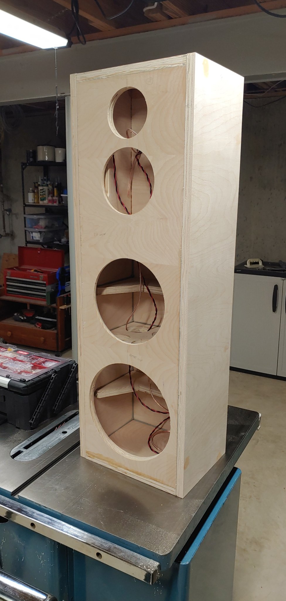

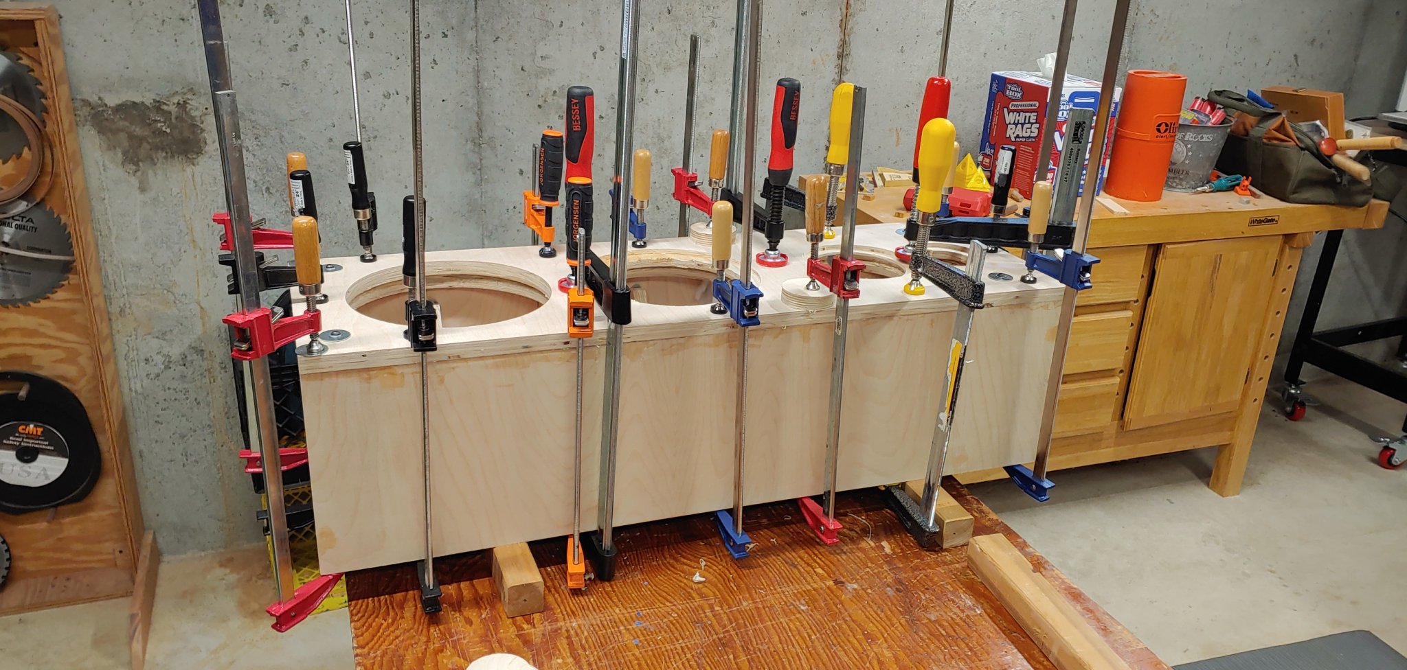

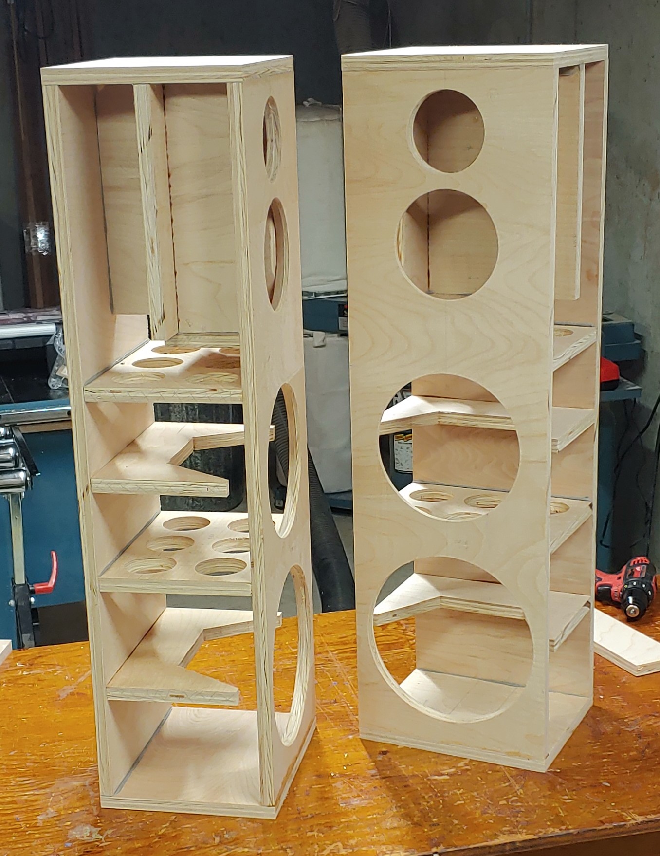

The inner carcass is glued up. Side panels next, then outer baffle.

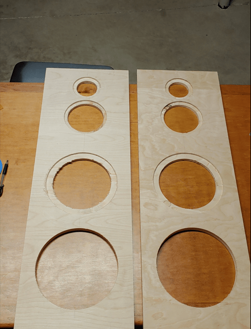

I have not been happy with any dust collection device attached to a hand-held router. I have a compulsive need to watch bits/blades as they cut through wood. I don't like anything blocking the view. This means dust collection of hand-held routers is problematic for me
I decided to get one of the same jigs as I needed to make some larger circle cuts that the Jasper jig allowed. Do you find that the scale doesn't seem quite right? With my Dewalt and vacuum attached there is almost no dust that gets out, a single pass in the opposite direction gets it all. Maybe too late after you bought a new router.

Yes, the scale is off by about 2 mm. I have rarely found the built-in scales on tools to be accurate. I draw my circles with a compass and fine line pencil, then position the bit onto the line.

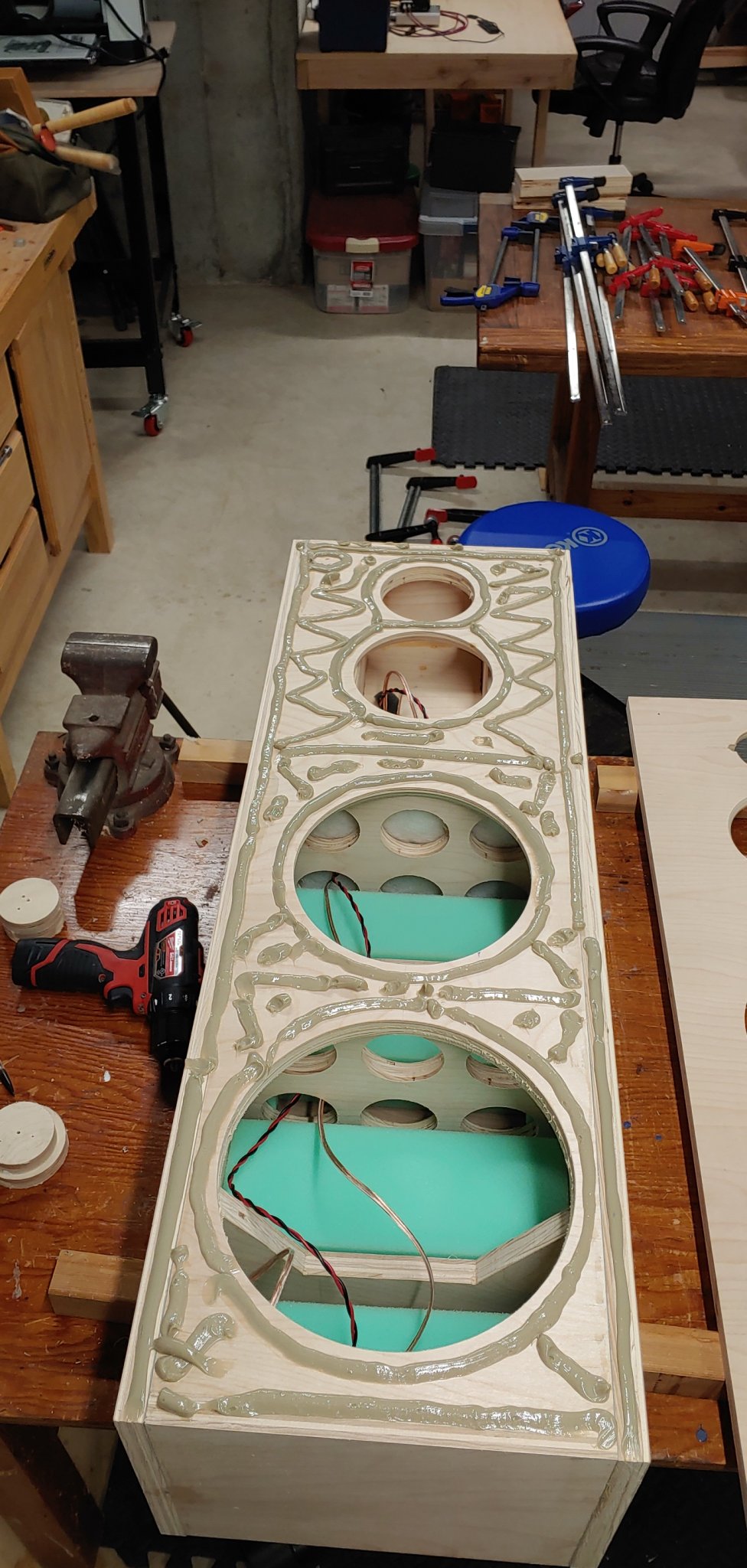

What is the greyish glue visible on some of the joints?
It is construction adhesive. When joints are tight fitting, I use titebond wood glue. Titebond is an excellent glue, it is strong, easy to clean up with water, safe for skin contact, and inexpensive. However, it requires a tight fitting joint. At the start of the assembly process, I use titebond exclusively. However, as more pieces/sections come together, there are gaps due to tolerance buildup. One option would be to trim down the proud areas (high spots) with a sander. I choose a different option, I use a gap-filling construction adhesive.
Reactions: zman01
More construction photos. I am applying the outer baffle using construction adhesive. Here I use a slightly different product, Loctite PL3X. This is a tan colored adhesive, and it is less dense and lower viscosity than the gray-colored PL-Max. I found it flows better under pressure than does the PL-Max, so it is not necessary to spread it (using a serrated trowel for instance).
During clamping, I like to see a lot of squeezed-out adhesive along every edge, and inside the driver holes. Construction adhesive is easy to clean off with a putty knife before it has cured. If we allow the squeeze out to cure hard, it becomes a difficult sanding job to get it smooth.

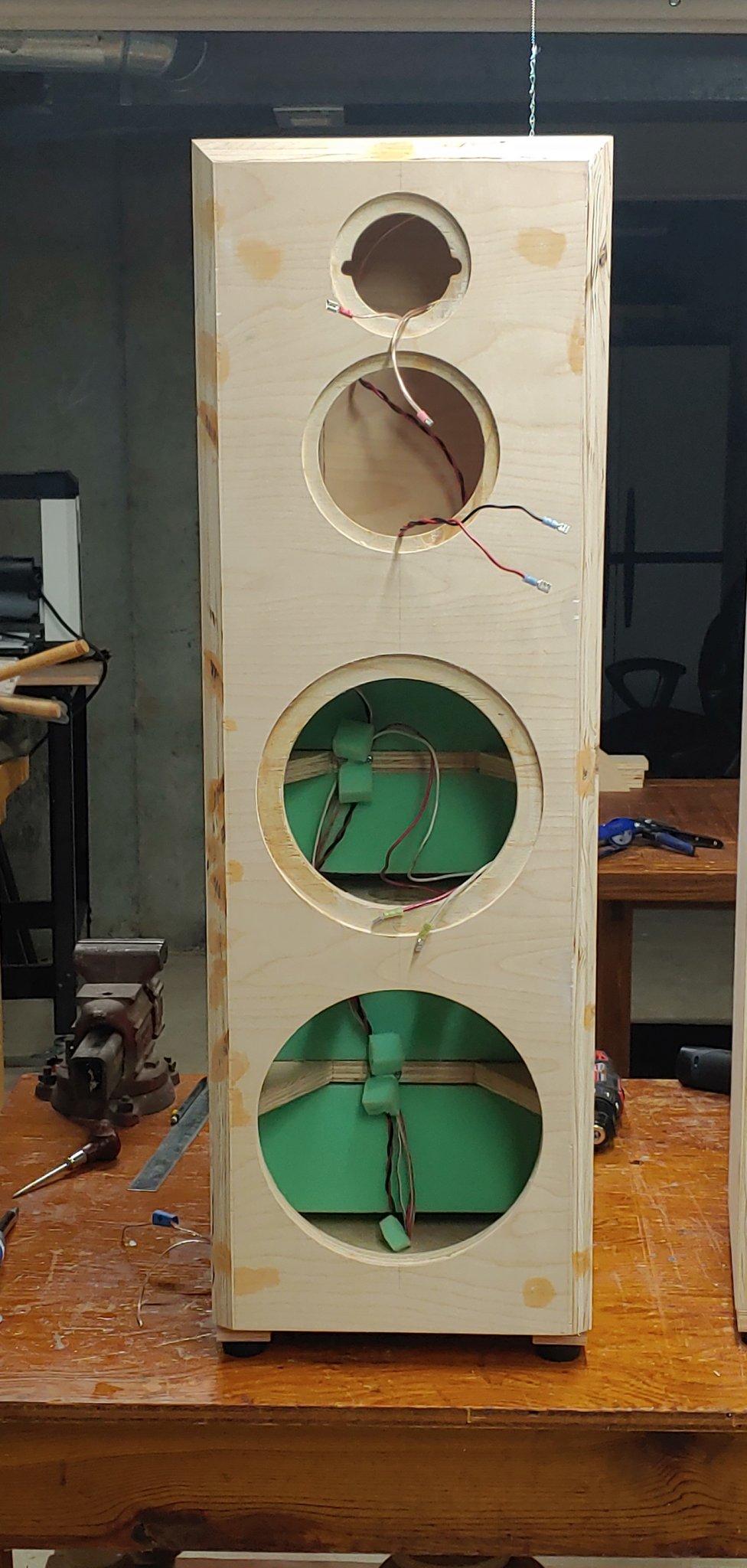

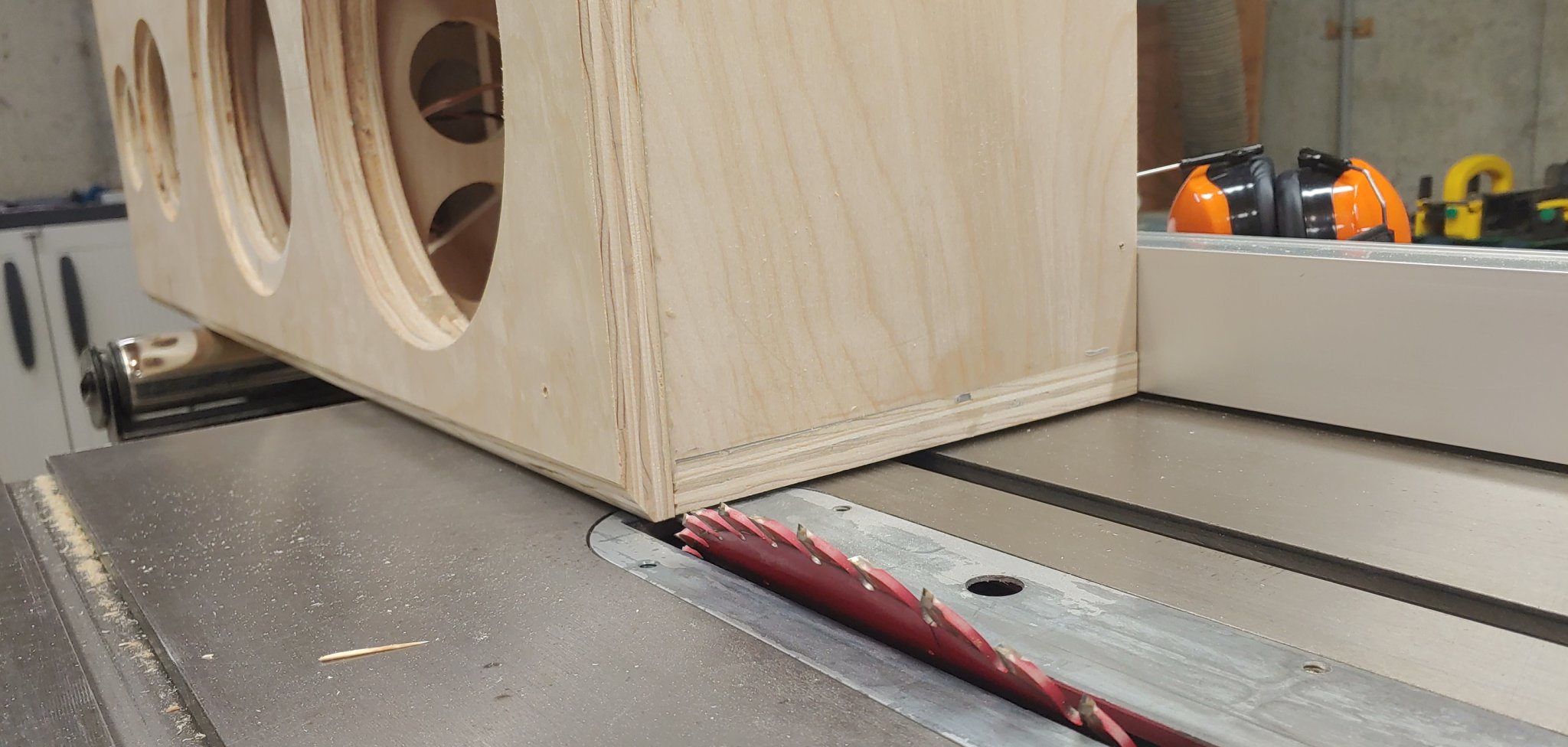

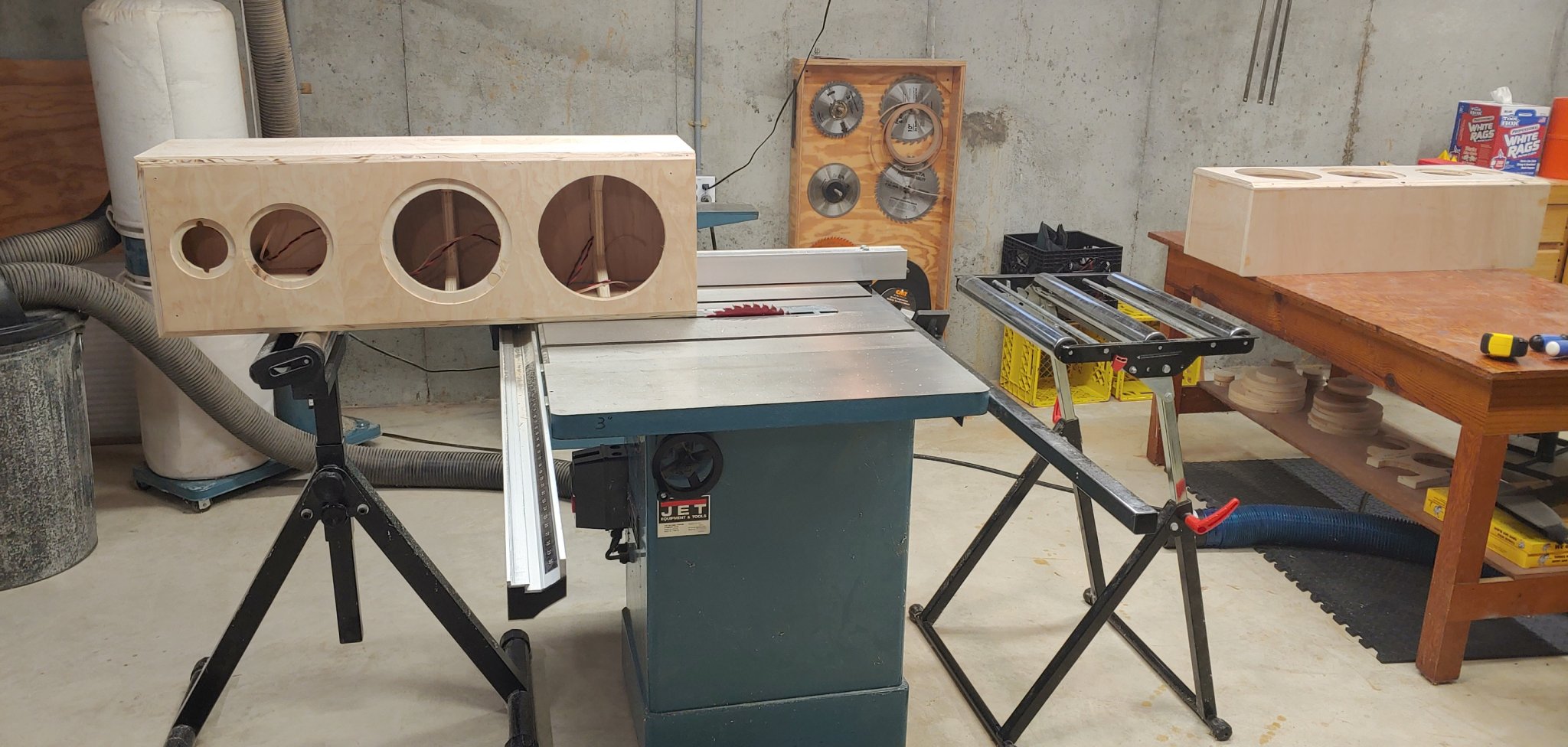

Here I am cutting the bevels:
These are straight (non-tapered) bevels. They are considerable easier to cut than the tapered bevels I have use on several recent projects. I use a table saw to cut these, but a router with a 45 or 30 degree bit would do the job well. I cut the bevels with a 35 degree angle relative to the baffle. Any angle from 30 to 45 degrees would create the reduced diffraction edge we are looking for.
Because the bevels are non-tapered, the back of the cabinet is placed against the fence. In the above photo, I have made the first cuts to a depth of about 15 mm. Now I am preparing for the final cut to the target width of 20 mm.
I did not hit the target bevel width of 20 mm (as viewed from the front). My final cut was 19 mm, and I judged this to be good enough. I did not want to risk another push through the saw to attempt to trim 1 mm.
I have the wiring for the drivers installed, and routed through a 3/8" hole in the bottom. I need access to all 6 wires to do measurements and crossover development. The finished speaker will sit on a plinth, or small elevated base, and the passive crossover will be housed within the plinth. For now, I have installed temporary feet.

I haven't used a polyurethane glue on a speaker cabinet before. I'm curious if you use the Loctite PL3X rather than regular wood glue to achieve some degree of constrained layer damping for the front baffle?
I have mainly used Goop or E6000 for gap filling when I can't properly clamp a joint. These adhesives are amazingly strong when fully cured (though this is not always a good thing when you're taking the cabinet apart again). Maybe the construction adhesive is less messy?
I am not expecting any structural damping from the adhesive, such as constrained layer damping. My reasons for using a gap-filling construction adhesive to glue the outer baffle are all about tolerance build up and gaps (see post #288). PVA wood glue, such as Titebond, needs a tight fitting joint, generally with a gap of 0.5mm or less. My maximum gap when gluing up the outer baffle was about 1.5 mm.
There are 5 glue surfaces which fit to the outer baffle: inner baffle, top edge, bottom edge, L side edge, R side edge. In traditional wood working, we try to design joints so that there are no more than two glue surfaces in a joint clamping operation. That works fine for tables, face-framed cabinets, benches, etc... but it is just not possible with a speaker cabinet. I could have spent an hour with a belt sander to flush everything up, but I have learned that a gap filling adhesive is so much easier, and there seems to be no downside at all. In fact, trimming edges with a sander or router can leave the cabinet un-square, since the panels themselves were all cut orthogonal.
I have no experience with E6000 adhesive. Based on what I have read, it does not cure to a hard solid, but more to a rubber-like solid... yes?
I admit I have not done any experimentation to find the best adhesive. Several years ago I was using West System epoxy thickened with microfibers and colloidal silica when I needed gap filling capability. That was fairly inconvenient and messy. Someone on this forum suggested construction adhesive, and I tried it and found it to be very well suited. Since it works well, I have not bothered to try other adhesives.

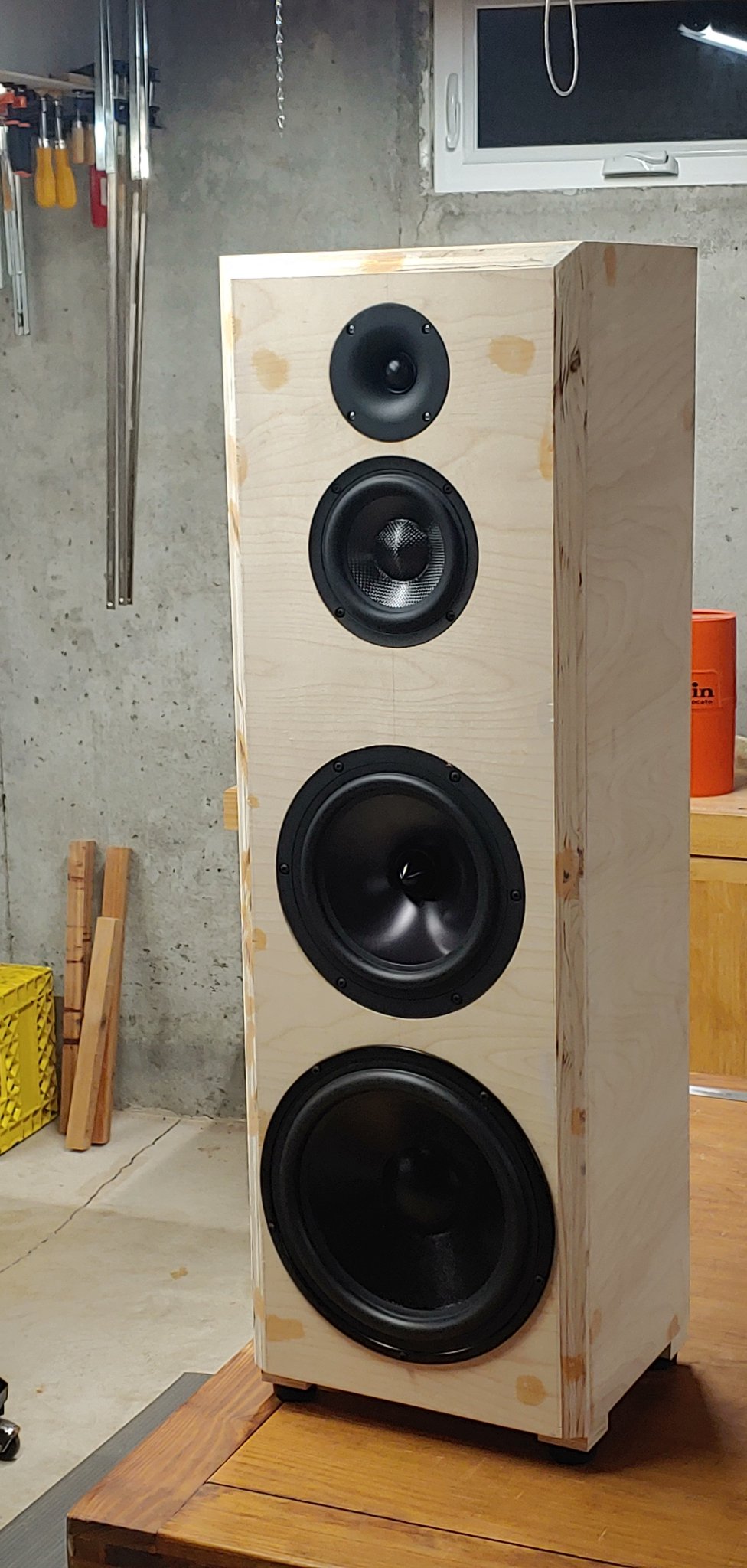

In other news, the drivers are installed, and nearfield testing is underway...
