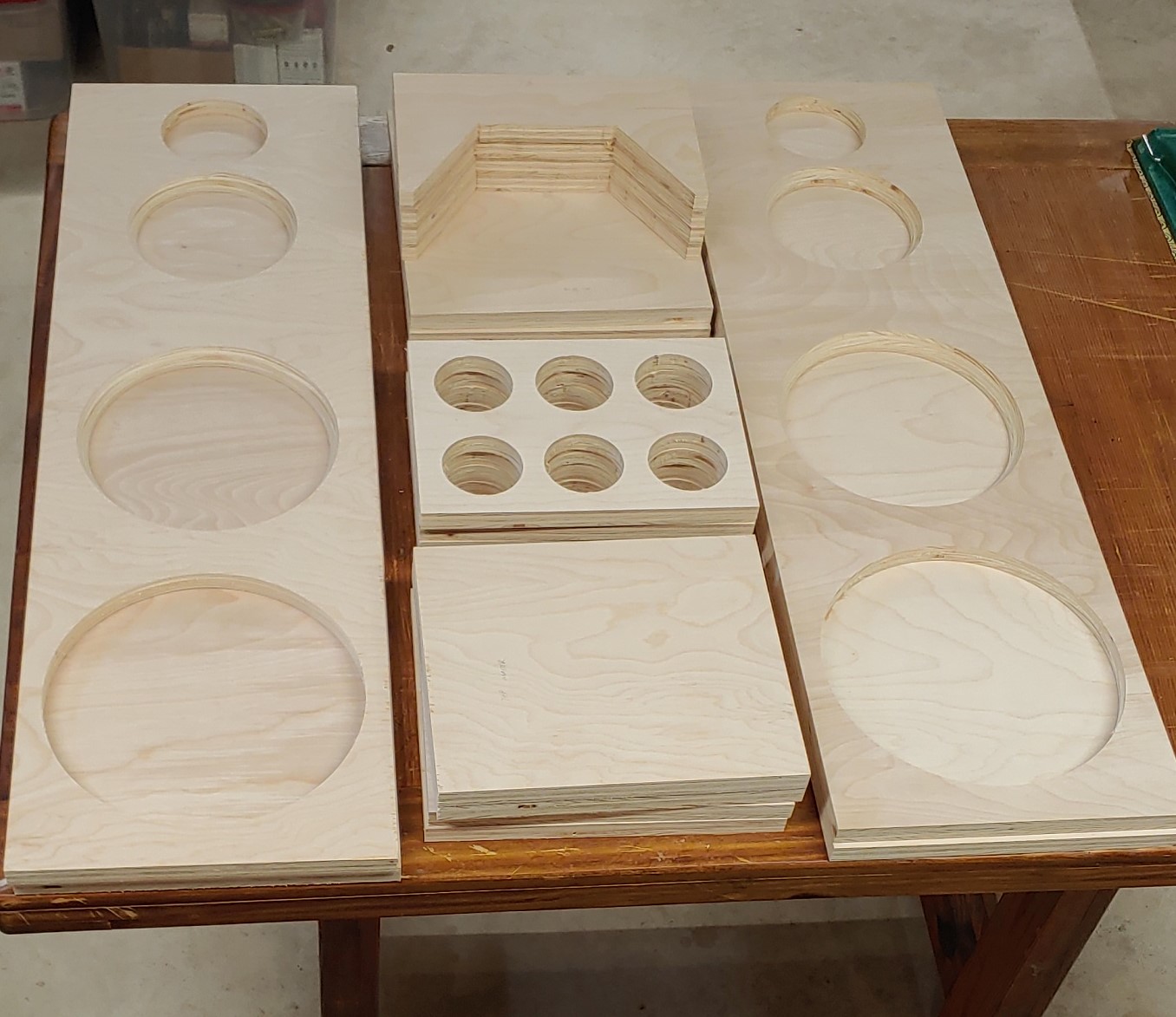

Routing holes is the least enjoyable aspect of the speaker design/construction/testing process. This design has two full bulkhead braces above and below the woofer, and each brace has 6 holes. I don't do large-scale routing like this in my shop because of the vast amount of dust. I set up a work table outside. I notice some folks on this forum send their baffle designs to a CNC machine shop, and I wonder if that is the smarter move ... Someday I may reach that point. 🙁

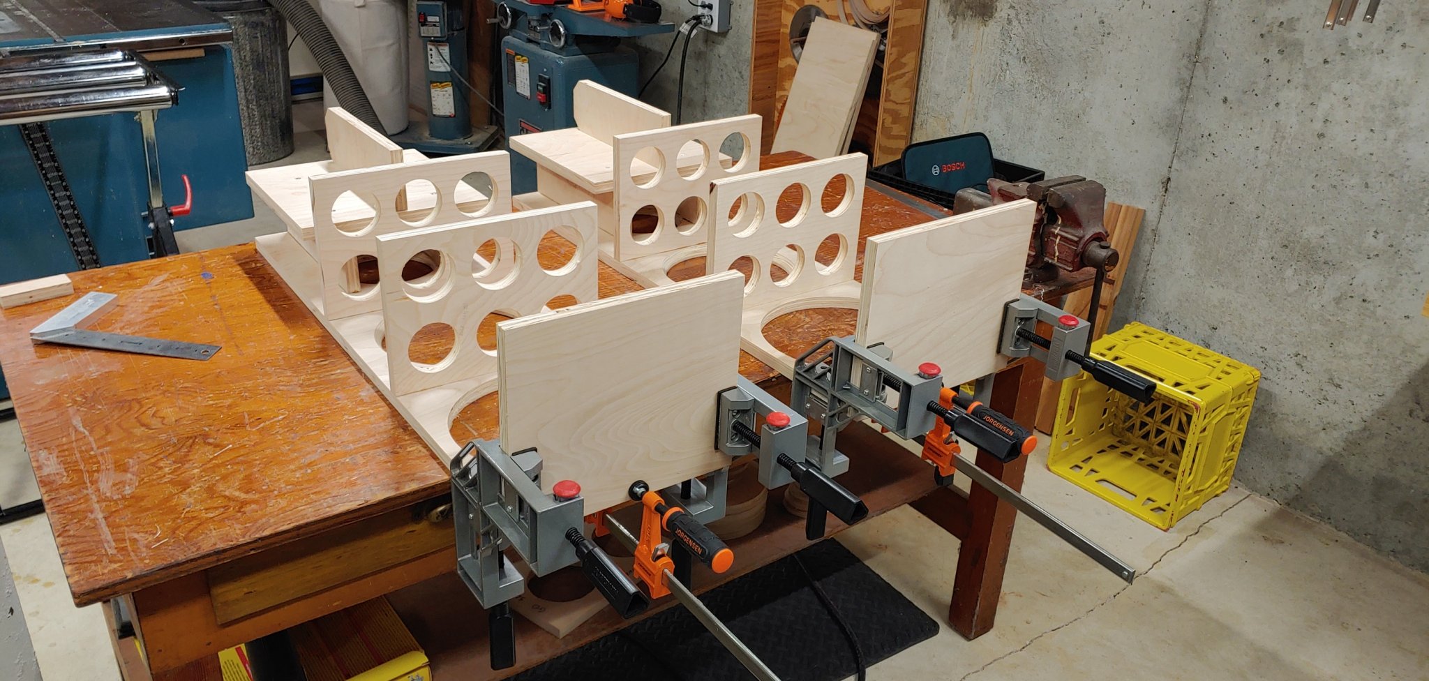

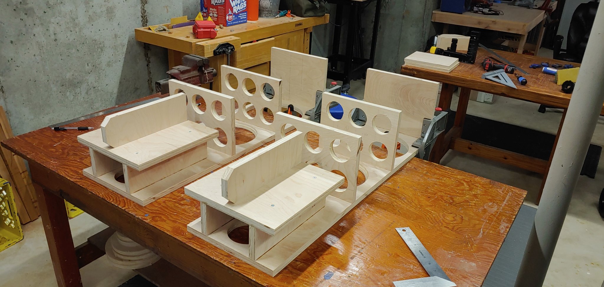

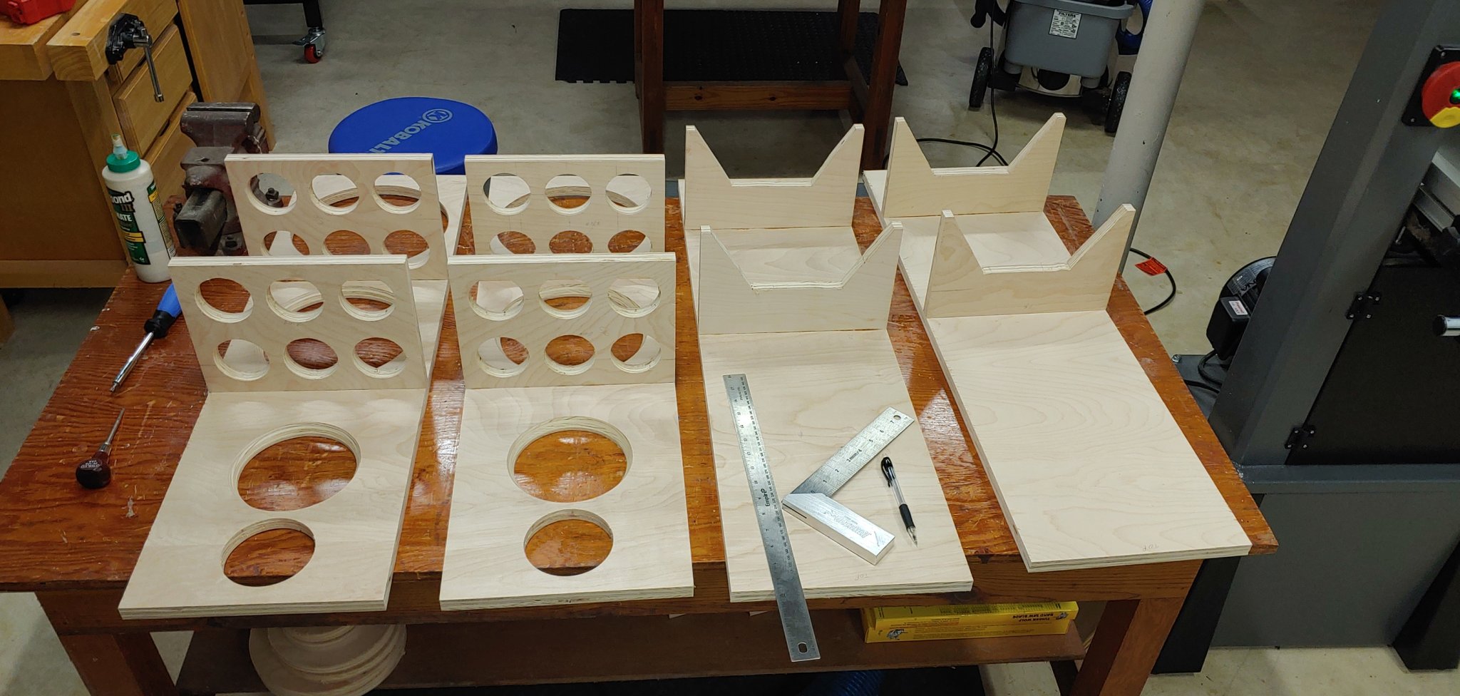

In other news, I have the panels for the inner carcass cut and machined, so I am ready to start gluing up. In the photo I have the inner baffle, rear, top/bottom, and the primary bulkhead bracing. Later I will cut the sides and outer baffle.
