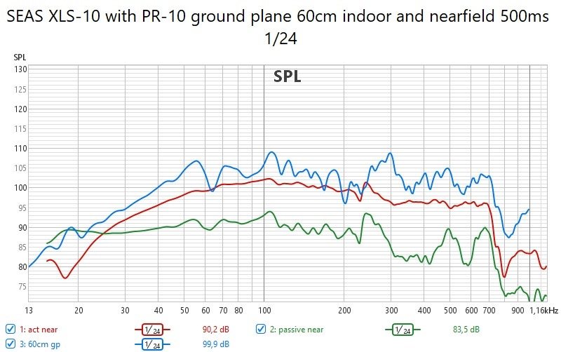

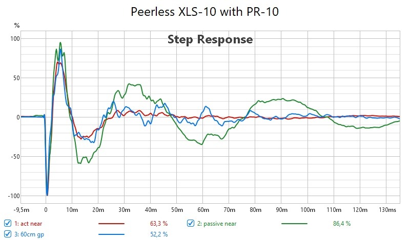

My opinion is that resonator systems of any kind are bad. But I understand their effect (net benefit) is ok with passive 3-way woofers and subwoofers. PRs have more radiating area but are bad with high excursion, it is a good rule to use double number of passives to active(s). Location of the port or radiator should be on the backside or downside towards floor.
My simple measurements above have only anecdotal value, but give reason for further studies.
There is something 'in-between' a passive woofer and a passive radiator >About passive woofers as reflex resonators... I can't remember seeing nearfield measurements, only simulations that miss all resonances and "midrange leakage".
It is difficult for me to accept that they would be problem-free
I happen to have a 10" sub with a passive radiator of same size with added mass. Both have pulp cone, Peerless XLS10. I have nearfield measurements below, not pretty at all... Measured indoors, so gp includes room effects. No xo or eq used. Added mass was per construction plans, obviously way too much...
It is raining today, so away with added mass and new measurements!
It is what I call an "Actively Assisted Rear Radiator". ( a form of bass reflex )
