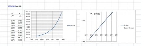

Here is where the trouble starts. When you apply 0.1 volts more across an LED, the current changes by much more than it does for a resistor, because of the exponential characteristic of the LED. Small voltage changes cause large current increases. That's the nature of semiconductor diodes.
Look back at the data JhStewart9 posted for the red LED (RG71230). His data shows LED current is 0.460 mA when 1.578 volts is applied across the diode. If that is increased to 1.675 volts - which is an increase of almost exactly 0.1 volts - the LED current now rises to 9.6 mA.
Let's think about this. We've increased the voltage across the LED by 0.1 volts, and the LED current increased to almost 20 times bigger than before! It increased by nearly 2000 percent - 1987% to be exact!
In other words, the poor 12AX7 is going to try to increase its cathode current to 20 times bigger than before. This won't happen, of course; instead, anode voltage will drop to the point where the triode saturates because there isn't enough voltage between anode and cathode for it to work properly. Current won't increase 20-fold, but it will increase sufficiently to badly screw up operation of the circuit. The triode isn't able to amplify at all now - it's just sitting there, deep into saturation, with the anode at as low a voltage as it can manage to reach (probably around 100 volts DC, very roughly).
So: the simple 1.5k resistor caused a manageable 7% change in the tube operating point. The fancy red LED, on the other hand, royally screwed everything up, tried to increase triode current by nearly 2000%, and ended up making the amplifier stop working altogether. Not good!
What would cause the voltage across the LED to rise from 1.578V to 1.675V?
I think the answer is more current pulled through the LED.
However, a 12AX7 is simply not going to draw 9.6mA of Ip.

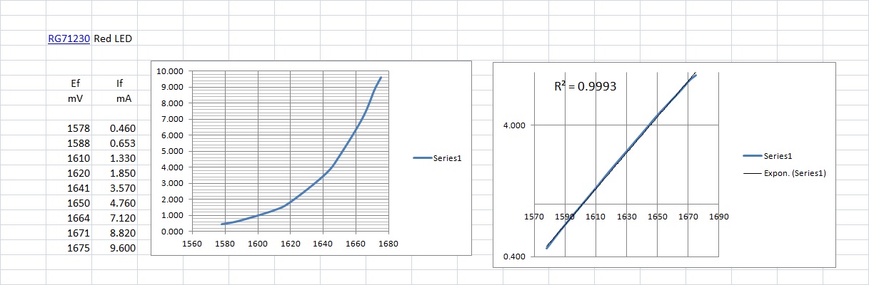

shouldn't it be exponential ...
but if you terminate the Taylor series after the 2nd order term you end up with a square law of course ...
Here it is with the Exponential Trend Line. The fit is still very good.
The change in voltage comes from tube aging or rolling in a different tube. So diodes aren't too good for bias stability.
People talk on & on about the linearity of this or that boutique resister & than stuff in a non-linear device.
The tube current is roughly square law versus grid-k voltage (varying from exponential at low current up to linear at high current, like a Mosfet ) before plate N Fdbk is considered. The 3/2 law at the plate or screen grid approx. matches that 4/2 at the grid, for the Fdbk. to give an approx. linear Mu factor. (the mis-match causing the "roll-over" effect in the triode curves) So putting in a square law diode would just adjust the Mu downward (for a triode), or if slightly mis-matched from the tube characteristic, could be used to adjust the total linearity ( with a load on the plate say ). Seems like that would be a lot of work going thru umpteen diodes to get the right result, especially for an input stage where the signal is small.

The other way around. There is manufacturing variability between 12AX7s, as well as tube aging. If you want the same 1 mA of cathode current from any good 12AX7 you plug in, [i ]different tubes will want different Vgk. [/i]
Similarly, as a tube ages, if you want the cathode current to stay the same, it will want different Vgk.
A cathode resistor adjusts to this situation. If its value is properly chosen, it can adjust to small changes in tube parameters. By allowing a small change in current through it, it can adjust Vgk to whatever the tube needs (Ohm's law). As we've seen, a hypothetical 0.1 volt change in Vgk results in about a 7% variation in Ia, which is manageable.
The trouble with an LED is that an LED provides "one size fits all" Vgk (equal to VLED). This results in cathode current varying much more due to inevitable tube aging and parameter spreads.
Of course not; I said as much. The point is that with LED cathode bias, normal slight variations in Vgk result in far more drastic variations in cathode current (compared to using a simple cathode resistor of the right value).
In other words, using LED bias reduces operating point stability, as I said in my first post on the subject.

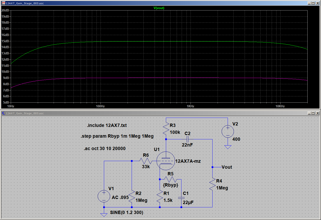

The attached image is an LTSpice sim using 1.5k/22 uF. As you can see, this provides flat response far below the lowest audible frequency (-3dB at about 12 Hz).
Note that input AC voltage is 95mV in this simulation, so the 15 dB flat top of the frequency response curve is not voltage gain. I chose that particular input voltage to set output at precisely 15 dB, so you can easily see where the curve drops below its flat-top value, and by how many decibels.

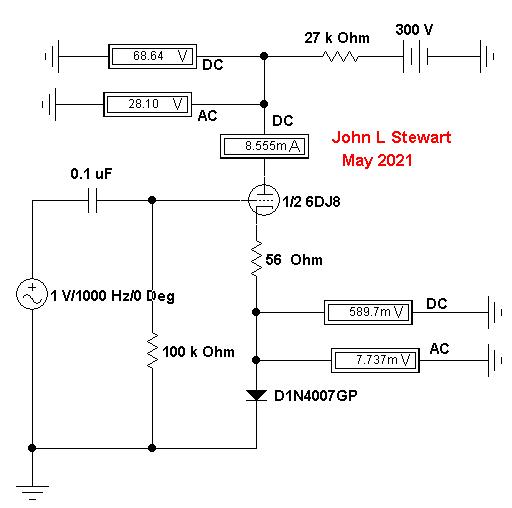

I'm reluctantly responding because I don't really want an arguement 😉. But LED biasing is essentially equivalent to fixed biasing, and in fact for that purpose the less variation in LED voltage with current the better. The tube is the device determining the current, not the LED. If you swap in different tubes you will get different currents due to tube-to-tube variability - different Ia at the same Vg, and you have no control over that (contrary to actual fixed biasing where you can adjust the voltage). The main reason people use it is to maximise gain while avoiding a bypass capacitor, so any suggestions of alternatives that require a bypass capacitor are pointless. In practise it works reasonably well unless you are relying on achieving a particular Va (i.e. for DC coupled designs). I have used them, sometimes also in conjunction with a small series resistor to provide some degeneration, but have no particular bias for against them.Just another tool in the toolbox.
A simple diode biased voltage amp. In this simulation the diode manages to add
~0.7% distortion to the signal applied between grid & cathode.
Something to run on the bench to get real numbers.

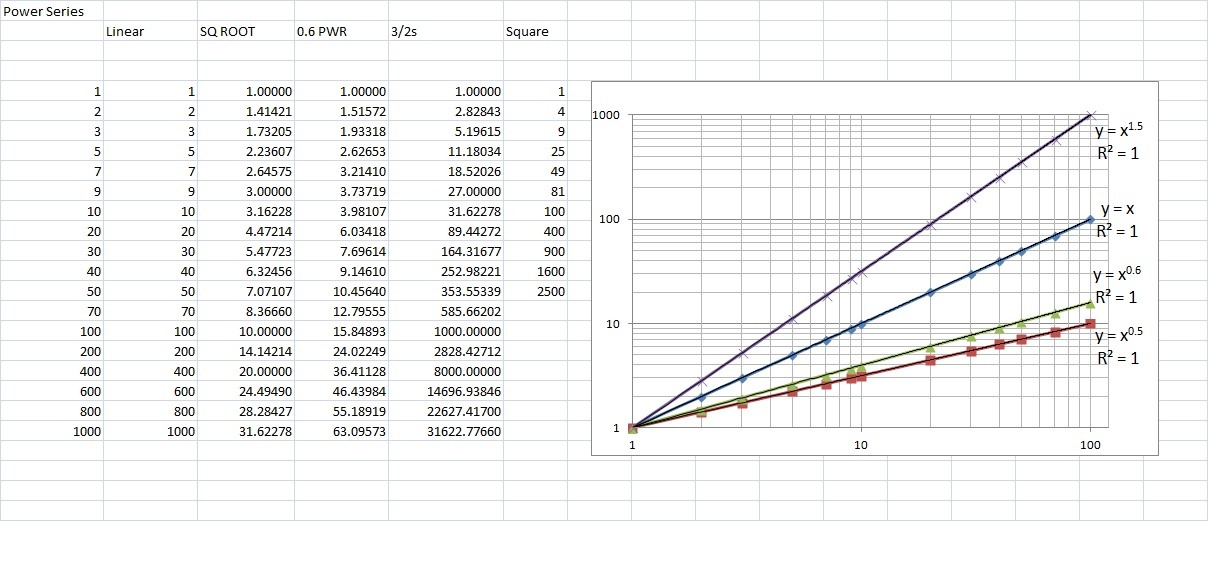

On a log-log plot some common functions become a straight line.
For example, an ideal triode forms a line with slope 3/2 while a resister has a slope of one.
Still need to put a slope of two on this for an ideal SS diode at low current tho.

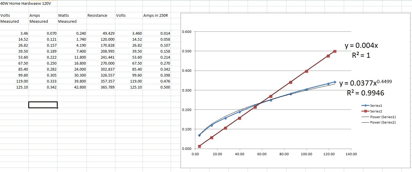

Tungsten based incandescent lamps have a slope of less than one.
That is what stabilizes Wm Hewlett's version of the Wien Bridge Oscillator.
